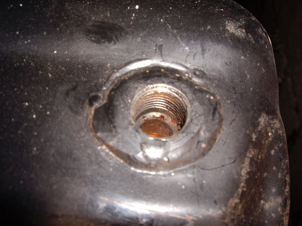

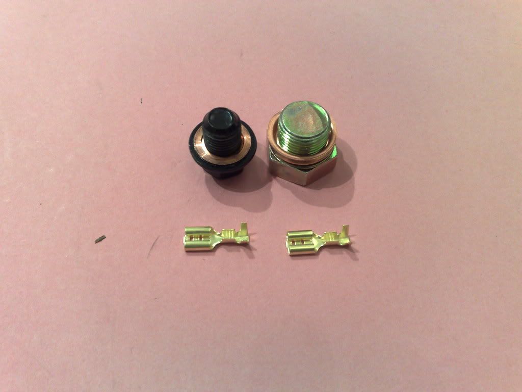

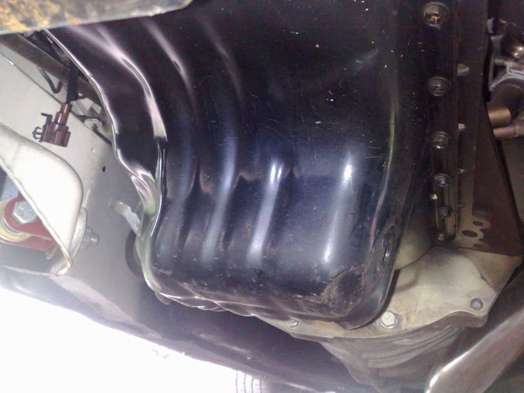

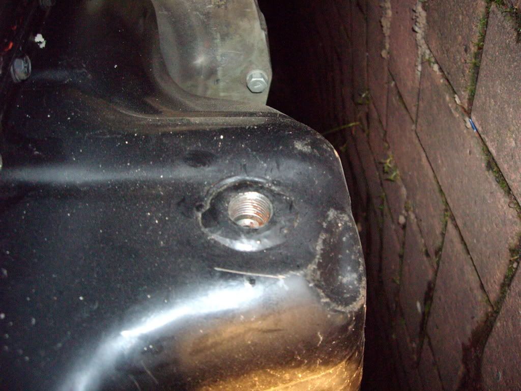

Bishopsrock Posted April 28, 2008 Author Share Posted April 28, 2008 Thanks Careless but I have just pulled a plug from the Micra engine on your list and it is still the wrong size plug. Looks like it will fit and even starts to turn but after a quarter of a turn it begins to tighten up and then very quickly locks solid. Below is a pick of the two new off the shelf plugs that I have also tried. I put two brass connectors next to them to give an idea of size. The larger one is the same as the Micra Engine plug that I pulled today. Below is a picture of the outside of the sump - just in case anyone recognizes it? Finally here below are two pics of the threaded section. You can see below that there is a narrowing of the hole to form a seat against which I suppose the shaft of the plug should connect? This really is less simple than it appears! Careless - thanks for all your help to date - any new ideas? The last thing I want to have to do is rip the sump off - but its not looking good is it? Thanks Quote Link to comment Share on other sites More sharing options...
Canadianz Posted April 29, 2008 Share Posted April 29, 2008 Hmmmm, this is interesting. On my sump which is the rb20det pan on a rb25det, the hole you are trying to plug is plugged from the factory on mine. Its threaded and everything and even looks like it needs something, however I noticed the "side plug" your worried about after I filled mine with oil and it defiantly does not leak. So on the off chance that yours is actually plugged already, stick a screw driver in there and see what happens or put a bit of engine oil in just to see. I don't want to be the guy who states the obvious, this was just the case that I had, so maybe your fixing something that is fixed from the factory. Cheers Chris Quote Link to comment Share on other sites More sharing options...
jtmny1999 Posted April 29, 2008 Share Posted April 29, 2008 Hmmmm, this is interesting. On my sump which is the rb20det pan on a rb25det, the hole you are trying to plug is plugged from the factory on mine. Its threaded and everything and even looks like it needs something, however I noticed the "side plug" your worried about after I filled mine with oil and it defiantly does not leak. So on the off chance that yours is actually plugged already, stick a screw driver in there and see what happens or put a bit of engine oil in just to see. I don't want to be the guy who states the obvious, this was just the case that I had, so maybe your fixing something that is fixed from the factory. Cheers Chris Yup that hole is pluged in my pan also. If its a new pan you prob just have to leave it alone. -JT Quote Link to comment Share on other sites More sharing options...
stony Posted April 29, 2008 Share Posted April 29, 2008 Have you put oil in the engine???? Does it leak out of there???? I looked at my pan and there is some kind of sensor in it. when i removed it way back when it had 1 wire coming out of the middle of it and i just cut it off. i say put oil in it and start it... pics coming soon Quote Link to comment Share on other sites More sharing options...
stony Posted April 29, 2008 Share Posted April 29, 2008 Well photo bucket is down and i cant upload pics to hybridz for some reason... I looked in the rb20 skyline FSM and it doesn't show it on the oil pan... my guess it may be a z31 thing and it look like either a low oil idiot sensor or a oil temp sensor. Either way it sits in a cup that is sealed and it doesn't look like it needs to be there in my pan. As in it wont leak oil if its not there. Quote Link to comment Share on other sites More sharing options...
stony Posted April 29, 2008 Share Posted April 29, 2008 here ya go video is better plug in pan I say start it if you have oil in it :> Quote Link to comment Share on other sites More sharing options...
fentin_fury Posted April 29, 2008 Share Posted April 29, 2008 I have the same bung in my pan - it is plugged and doesn't leak. I assumed it was for a temperature sensor - as Stony has showed. Q Quote Link to comment Share on other sites More sharing options...
Bishopsrock Posted April 29, 2008 Author Share Posted April 29, 2008 I stuck a screwdriver in it and had a good probe. The inside looks black as though its the inside of the sump but the probe stops against hard metal which suggests that it is sealed/welded on the inside. Sooo I filled it up and guess what - no oil leak! I can't believe it - its like a Japenese comedian fitted a fake plug body to the sump for a laugh. Its not even as though its a bad fake - it looks the genuine item - just like a sump plug should fit in it and exactly like oil would pour out of it if you tried to fill the engine. I feel well sheepish about this now though!!! Hopefully this thread will be of help to anyone else having the same confusion and also to those people looking for a sump plug part number. Thanks to everyone for helping me sort this out. Quote Link to comment Share on other sites More sharing options...
