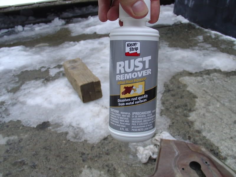

I use this.
You can get it from walmart at the auto section. Make sure you get the one with the grey lable and not the black label. The black one is suppose to be paint, but it just sucks to work with.
THe stuff is just phosphoric acid (its in cola) and you just have to brush it on , wait and wipe and rinse.
I use it for spots that I don't want to grind.
an example on my busted bumper that I scrapped.
