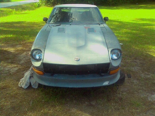

Gritz Posted October 15, 2008 Author Share Posted October 15, 2008 I'm thinking about going bold with my rim selction...a all black wheel...Im just not sure if these would look good on a pepper gun metal car color....Black rims with red strip, painted red brake calibers or gun metal color brake calibers...hummmmm what do you guys think...whos good at photo shop? Quote Link to comment Share on other sites More sharing options...
240zwannabe Posted October 15, 2008 Share Posted October 15, 2008 Gritz said: I'm thinking about going bold with my rim selction...a all black wheel...Im just not sure if these would look good on a pepper gun metal car color....Black rims with red strip, painted red brake calibers or gun metal color brake calibers...hummmmm what do you guys think...whos good at photo shop? i'm no good with photoshop but i too have a wild style. black wheels are becoming more and more common, i always try to think ahead of the latest trend and do something really outrageous for the time. volk makes crazy colored wheels, you might want to check those out. Quote Link to comment Share on other sites More sharing options...

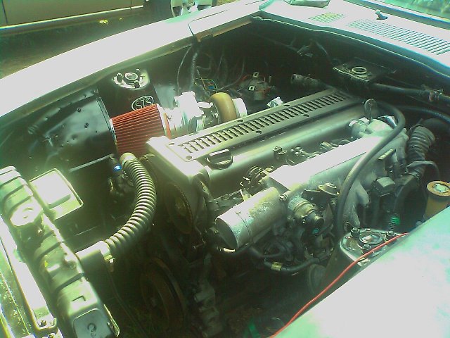

Overkill Z Posted October 15, 2008 Share Posted October 15, 2008 Gritz said: Thanks!! Im aiming for about 350-400whp So nothing to crazy.. So far the engine looks pretty good, although it did arrive with a broken tps housing..know where i can buy one? The oil looks very clean, spark plugs look pretty good, but i can tell it was running a little rich..Most of the sensors look brand new, coil packs the same...The harness look kinda ragged, but it is complete and uncut...The ECU looks fine, but i have not had a chance to open it up..The twins all spin freely with only minimum shaft play...This 1jz seems to be a second gen version because of the way the vent on the valve cover is designed, so it is a newer 1jz so thats all good.... Will prolly try to pull my l26 this weekend, and paint the engine bay... I'm now trying to decide should i just pony up the money and buy the mounts i need of just make custom...I stared this project with the idea that i could do this swap for cheap..my budget was $3500-$4000 including the price of the car!!!! Now i know some of you may think that I'm crazy...but i am on my way...so far i have paid $600 for the car, and $2000 for the engine set..total of $2600 so that leaves me $1400 to get the 1jz in the car running good!!! Of course that is if everything goes as plan which rarely happens.. I believe in build to what the car is for...So i wont be spending money on fancy this and fancy that...I will imitate or maybe better stock design..for example a good piece of fuel line works fine as fuel line, don't need steal braided fuel line..lol...If i was building a track car then it would be diffrent...just clean stock form factor... GO to betamotorsports.com and talk to john... he has a wonderful crossmemeber he hand makes for s30s to fit in 2jz/1jz motors. I just got mine and installed it SOOOOOO worth the 200bucks. Quote Link to comment Share on other sites More sharing options...

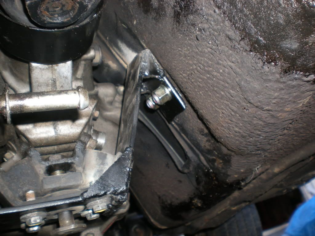

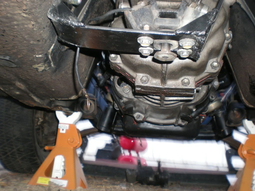

Gritz Posted October 15, 2008 Author Share Posted October 15, 2008 Well Tranny crossmemeber is done...i think it looks good.....will it hold 400hp+?....well just have to see won't we.. Quote Link to comment Share on other sites More sharing options...

jtmny1999 Posted October 15, 2008 Share Posted October 15, 2008 Gritz said: Well Tranny crossmemeber is done...i think it looks good.....will it hold 400hp+?....well just have to see won't we.. I did my tranny mount just like that, but then I realized I have no exhaust clearance. I'm thinking or redoing..... Looking good! Quote Link to comment Share on other sites More sharing options...
Gritz Posted October 15, 2008 Author Share Posted October 15, 2008 jtmny1999 said: I did my tranny mount just like that, but then I realized I have no exhaust clearance. I'm thinking or redoing..... Looking good! Hummmm, theres not to many ways you can do the tranny mount...i'll have to tackle that when i get to exhaust .....I do plan on lowering the car 1 1/2 to 2in so that could be a problem... Quote Link to comment Share on other sites More sharing options...

timbo1jz Posted October 16, 2008 Share Posted October 16, 2008 Very good job Gritz! Its coming together nice and quick too. Yah, I had the same problem with the tranny crossmember getting in the way of the exhaust, so I made I new one kinda like the one that RUSS made. Mine is not the prettiest thing but it is strong, braced and works. It gives pleny of room for exhaust. Quote Link to comment Share on other sites More sharing options...

Gritz Posted October 16, 2008 Author Share Posted October 16, 2008 timbo1jz said: Very good job Gritz! Its coming together nice and quick too. Yah, I had the same problem with the tranny crossmember getting in the way of the exhaust, so I made I new one kinda like the one that RUSS made. Mine is not the prettiest thing but it is strong, braced and works. It gives pleny of room for exhaust. Hummm i see....this could be a problem...when i get to exhaust i'll see what i can come up with.. thanks for the pic:icon14: Quote Link to comment Share on other sites More sharing options...
