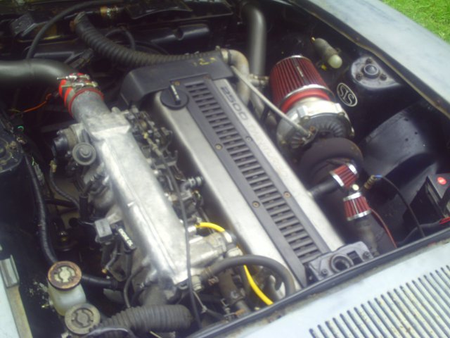

Gritz Posted May 23, 2010 Author Share Posted May 23, 2010 Wow! this car is insanely fast, so far so good. Engine runs like a champ, no vibration in the body so the mount is holding well. I have a couple of issues, i need a oil restrict in the turbo feed line, My car seems to be getting hot after about 30mins-hour of driving the temp goes to about 210 degrees and gets cooler at idle?? I'm not sure what thermostat i have?? I think it's because the Intercooler is mounted right in front of the rad. I'm using the stock rad. so might be time for a new aluminum RAD. I'm going to flush my system and if that doesn't work then I'm getting a new rad. Did i say how fast this car is? Bark tires in 4th! Thats with the stock 14's though I do have a little lag that I'm not use to; i barley have any boost in first gear, but second is a different story. The 62-1 i have has a 68 a/r hot side that i thought would be pretty quick spooling.. possible Reasons for slower spooling are tuning, ebay crap turbo, or loose wastegate spring...etc Over the past year, i have changed front and rear shocks and springs with tokico blues, which is the reason my car sits a little low in the front(pic soon)changed to poly bushings, installed front toyota 4 piston upgrade, new ball joints, new tie rod ends,new u joints all the way around. The car rides pretty good very tight steering, tight acceleration, trans is smooth. The 1jzgte has a awesome exhaust note, hitting boost revving out to 7k is amazing; 1jz is one of the best sounding engine ever made bar none. I still have to close in my rear hatch area where the fuel cell is, it's wide open right now :)My rear drums are frozen right now, my dad and i where able to unfreeze one, now tomorrow i will work on the other. My wide band is acting up, it reads 15.5 at idle, cruising and under hard acceleration?? I don't think that I'm lean only pushing 10psi.. Still have to wrap my exhaust and manifold to control under hood temps.. Might install my 440cc injectors tomorrow??? anyway more later.. Quote Link to comment Share on other sites More sharing options...

Gritz Posted May 28, 2010 Author Share Posted May 28, 2010 I got around to installing the turbo oil feed restrict and i also figured out my radiator problem..The radiator just needed to be flush, man it was like mud coming out of there.. i thought i cleaned it but i guess after that 200 degrees hit, the temps must have loosen all the grim and dirt.. Quote Link to comment Share on other sites More sharing options...
