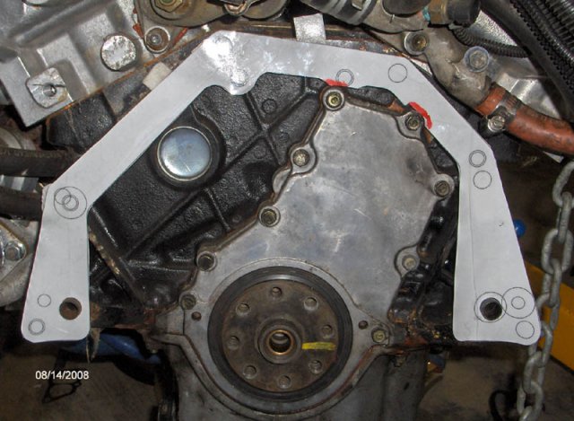

If you look in the link I have above it shows the WC T5 Trans will bolt up with aerostart bell housing and adapter plate. It also goes through the clutch set up. I sent him an email and he was very helpful.

any clearance issues with the crank pulley? do you have any pics of the mounts? are you mounting the engine with the original mounting locations directly aligned with the existing crossmember mount locations? I'm actually in the process of the same swap. Motor will be in the machine shop next week, trans is on the garage floor, and the car is waiting patiently..

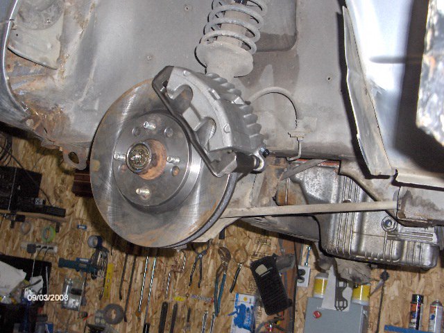

When you get 1/2" of hood clearance on the SHO you have about 1-1/2" of clearance between the pan and the ground. The SHO is one tall engine. I fabed my intake spacers out of 3/8" phenolic laminate.

Correct, I already lopped 1.5" off a spare pan and added large kickouts on each side of the sump....I'll do some kind of baffle or swinging door setup to keep slosh down.

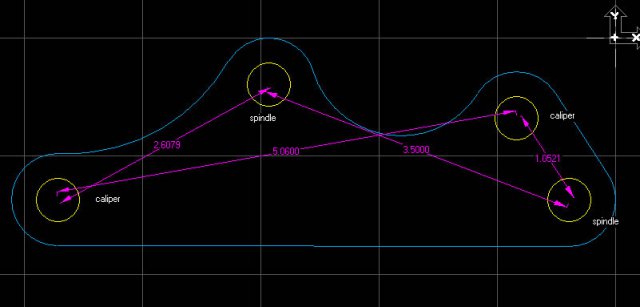

Doing my budget corvette (gm anyhow) brakes and finishing the trans crossmember.... big vented rotors and twin piston aluminum calipers.
I could do 12.75" rotors but they might not fit behind 16" wheels (going to run 16x8 sport max panasport esk wheels).
