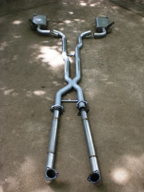

The X-pipe makes the engine sound very even compared to an H-pipe, in my opinion. There's a full write-up of how I built it a 2.5" dual system with an X-pipe behind the transmission crossmember here: http://alteredz.com/exhaust.htm
I bought the X-pipe from Dr. Gas, as I didn't trust that I could weld up a good one myself. Maybe if I had a TIG welder and was decent with one...
If I were to do it again, I'd would build it with slip-joints instead of flanges. I used the large Dynomax Hemi Turbo mufflers to try to maximize muffler volume to get good flow and sound reduction.
The exhaust is not too loud for most people's taste, and it has a deep sound. At above 2500rpm, it sounds very even, unlike many V8's - I believe the X-pipe is to thank for that. It sounds a bit like a muffled NASCAR engine at WOT and some rpm. I'd not do an H-pipe on any car as the only crossover pipe if there were space for the X-pipe. The idea of multiple X- or H-pipes is interesting though!
Here's the system after I had it coated almost to the mufflers:
(I'm not using those headers any longer - I've moved to Sanderson/JTR angle plug type block huggers with D-ports for the Canfield heads. I still would love to do a long tube header, but they would have to be custom as I don't like the way the street rod header that some have used hang so low.)
