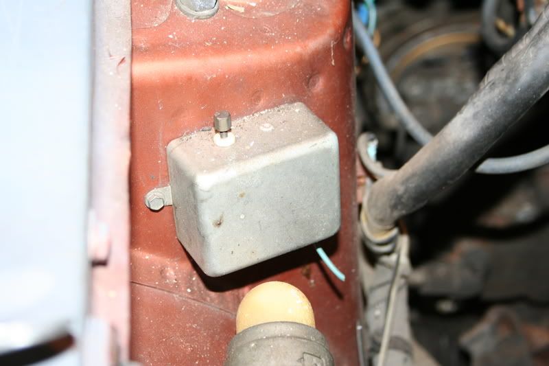

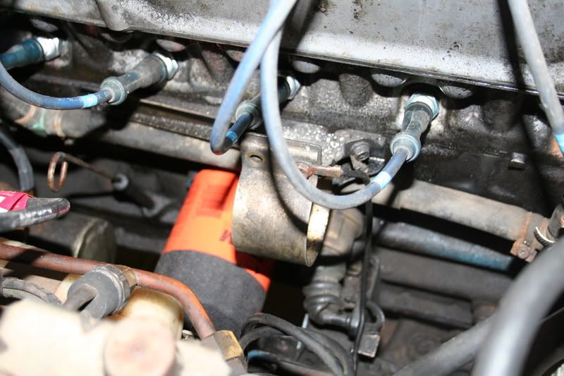

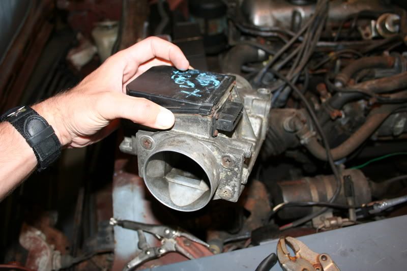

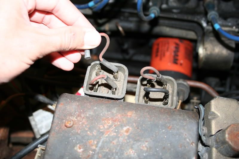

Oddmanout84 Posted August 29, 2008 Author Share Posted August 29, 2008 In the garage finally after pushing it out of the yard The Engine needs a little love (read: money) to get back up to step Fusable Links... broken. I plan to replace them with a Maxi Fuse unit Air Flow Meter: The flap is stuck halfway and requires a little push to go the rest... so THAT'S why it wouldn't rev above 2500 last year.. Mystery componant A: left side of the engine compartment, single wire going to it is cut by previous owner/mechanics. If you can tell me what it is, you're a better man than I Quote Link to comment Share on other sites More sharing options...

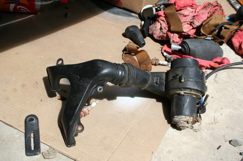

Oddmanout84 Posted August 29, 2008 Author Share Posted August 29, 2008 Mystery Component B: used to be mounted on the engine block and draped over the valve cover. Looks like some sort of blower fan, did not find it in any of my 240-280 documentation, but I have seen it on later 280zx models MC B mount. The engine block used to be blue! As with a few other mystery components and other "uneeded" components, its wiring was cut when I bought the car by the previous owners Image shows the sorry state of the shock boots... All of them are dryrotted like this one. Rear shocks completely bottom out when going over small bumps, causing the tire to rub on the wheel well. Spare tire well. This is AFTER I cleaned out the rats nests and assorted junk in there. Anyone ever had to use that tire? Its junk... mine fell apart during the 3/4 of a mile to the gas station. Note the white mystery wire. Quote Link to comment Share on other sites More sharing options...

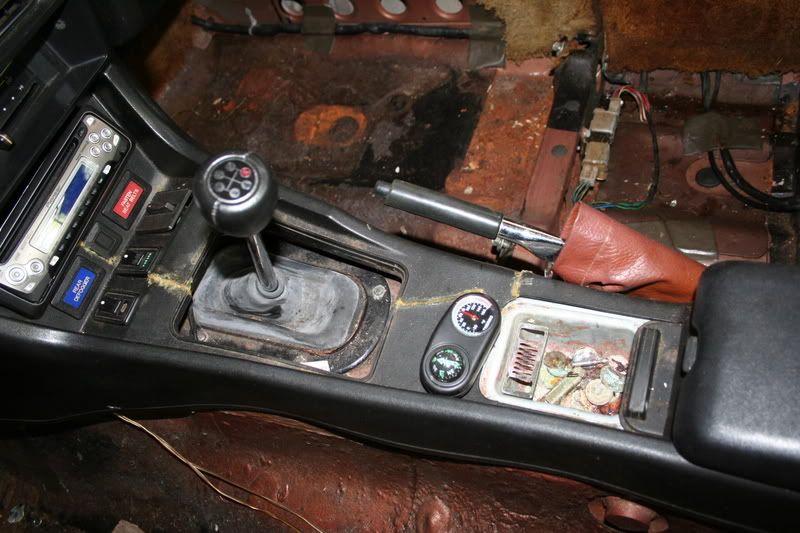

Oddmanout84 Posted August 29, 2008 Author Share Posted August 29, 2008 The interior... I tore out all the old mildewed carpeting which fell apart in my hands. Someone had replaced the original carpet with what looked like shag. Eww... Driver's side. I put the nifty steering wheel and shift nob there. The originals were crumbling apart. Center console. I had to glue the two halves together in order to get the radio to stay in. Quote Link to comment Share on other sites More sharing options...
fhptom Posted August 29, 2008 Share Posted August 29, 2008 Yea you were right, the interior is in pretty good shape minus the carpet. You even have the same pedals as I do. I am in the same boat as you when I picked up my latest 280. Interior looked so good I overlooked a lot of the rust issues the car had with it. It now sits like yours on jackstands waiting to be saved. We all need some type of project to keep us sane. Good luck, Tom Quote Link to comment Share on other sites More sharing options...

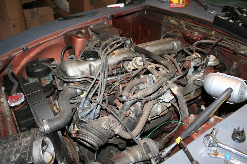

Oddmanout84 Posted August 29, 2008 Author Share Posted August 29, 2008 As in, when I first bought the car 4 years ago. At least it ran back then. Holy crap it has T-tops! Wait, wouldn't you really just consider this thing a split moonroof? I think its gross, but removing it would cause even more problems methinks. I didn't even know these came on my model year. Note the top notch security system sticker. Engine bay, before I ripped mystery component B out. If you can see any sawdust looking deposits, its from the radiator stopleak that was spraying from the old cracked unit. After my professionally home-done rattlecan paint job. The idea was to block out rust before I drove the car across the states to store it. That and I couldn't stand the nasty brown color anymore. Check it out! Bumper bent courtesy of my good friend. If those ugly things are good for something, its cutting through new Impalas and preventing pesky small animals from denting the body. Quote Link to comment Share on other sites More sharing options...
Phantom Posted August 29, 2008 Share Posted August 29, 2008 Mystery component B is a fan added to the 280ZX models to avoid vapor lock when the car is driven in hot climates. This was not an item found on the 280Z, even the California models. Looking at that and at the fuel rails it looks more like you may have a 280ZX motor than a 280Z. This is not bad as the ZX had a broader torque curve. If you can find the head identification you can probably determine the car the motor came from. Quote Link to comment Share on other sites More sharing options...
WizardBlack Posted August 29, 2008 Share Posted August 29, 2008 Mystery component A looks like the hood switch for a security system. The sticker on your quarter glass seems to support that, too. Yeah, B is the fuel injector cooling fan (and associated junk). Take the cover off of your AFM and carefully work a bit of PB Blaster into your flap hinge and it'll work nice and smooth again. Tuning the AFM is easy enough to do via spark plug observation. Check out www.atlanticz.ca for the EFI Bible if you haven't found it already. BTW, welcome home from service, too! Quote Link to comment Share on other sites More sharing options...
Oddmanout84 Posted August 29, 2008 Author Share Posted August 29, 2008 Thanks for the help! You know, I had been wondering if this had a zx motor in it, I'll get my inspection mirror in there and check it out. Either that, or I'm guessing maybe the dealership put it there as a component upgrade? As for the AFM (another interesting fact: there is blue paint marker on its side that is barely visible in the picture; it reads "280ZX"), I think that's a little easier said than done. All the screws on the back plate are stuck to the plate, almost as if they were painted over. I tried a few and got really close to stripping them completely. As much as I hate to do it, I think that I might dremel them out. I find more and more strange and annoying little things on this car every day. Rewiring is going to be a nightmare, much of the connections in this car have been carelessly cut and spliced. Oh, and I thought earlier that I was lucky not to have rusted out floorpans? WRONG! today while cleaning out the interior I found a hidden rust patch on the passenger side and easily punched my finger through it. Well, looks like I'll have to find a service manual for this engine, if it really is a zx motor. I'll make an update later, right now its food time! Quote Link to comment Share on other sites More sharing options...
Oddmanout84 Posted August 30, 2008 Author Share Posted August 30, 2008 Looks like the motor I've got in there is an N42 block with a N47 head. After searching around for a while, it looks like since I'm on a budget my best bet would be to source an L28ET from somewhere for an economical turbo setup. The problem is sourcing one! The junkyards around here have not been helpful at all, in fact I wasn't even able to walk around and find anything. They just guided me to a parts office where a man at a computer asked me what I wanted. When I mentioned that I was looking for a motor out of an 81-83 zxT he scoffed and said no one carries those old cars anymore. So much for that. Ebay had nothing. Craigslist didn't either. I guess tomorrow I'll head over to the local Nissan dealership and see if i can talk to one of their mechanics who's knowlegable about the old Zs. They have a classic Z meet every year so maybe I'll get lucky. Quote Link to comment Share on other sites More sharing options...

Oddmanout84 Posted August 31, 2008 Author Share Posted August 31, 2008 But at least I fixed my air flow meter! Quote Link to comment Share on other sites More sharing options...
