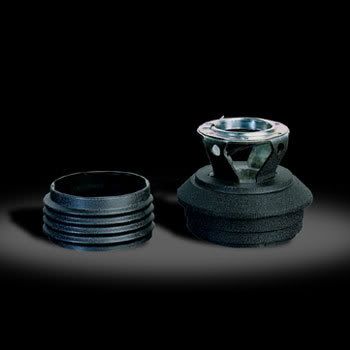

bjhines Posted September 30, 2008 Share Posted September 30, 2008 I put a fair amount of thought into this issue. This won't work for a stock wheel becasue it bolts directly to the steering shaft. Most steering wheel conversions use an adaptor to bolt a universal steering wheel to your steering column. This adaptor is usually 3-4" thick. This means that you would use a flatter wheel(less dish) than the stocker. This will place a flat(Zero-dish) wheel a little too far away for most people. You would need one of the moderately dished(~30mm) wheels to get it just right. If you add a bolt-on quick release then you are going to increase your stack of parts by ~3". That will bring even a flat no-dish wheel too close for comfort for just about anyone. The first thing you need to know is... How close do you want the wheel? This is a variable answer question. Different body shapes and seating positions will make this a hard to answer question. The answer I found with most tracked 240Zs with race seats is more easily measured from the firewall-flange at the bottom of the steering column to the flush face of the wheel rim. Put a board across your wheel and pull that tape. Most measurements from track equipped S-30s range from 30"-34". Mine is 33.75" from the flange to the face of the grip. I have the OMP Velocita wheel(350mm with no dish) I purchased a thin-Profile NRG quick release mechanism. It is only 1.5" thick as opposed to most of the other bolt-on styles that are 3" or more. The adaptor I used is a Japanese brand I will have to look up. It is pretty standard fair for S-30 to Momo/Sparco/OMP 6 bolt flanges. Both the adaptor and the quick release are double drilled to accomodate 2 6-bolt patterns. 5 bolt patterns like the Grant/Nardi/Personal wheels are out for most of the adaptors. Here is a Momo adapter .... Quote Link to comment Share on other sites More sharing options...

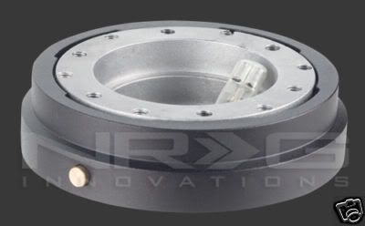

Young Z Posted October 1, 2008 Share Posted October 1, 2008 Hmm... so you can bolt a quick release onto the hub that you pictured above? I have the exact same one but am totally lost in terms of how to install my k-sport quick release b/c the instructions are in Japanese. I was thinking about getting something like this-http://www.racinglab.com/nrg-short-hub-nissan-004.html Quote Link to comment Share on other sites More sharing options...
TrumpetRhapsody Posted October 1, 2008 Share Posted October 1, 2008 You can get them much less expensive. But it wobbles a bit. NRG is good quality, but the Chinese knockoffs (like I'm using) are acceptable Quote Link to comment Share on other sites More sharing options...
Young Z Posted October 1, 2008 Share Posted October 1, 2008 You can get htem much less expensive. But it wobbles. NRG is good quality, but the chinese knockoffs (like I'm using) are acceptable Do you remember where you got your hub from? Quote Link to comment Share on other sites More sharing options...
TrumpetRhapsody Posted October 1, 2008 Share Posted October 1, 2008 The cheapest steering hub I could find for our cars was a $70 ebay momo. The short quick-release portion just search ebay for, it was like $17. This is the portion I was referring to being a bit wobbly. I'm going to try and put felt the contact area to see if that takes the play out. With a normal size momo hub, and a short quickrelease, the wheel seems about stock distance (or close enough). Quote Link to comment Share on other sites More sharing options...
zx_drift Posted October 3, 2008 Share Posted October 3, 2008 if you're building a race car, get the momo hub with an NRG quick release. it may be 3" longer, but it feels so much better to have the wheel closer to you. (while having your feet in the same position). It's also easier to steer when its close to you. Quote Link to comment Share on other sites More sharing options...
