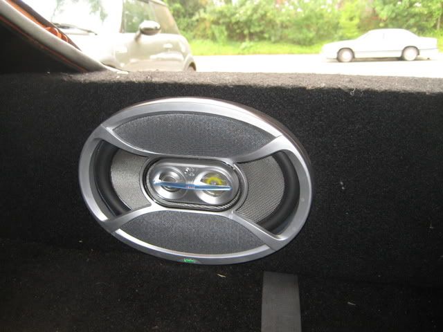

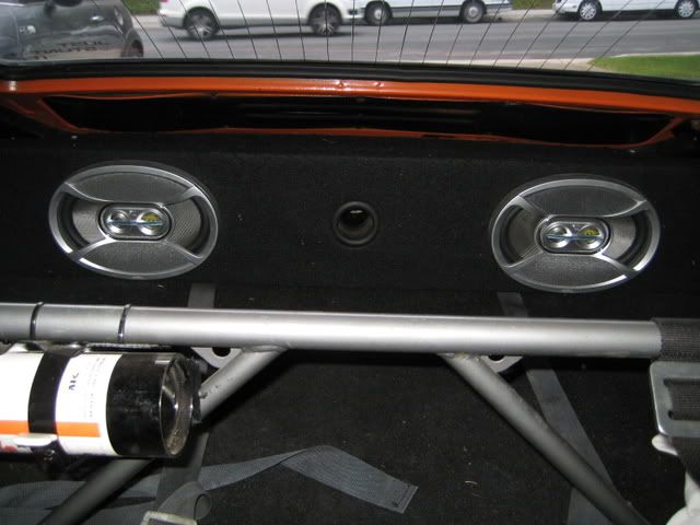

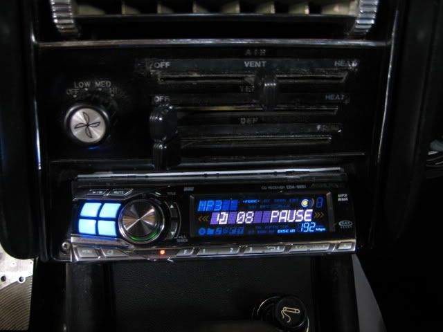

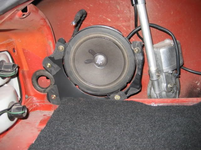

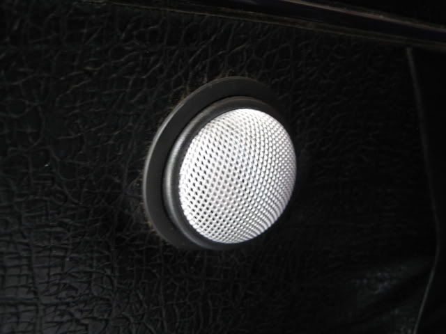

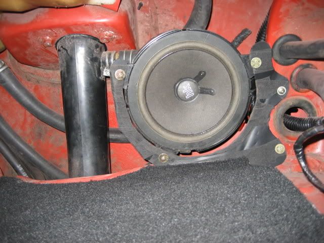

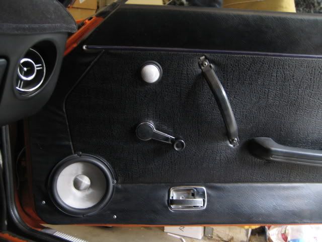

Here ya go, sorry I didn't take any pictures of my subs, its kind of a b!tch to take everything out to get to the subs. The rear speaker box is a bit difficult to get back in perfectly sealed. The tweeters shown can swivel in place, and they are currently pointed towards the seats. The 6 1/2's in the doors do come with plastic covers but they make the speakers look unnecessarily HUGE, and stick out of the panels way too much.

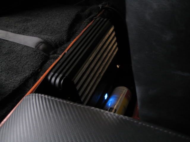

Here is the powered sub enclosure I'm using:
http://www.crutchfield.com/S-soygeltrY1Z/App/Product/Item/Main.aspx?I=113KSCSW1
It simply slips in front of the center bracket in the tire well. I made a bracket that clamps down on the box and holds it in place with the stock spare tire holder. (the giant screw)
Dayz, those BMW HK speakers sound fantastic. My brother's Mini Cooper has the HK setup with those speakers in the doors and it sounds very very crisp. What you can do when reassembling the interior panels is to cushion them. I found these adhesive backed rubber strips at home depot, and lined them where each interior panel touch/overlap each other, so I get zero vibrations from those panels with the stereo blasting.
