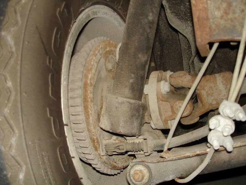

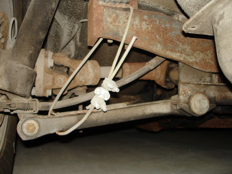

zeeboost Posted September 8, 2008 Author Share Posted September 8, 2008 Sure, here's all I have with my cell cam so far: Included were these professional droop limiters Quote Link to comment Share on other sites More sharing options...

jerryb Posted September 8, 2008 Share Posted September 8, 2008 what on earth is that steel cable holding the rear control arms for!!! Quote Link to comment Share on other sites More sharing options...
stony Posted September 8, 2008 Share Posted September 8, 2008 limits extention. Drag racers do it on the front end to limit travel Quote Link to comment Share on other sites More sharing options...
jerryb Posted September 8, 2008 Share Posted September 8, 2008 Thank you sir...so I can assume that the setup requires this to prevent the halfshafts from over extending. stony said: limits extention. Drag racers do it on the front end to limit travel Quote Link to comment Share on other sites More sharing options...
Six_Shooter Posted September 8, 2008 Share Posted September 8, 2008 jerryb said: what on earth is that steel cable holding the rear control arms for!!! I've been thinking the same thing, they will have no use under driving conditions, except maybe extremely hard braking, would have to be from an extremely high speed and VERY hard braking. MAYBE extremly hard cornering might pick up the inside rear wheel, but then I would want it to droop, and stay in contact with the road. The only other use I can see is like you said to keep from over extending the half shafts, when the car is being raised by a jack or lift. Quote Link to comment Share on other sites More sharing options...
