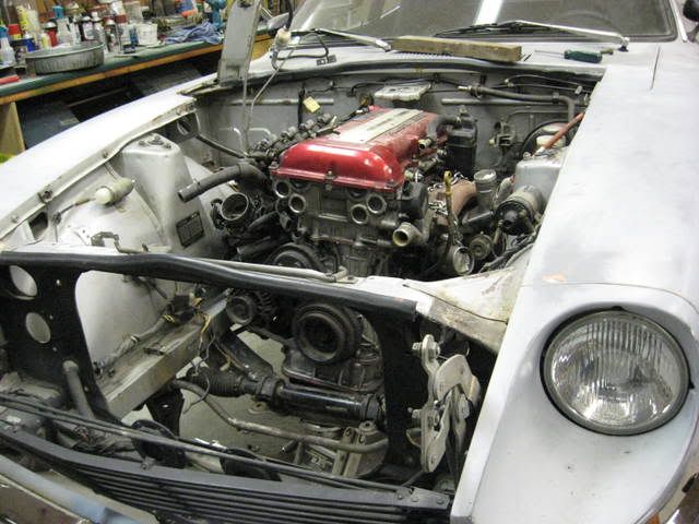

logr Posted January 6, 2009 Author Share Posted January 6, 2009 I'm in the middle of this SR swap and I don't see enough clearance between the turbo outlet and the firewall. The shifter is also barely in the original hole and the SR mount will not clear the steering shaft. I have read where the original crossmember just clears the pan. I am not having that luck. It is a 240Z. It looks like the L28 mounts, on the SR, might clear the steering but I need some room for the turbo outlet without cooking the firewall. There are also some brake splitters or sensors right there where cooking looks very promising. What am I missing? I removed the front crossmember and sectioned it to move the steering rack mount part forward 1/2 in. I also removed the back part of it to give another 1/2 in clearance for the oil pan. This now gives me room to not cook the firewall (hopefully) and puts the shifter in a great location. By moving the engine forward, the trans mount is more likely to be pushing straight down on the rear crossmember instead of have a bad leverage on the tunnel mounts. I would have preferred to have the engine back more but don't see how it is possible. Seems like the pan should not be below the crossmember or the pan would be the first thing to hit anything. Any comments are welcome. I am starting on the actual mounts now. Quote Link to comment Share on other sites More sharing options...
logr Posted January 13, 2009 Author Share Posted January 13, 2009 It is in and fits well by moving it forward just a bit and gaining clearance on the crossmember. I now have about 2 inches to the firewall from the turbo outlet. The shifter is well into the original hole. I cut the trans crossmember on both sides of the mount and put a flat bar in the cut to move it back just a bit and welded it all together. Works and looks great. I used all L24 mounts. The fronts are in upside down to bolt onto the SR with one bolt. The Z driveline slips into the SR trans, a plus I didn't expect. I weighed the SR and trans at 320. New crossmember is 9 lbs. No intercooler yet but that might add 20lbs total. The L28 maxed out my scales. I need to split the trans off and retry but my hoist groans when I lift it. Quote Link to comment Share on other sites More sharing options...
logr Posted January 28, 2009 Author Share Posted January 28, 2009 Here is what I ended up for the SR front mount. Here is the SR installed. Quote Link to comment Share on other sites More sharing options...
