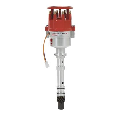

sweetride2go Posted November 21, 2009 Share Posted November 21, 2009 280Z, I had the same problem, but with less miles. I found that the distributor wasn't sitting on the intake, so the clamp was pushing the dizzy down onto the oil pump drive shaft. I bought a shim kit for the dizzy so it would sit properly, and this also dropped the oil pressure a tad, but for me that isn't a problem since mine is high anyways. I haven't put many miles on it since or checked the gear. Also, I ended up going with a composite gear, so if I get around to checking it, I will let you know. I also noticed that my dizzy has two O-rings on the base of it, and after reading what Grumpy said, maybe this is creating a lubrication problem for the two gears? My dizzy is similar to this one http://www.summitracing.com/parts/MSD-8361/?image=large hopefully grumpy can chime in on this because now I'm curious. Ryan~ Quote Link to comment Share on other sites More sharing options...
grumpyvette Posted November 21, 2009 Author Share Posted November 21, 2009 (edited) some of the better distributors with o-ring grooves have a small oil hole drilled between the o-rings that allows a steady stream of pressurized oil to enter the lower distributor shaft, the upper bearing is sealed so oil can,t exit into the upper distributor, but oil is routed to lube the lower bearing in the distributor, the oil exits to spray over the cam gear/distributor gear contact area, look closely at yours non-o-ring distributor base , that relies on tight clearances to limit oil flow from the blocks oil passages notice the o-rings on these distributor bases used to limit oil loss from the oil passages in the block, Edited November 21, 2009 by grumpyvette Quote Link to comment Share on other sites More sharing options...
