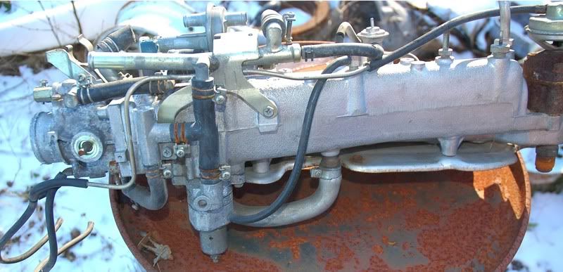

JSM Posted December 16, 2008 Share Posted December 16, 2008 ... later ZX’s it is on the bottom of the manifold itself. Really, I don't recall seeing this on the ZX under the Manifold?? You have a pic by chance? Quote Link to comment Share on other sites More sharing options...
Administrators BRAAP Posted December 16, 2008 Administrators Share Posted December 16, 2008 Really, I don't recall seeing this on the ZX under the Manifold?? You have a pic by chance? Here ye be... As far as I know, regarding ALL Z cars in the US market, if the TB doesn't have the BCDD on it, then it was on the bottom of the intake manifold as pictured below. Started at some point during the 280-ZX run, possibly 81+?... This particular one came off an '83 N/A ZX. Quote Link to comment Share on other sites More sharing options...

JSM Posted December 16, 2008 Share Posted December 16, 2008 Thanks Paul! I can't honestly remember seeing one an a ZX? I knew they were on the early ones on the TB, but not the ZX. Now I'm gonna have to pay attention for them. They must have been removed from a lot of cars. Quote Link to comment Share on other sites More sharing options...
