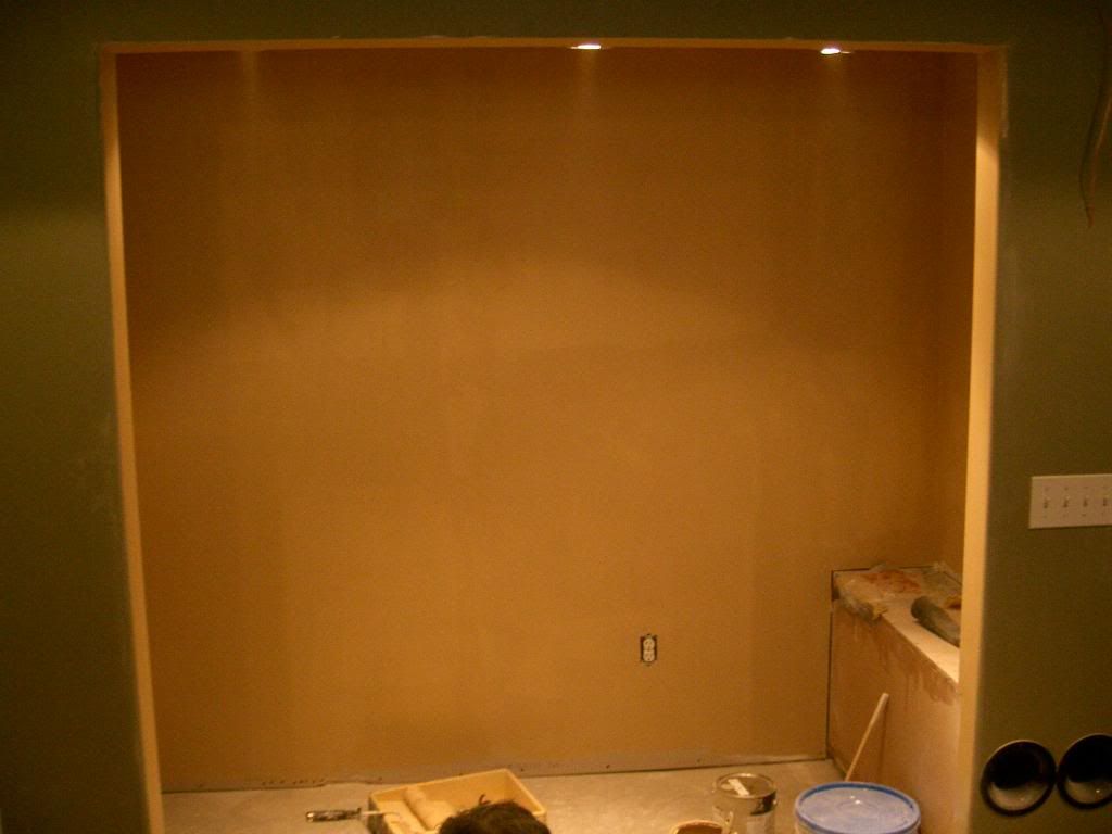

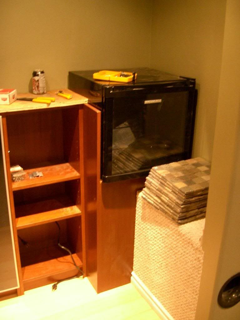

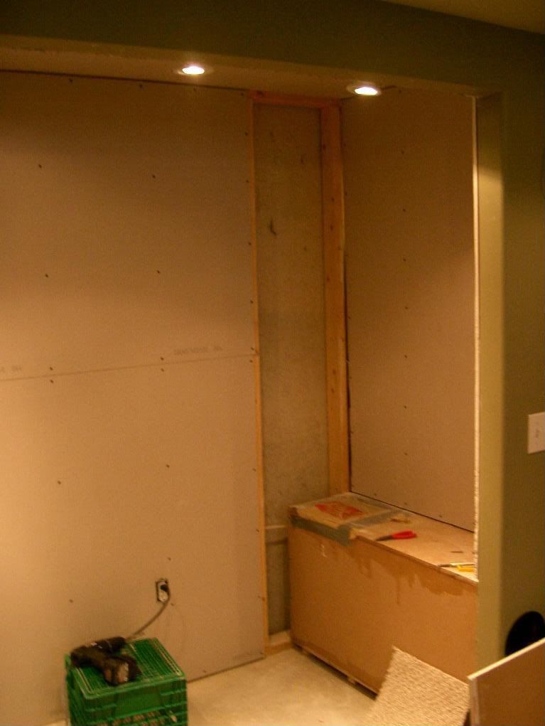

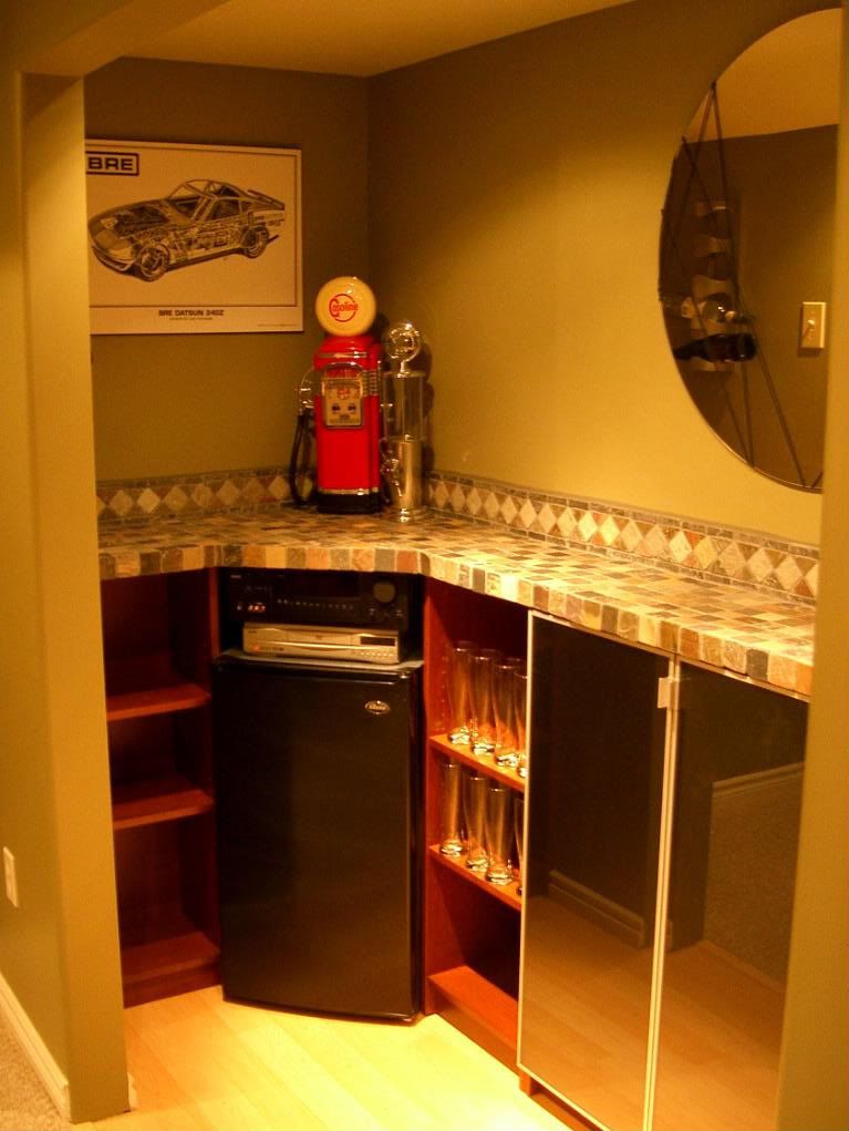

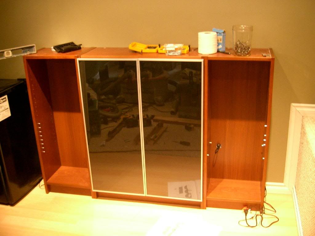

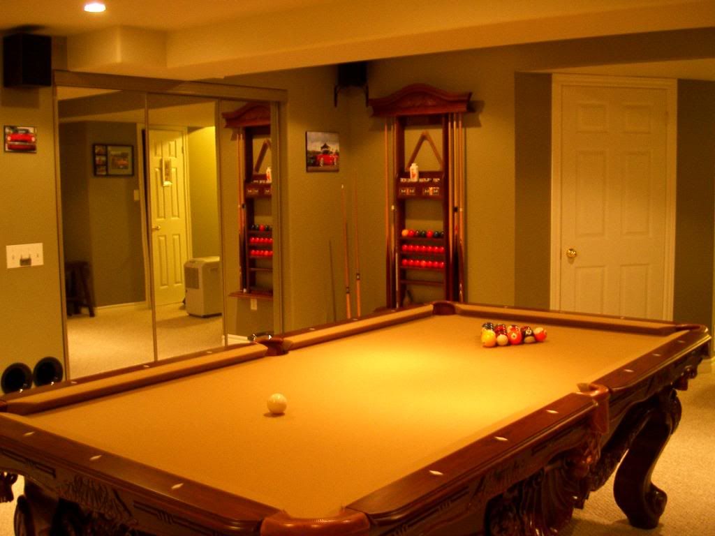

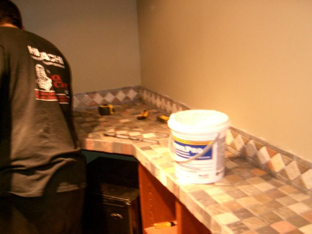

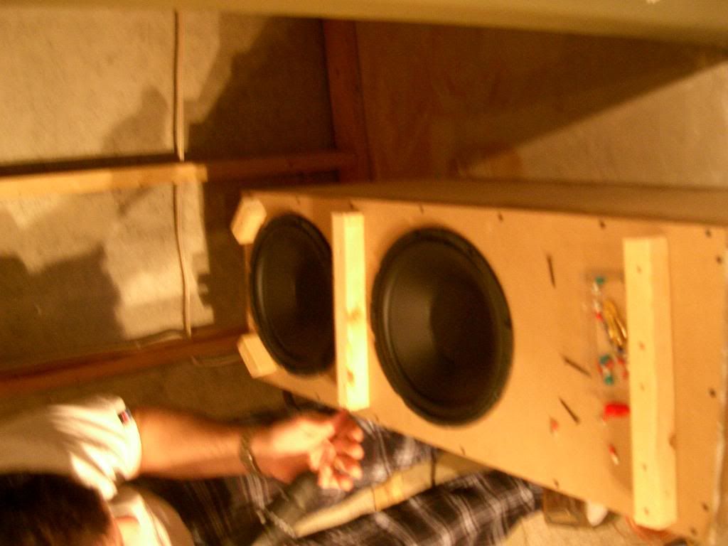

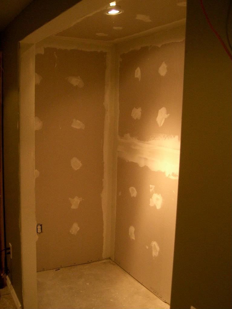

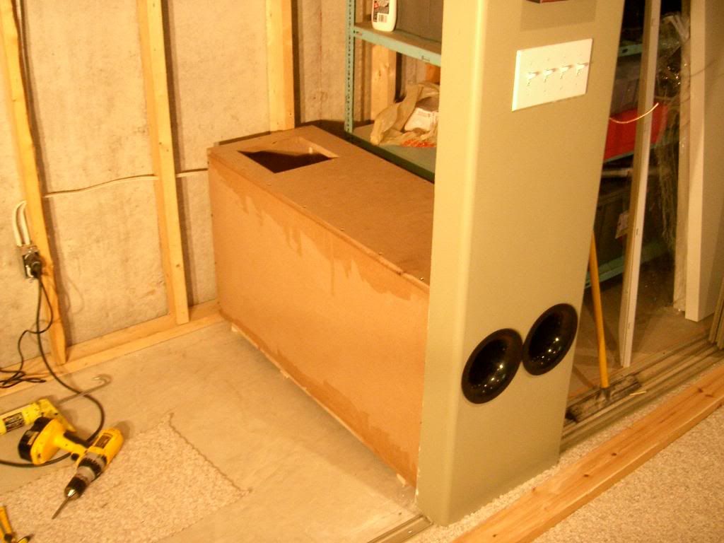

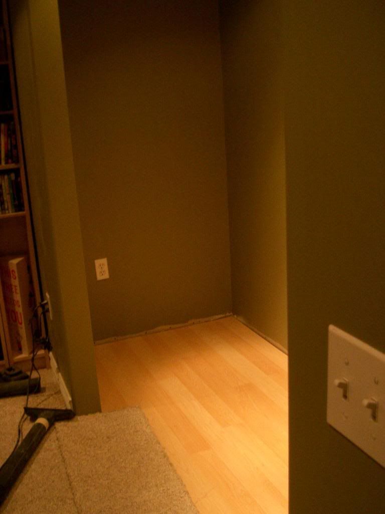

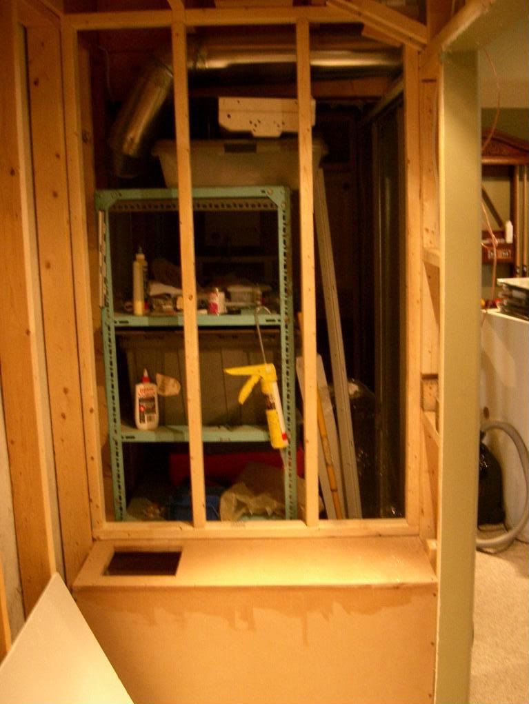

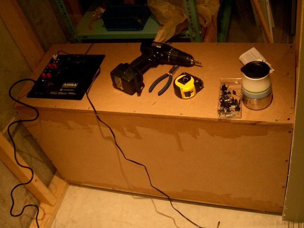

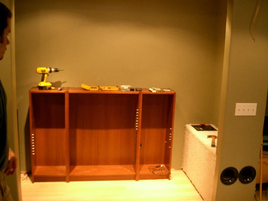

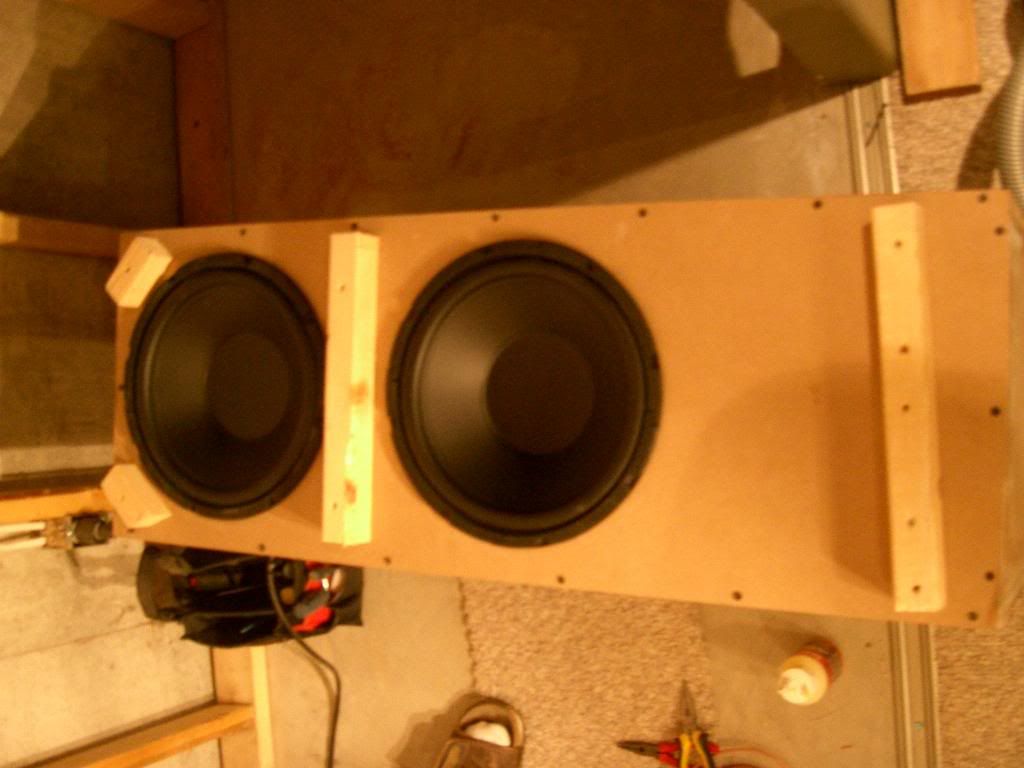

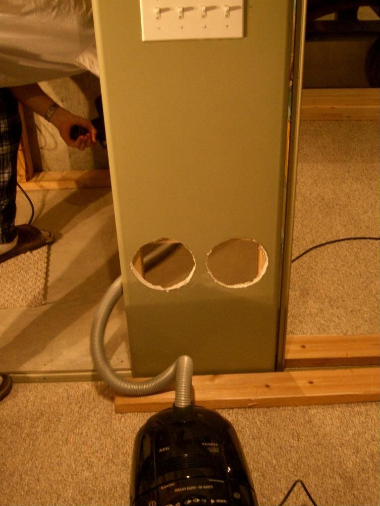

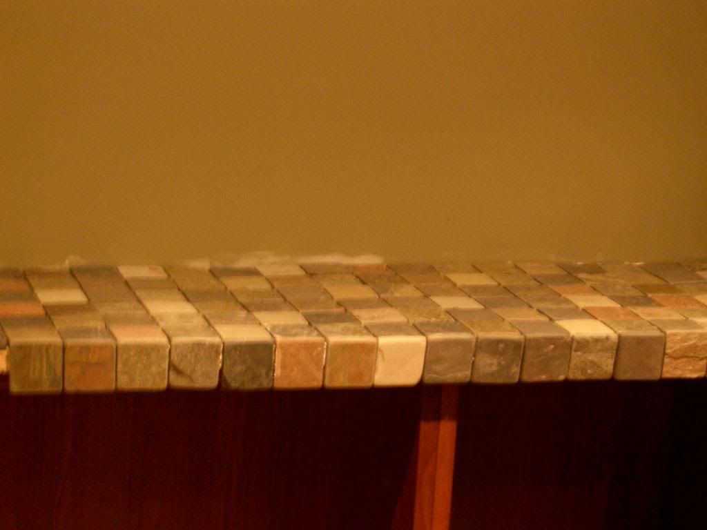

janaka Posted October 3, 2008 Share Posted October 3, 2008 Well after a long process I completed my basement build Additions include: Dry Bar, Billiards set up, TV, Audio and foundation repair. Pictures of the process and completed project. The first part of the build was starting the bar. First thing we did was build in a subwoofer box into the new wall that was built. Two 12" EQHS subs from Elemental Designs in a ported box. Cool part of it was that we ported the box through the wall into the billiards room. Turned out awesome. Powered by by 350w @ 4ohm. New wall built on sub box Drywall on new wall Mudding all drywall Paint on walls New pot lights wired in Laminate floors Cabnits and carpeted sub box Coffee and countertop Wine Fridge Slate tiles going in Finished Product can anyone name who's Yellow Datsun is with mine in the picture on the wine fridge? Quote Link to comment Share on other sites More sharing options...

proxlamus© Posted October 3, 2008 Share Posted October 3, 2008 don't most home theater/audio speakers and subs run at 8 ohms?? not 4? Quote Link to comment Share on other sites More sharing options...
tannji Posted October 3, 2008 Share Posted October 3, 2008 If two 4 ohm speakers are wired in series, it supplies an 8 ohm load, and many high-end receiver/amps are capable of running 4 ohm speakers... Just be careful, as an amp may have a "cosmetic" switch for 4/8 ohm, but not be truly capable of driving twice the power to the 4 ohm speaker. Quote Link to comment Share on other sites More sharing options...

janaka Posted October 3, 2008 Author Share Posted October 3, 2008 don't most home theater/audio speakers and subs run at 8 ohms?? not 4? These were two 2ohm drivers. Final load is 4ohm to the plate amp With the 3 speakers in the room and the two subs its more than enough to annoy my neighbors while still having good sound quality When we bought the house the area that is the bar now was just a closet used for storage with mirrored doors. It was a no brainer to turn it into more usable room and put a bar in. We are very happy with how the project turned out in the end. Even more so that we (me, wife and neighbor) did ALL the work. My wife gets the credit for picking colours, materials and all that jazz. We are the most impressed with how the slate countertop turned out I think. Six_shooter: JerryB it is! That was 2007 at Christie Lake. At that time I didn't even know he lived in Cambridge! I didn't know till just this year and I've had that blown up since Christmas. Pretty cool coincidence in the end! If the OZC guys are interested in having a winter party or something I'm sure my wife won't mind having a few people over for an evening here and there. We put this in to be used and not just looked at. I foresee many hours of enjoyment coming from the work! Quote Link to comment Share on other sites More sharing options...
