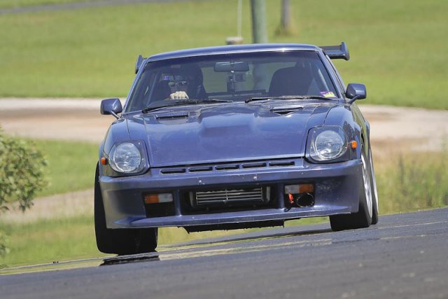

260DET Posted June 11, 2010 Share Posted June 11, 2010 Looking at the pics above that car needs more front roll stiffness (and perhaps a stiffer chassis) to wedge weight back on to that inside rear to get some traction and keep the wheel angles within limits, car looks fairly awful really. Below is a pic of a car with a lot of front roll stiffness taking a slow right 180 degree corner, note the inside front is just off the ground, thats all due to a stiff chassis and a big front ARB holding the inside wheel up. Quote Link to comment Share on other sites More sharing options...
