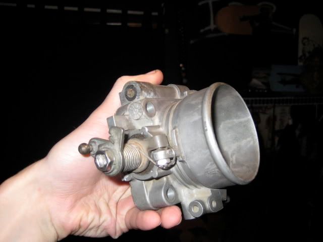

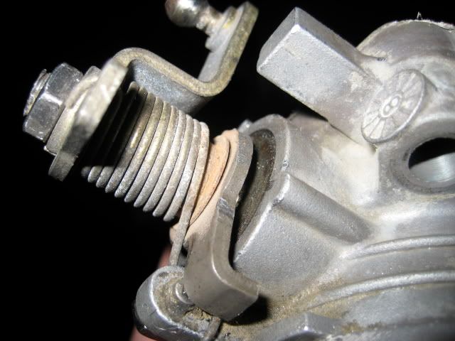

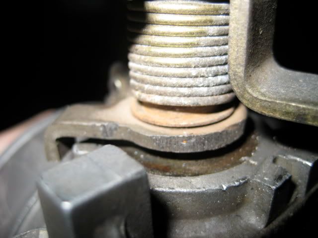

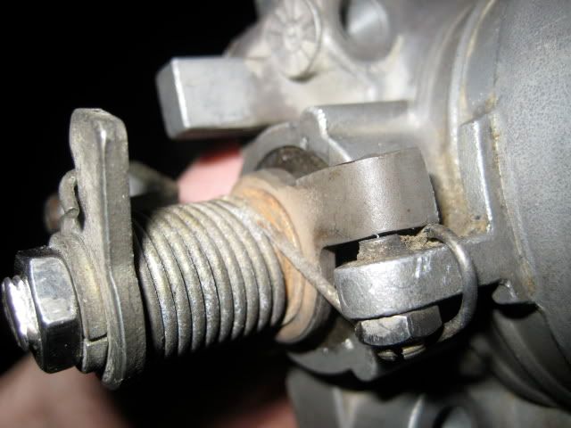

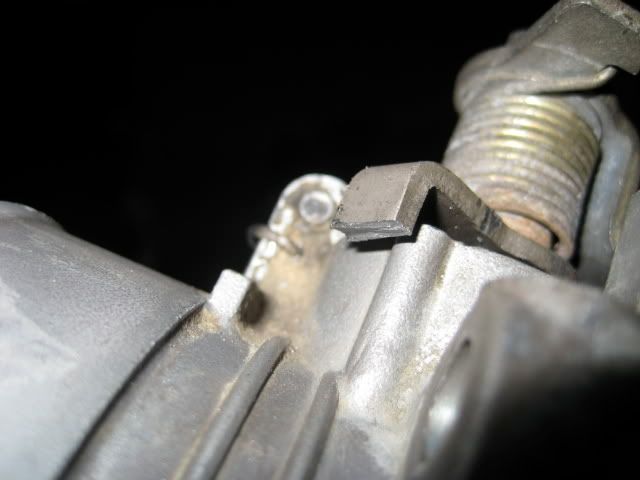

skib Posted December 5, 2008 Share Posted December 5, 2008 just to add a little, heres my adapted linkage. I used all of the linkage from the ZX throttle body and just did a little trimming SX tb with the Z linkage making the "stopper" had an "arm" here that I cut off ^ (it was the arm that has the hole for the spring in it) and trimmed this "arm" down.^ and of course shaft has been trimmed and re-threaded since it originally has two cable things on it. and the rest slides on as seen in the pics. Quote Link to comment Share on other sites More sharing options...
