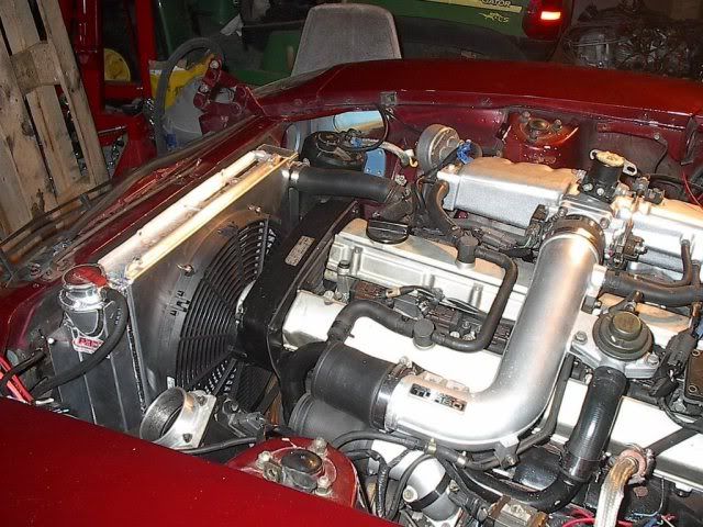

Here's my rad setup, its a double pass aluminum rad, outlets both on the right hand size. It was made by a custom shop in Tennessee I think, Ill have to check. Any how alot of Chevy hot-rod rads fit you just need to get busy with a tape measure. I think this cost me 250 or so US. Fits perfect, I use one small flexilite fan on it and it has never even gotten close to overheating, even in stop and go traffic.
