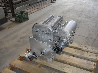

ZZZeee Posted December 14, 2008 Share Posted December 14, 2008 ^^^ Why did they mount the throttle body on top of the exhaust manifold??? Quote Link to comment Share on other sites More sharing options...
blue72 Posted December 14, 2008 Share Posted December 14, 2008 That's a composite intake manifold. The exhaust manifold is on the other side of the engine. Quote Link to comment Share on other sites More sharing options...
ZZZeee Posted December 15, 2008 Share Posted December 15, 2008 Man, from the pic I can't tell how that bugger's configured. Now I'm curious. blue72 said: That's a composite intake manifold. The exhaust manifold is on the other side of the engine. Quote Link to comment Share on other sites More sharing options...
Gollum Posted December 23, 2008 Share Posted December 23, 2008 The throttle body is probably going into a resonate chamber bellow the runners, the it makes a 180 degree turn to head back to the head. Looks like a good low end torque design, and if the runners are large enough should breathe cleanly up to 5500rpm or so. I can't imagine a swap costing 5-6k though, even with turbo parts. How much do the engines cost to get a hold of? But even 5k is a reasonable amount of money to spend on a SR swap too... Look at the budget alot of the SR guys have and you'll see that many of them are spending that kind of money. Why? Because they want more than stock power and end up replacing part after part to make sure it's still "reliable" and "done right". I don't think they're necessarily wrong for doing so, but I'm just saying 5k is common for lots of people to spend on swaps. Oh, and how much does this engine really weigh? Because the stock L series isn't nearly as heavy as people seem to think. It's more about where it's mounted than how much it weighs. The stock L series sits a good 3" from the firewall and can sit about 1" lower without too much risk of killing the oil pan. Just doing a good mount job and shortening your driveshaft can give you a very good weight balance to START with, then suspension tuning can begin and that's where the real magic in handling lies. I think in the long run, you'd be saving no more than 40 pounds, which isn't much honestly. Quote Link to comment Share on other sites More sharing options...

blue72 Posted January 27, 2009 Share Posted January 27, 2009 I haven't forgotten about you Emptyset. Two days ago I found my page of notes with the measurements, but couldn't remember which was L16 and which was Ecotec. I was going to get some better measurements today, but it snowed a foot and a half. Here's for ZZZeee. A picture I took between snowstorms: That should help you understand the odd configuration of the intake manifold. Quote Link to comment Share on other sites More sharing options...
