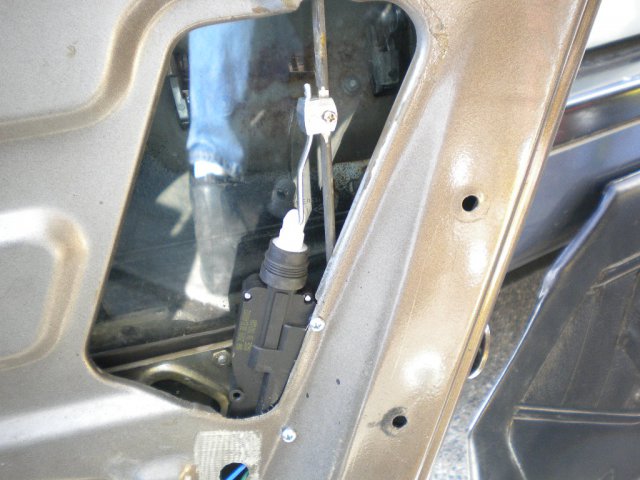

janaka Posted January 9, 2009 Share Posted January 9, 2009 here are some pictures of my install. I didn't use the stock panels as I upgraded to FG panels for my stereo. This made life a lot easier for me in the end I think...maybe...lol This picture didn't upload so here it is separately Quote Link to comment Share on other sites More sharing options...
