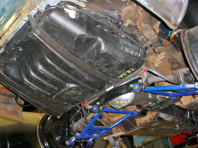

kj280z Posted February 7, 2009 Share Posted February 7, 2009 What fuel tank did you use (shown in this pic)? Any further information on the installation? Quote Link to comment Share on other sites More sharing options...
Bigdeezs Posted February 7, 2009 Share Posted February 7, 2009 Looks like a F-body(Camaro/Firebird) tank. Quote Link to comment Share on other sites More sharing options...

palosfv3 Posted February 9, 2009 Author Share Posted February 9, 2009 Speaking of the Camaro tank...I am still just partway through my LS1 build and after welding up a fairly substantial setup for the stock Camaro tank, I abandoned it because of the lack of room for exhaust pipes or mufflers. Now I have this http://www.tanksinc.com/index.cfm/page/ptype=product/product_id=121/category_id=69/home_id=59/mode=prod/prd121.htmand it appears to be a much better fit. I'll be welding up mounts this week and will post pics when I get er in. Lots of room, and uses a factory style in-tank pump. I hope it works out well so that I can contribute something useful back to this forum. Looked real hard at tanks for this swap. I believe you will run into many of the same issues whether you use the Camaro/Firebird tank or the custom tank in your link. Theres really no easy way with the exhaust around the tank. This is due to where the pipes need to be routed under the center of the car and around the rear suspension. The Camaro tank offers one other little advantage. It tapers from front to back and as such tucks up under the rear valance much neater than other tanks. Quote Link to comment Share on other sites More sharing options...
rags Posted February 9, 2009 Share Posted February 9, 2009 Larry, Which straps did you use to hang the F body tank? It almost looks as if you used the stock Datsun straps?! Joe Quote Link to comment Share on other sites More sharing options...
palosfv3 Posted February 9, 2009 Author Share Posted February 9, 2009 Larry, Which straps did you use to hang the F body tank? It almost looks as if you used the stock Datsun straps?! Joe New straps were fabricated from 1 1/4 " wide x 1/8" flat stock. We used the original anchor slots in the rear body inner panel and modified the length to fit to the new front floor mount area and tank contour. Take an original strap and overlay the anchor area with some masking tape. Trim to the edges and transfer to the flatstock. Works pretty nicely and not difficult to do. Quote Link to comment Share on other sites More sharing options...

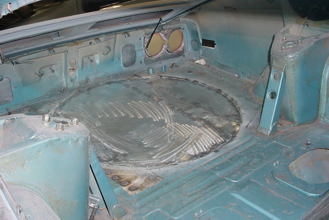

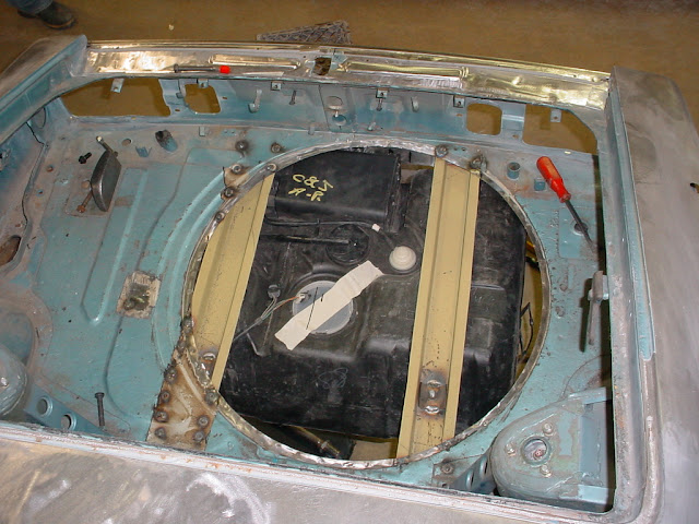

kj280z Posted February 9, 2009 Share Posted February 9, 2009 What year(s) camaro tank is this? (I've seen a few posts where there are slight differences and I'd like to be sure) Also, did you remove the rear spare tire well for installation of this tank? Would love to hear more... I'm about to do the same and have been anguishing over details like this... Thanks for your help and AMAZING job! Quote Link to comment Share on other sites More sharing options...

cheesepocket Posted February 10, 2009 Share Posted February 10, 2009 What year(s) camaro tank is this? (I've seen a few posts where there are slight differences and I'd like to be sure) Also, did you remove the rear spare tire well for installation of this tank? Would love to hear more... I'm about to do the same and have been anguishing over details like this... Thanks for your help and AMAZING job! Indeed, the spare tire well had to go. Used a steel sawzall to cut around. Then use sheet steel to patch in. I got this far on putting in the T/A tank before deciding to use a new tank. I spent a bunch of time removing the original tank strap mounting plates from the T/A, one spot weld at a time. Then I welded them onto the bottom of the spare tire hole plate. Turned out really heavy, but sturdy. I'm hoping the new tank helps out the exhaust issue. I'm looking into oval cross-section pipe for the part that goes under the rear suspension. BTW, I won't be teaching welding school anytime soon Quote Link to comment Share on other sites More sharing options...

palosfv3 Posted February 11, 2009 Author Share Posted February 11, 2009 Quote: Originally Posted by kjones What year(s) camaro tank is this? (I've seen a few posts where there are slight differences and I'd like to be sure) Also, did you remove the rear spare tire well for installation of this tank? Would love to hear more... I'm about to do the same and have been anguishing over details like this... Thanks for your help and AMAZING job! Indeed, the spare tire well had to go. Used a steel sawzall to cut around. Then use sheet steel to patch in. I got this far on putting in the T/A tank before deciding to use a new tank. I spent a bunch of time removing the original tank strap mounting plates from the T/A, one spot weld at a time. Then I welded them onto the bottom of the spare tire hole plate. Turned out really heavy, but sturdy. I'm hoping the new tank helps out the exhaust issue. I'm looking into oval cross-section pipe for the part that goes under the rear suspension. BTW, I won't be teaching welding school anytime soon :roll:22 Hours Ago 06:42 PM We thought about using the Camaro/Firebird upper floor reinforcements for mounting the tank into the Z but it just doesn't fit into the Z floor with out major work. The Camaro brackets also hang down way to far near the rear axle assy. We drilled out the spare tire well spot welds to neatly remove it from the floor pan. Flipped it over on a piece of 20 guage sheetmetal and traced the pattern and cut out the metal for the new floor panel. We then fabricated 2 pieces of 16 guage into hat channels that fit neatly into the locating slots in the top of the tank. We the cleaned all the areas that were to be welded to . This included the crossmember above the axle , the lower portion of the trunk floor and the rear body reinforcement at the floor pan. Straps were then formed around the tank so as to have the correct shape to hold things in place . A reinforcing plate was made and welded into the hat channel for the strap retaing bolt nuts. Things were dry fit (Tank, rails & straps ) and all rail locations marked with the floor panel removed. Once everything was in place the floor panel was put in place and scribed . All new reinforcements and panels were then plug welded in place . Similar to the way the factory would spot weld these together . All pieces were tacked in place . Test fit one more time and then final welded in place . I have pics of some of the work. Will post them as soon as I can get to the other computer they are stored in. Quote Link to comment Share on other sites More sharing options...
