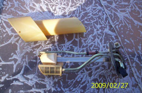

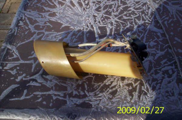

islanddozer Posted February 27, 2009 Share Posted February 27, 2009 no need to drop tank. Inside hatch under foam there is a round access cover to the top of tank. Pull screws, disconnect fuel lines and pop out. I have attached some pics of pick-up. there is one tab that needs to be bent back and 3 screws to remove the plastic Hope this helps Quote Link to comment Share on other sites More sharing options...
Challenger Posted February 28, 2009 Author Share Posted February 28, 2009 Well the filter is clean but it doesnt have the plastic tube thing. Is that needed? Thanks for the pictures. Quote Link to comment Share on other sites More sharing options...
islanddozer Posted February 28, 2009 Share Posted February 28, 2009 It is a sump that collects the crud. Thought my tank was clean then saw the crude in mine. Glad I pulled it out. Not sure if it is needed as long as the tank is clean. Quote Link to comment Share on other sites More sharing options...
