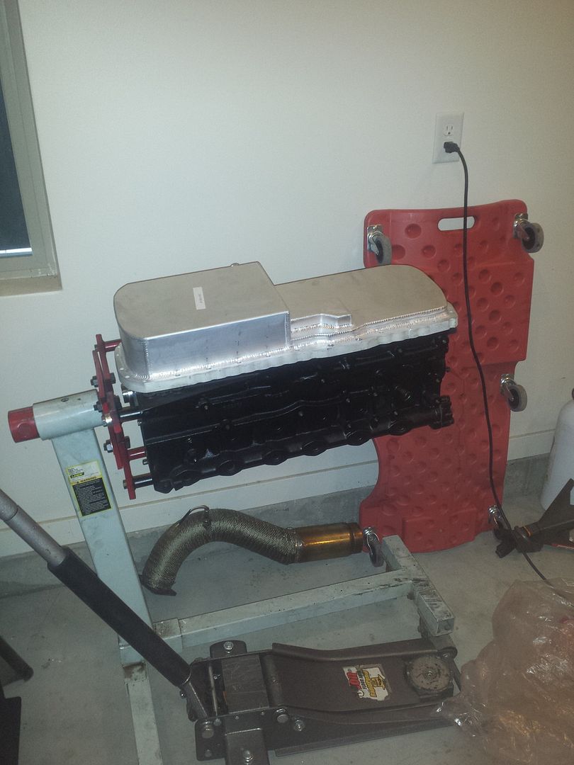

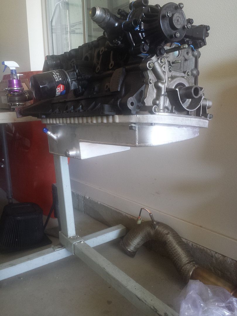

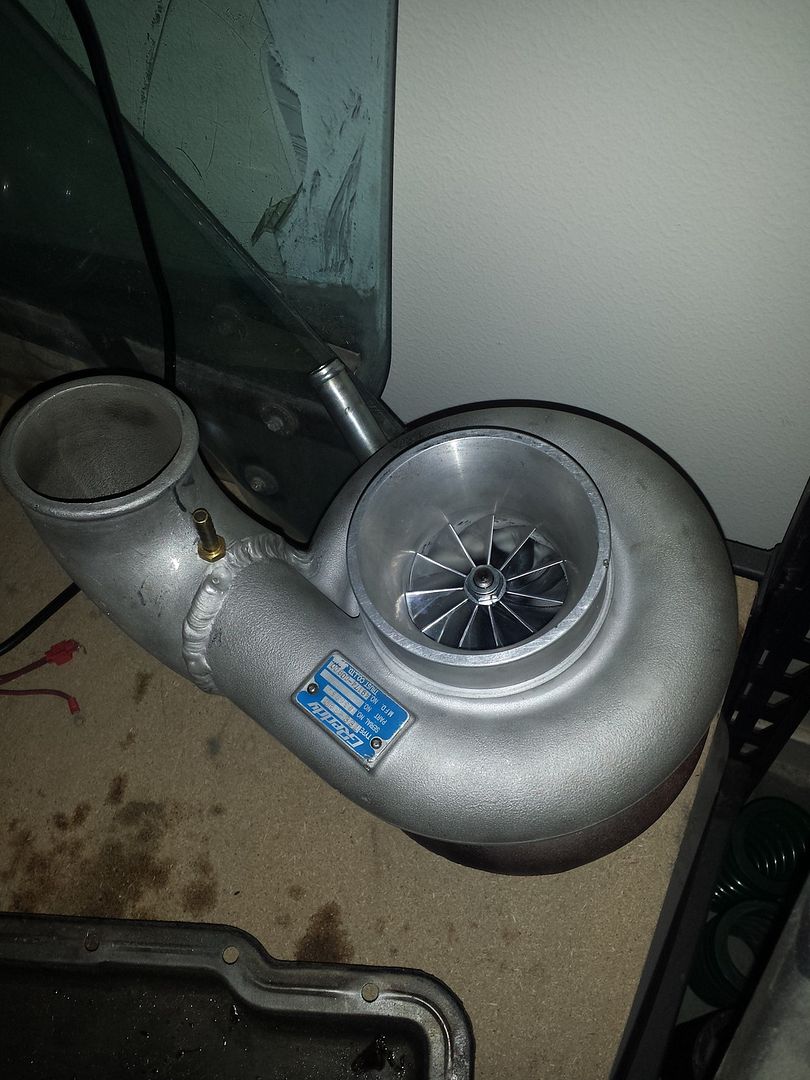

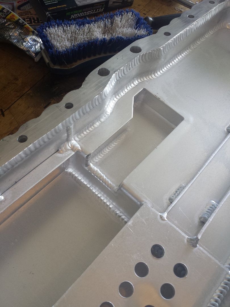

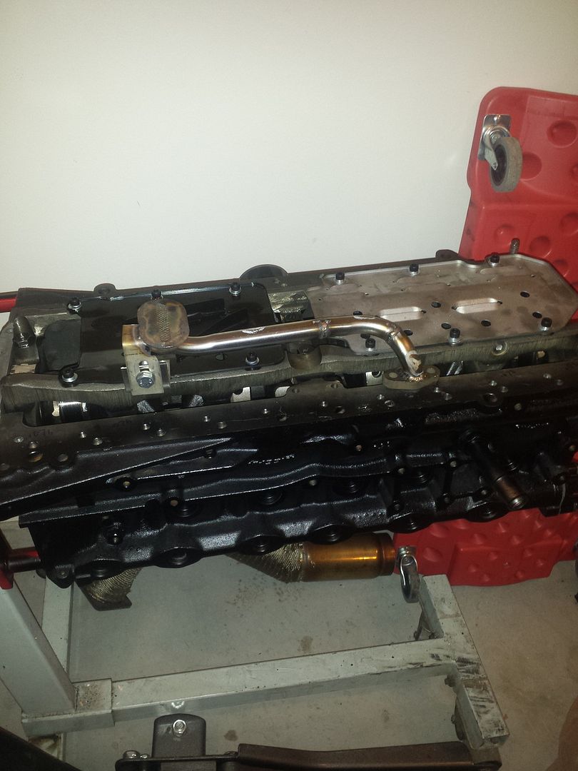

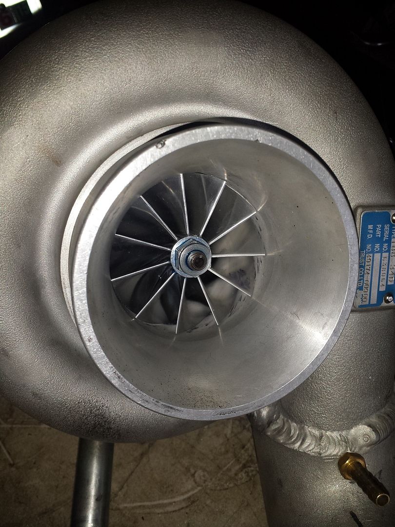

stony Posted March 26, 2015 Author Share Posted March 26, 2015 Well motor is almost back together. Hope to have it fully assembled in a week or 2 and ready to go back in the car. just waiting on rings, Head gasket, and getting head back from machinist after the valve job. The CXracing pan needed a little trimming and the bracket the oil pickup mounts to was way off. BUT it looks like it will hold significantly more oil then the stock rb20 pan i was running before. Also has really good welds and from i can tell some pretty good baffling. New billet wheel in the T88-34D Quote Link to comment Share on other sites More sharing options...

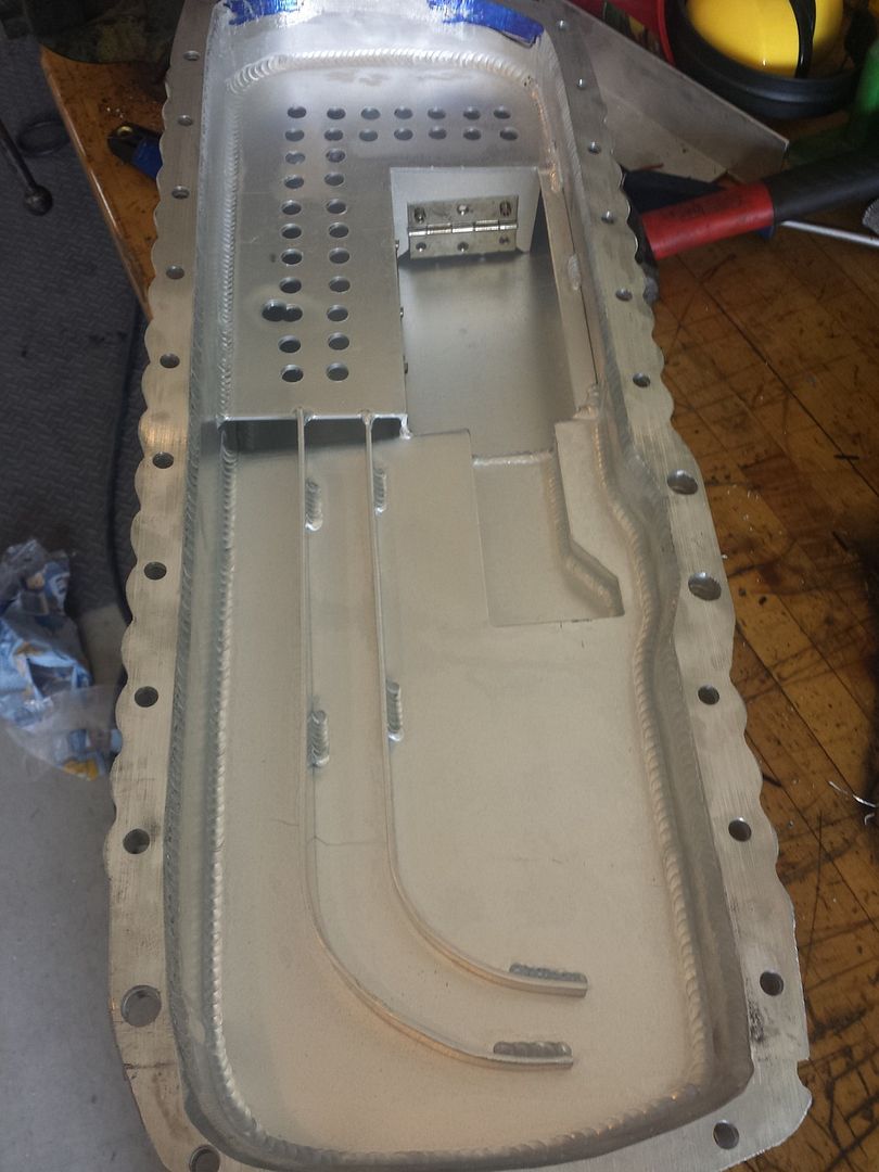

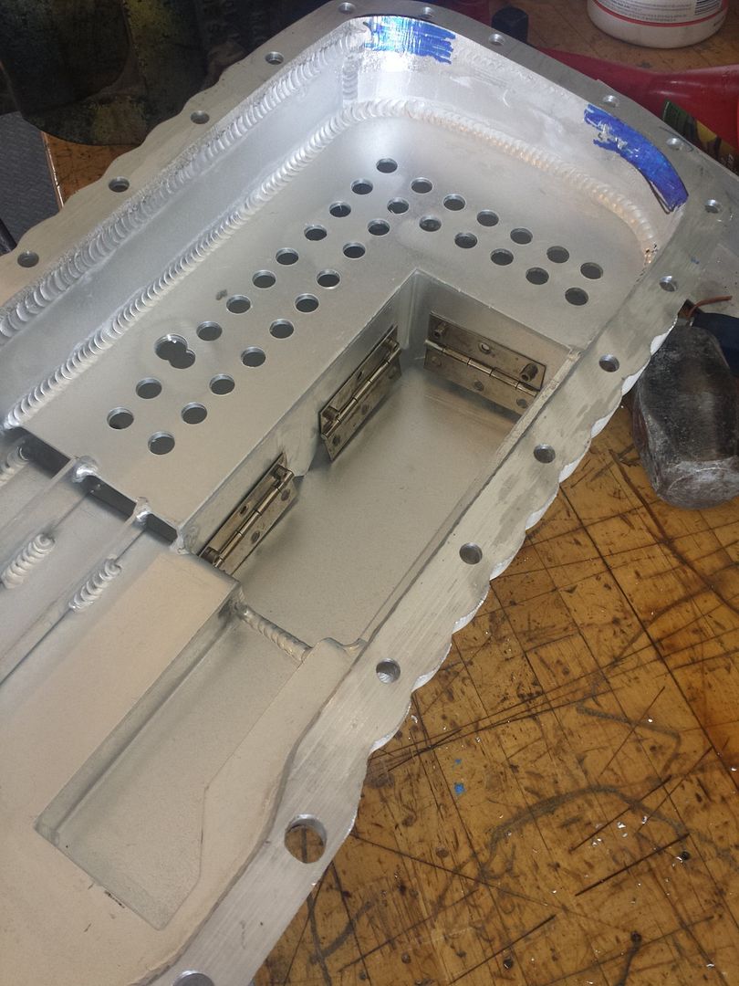

flatrate Posted March 28, 2015 Share Posted March 28, 2015 What's the baffles inside the pan look like? Quote Link to comment Share on other sites More sharing options...
stony Posted March 29, 2015 Author Share Posted March 29, 2015 It looks pretty good. These are being sold on ebay for 449. some of the mount holes have to be enlarged and the girdle had to be shaved a bit for it to fit perfect but pretty decent for the money. Quote Link to comment Share on other sites More sharing options...
stony Posted March 29, 2015 Author Share Posted March 29, 2015 I also had to drill an additional hole for the dipstick so it would go all the way in. Quote Link to comment Share on other sites More sharing options...

slowspeed Posted March 29, 2015 Share Posted March 29, 2015 Nice. How much oil does it hold? Did it come with a pick up tube and a dip stick? Quote Link to comment Share on other sites More sharing options...
stony Posted March 29, 2015 Author Share Posted March 29, 2015 Not sure yet but I'm guessing 6 to 7 quarts Quote Link to comment Share on other sites More sharing options...
