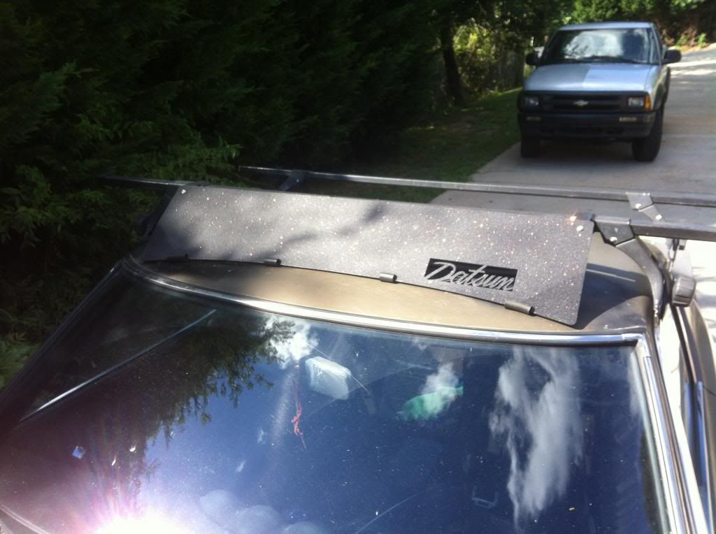

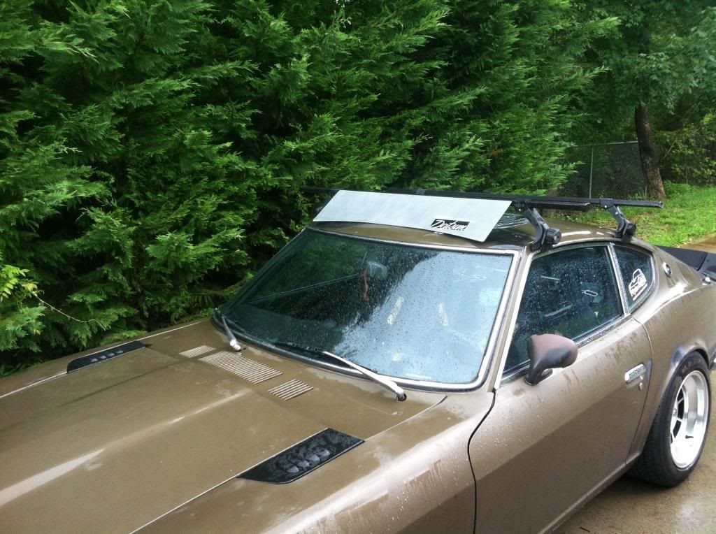

Why get a $500 jeep when you could get a roof rack for $30?! The deflector on the roof rack actually keeps rain from getting under the sunroof when I drive in the rain. So I call it a win win!

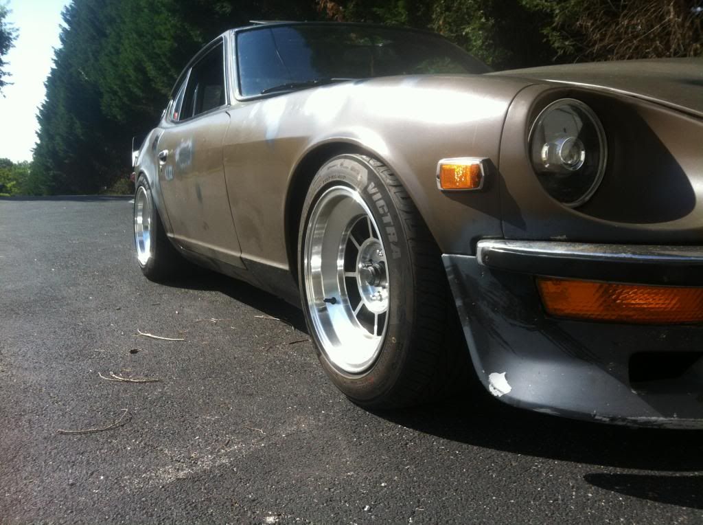

I love the wheels too, when rota started making the more affordable imitation I knew I had to have them!

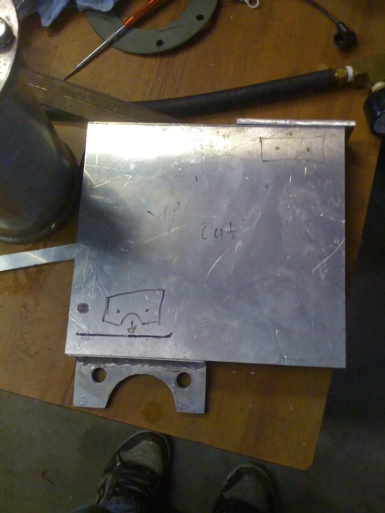

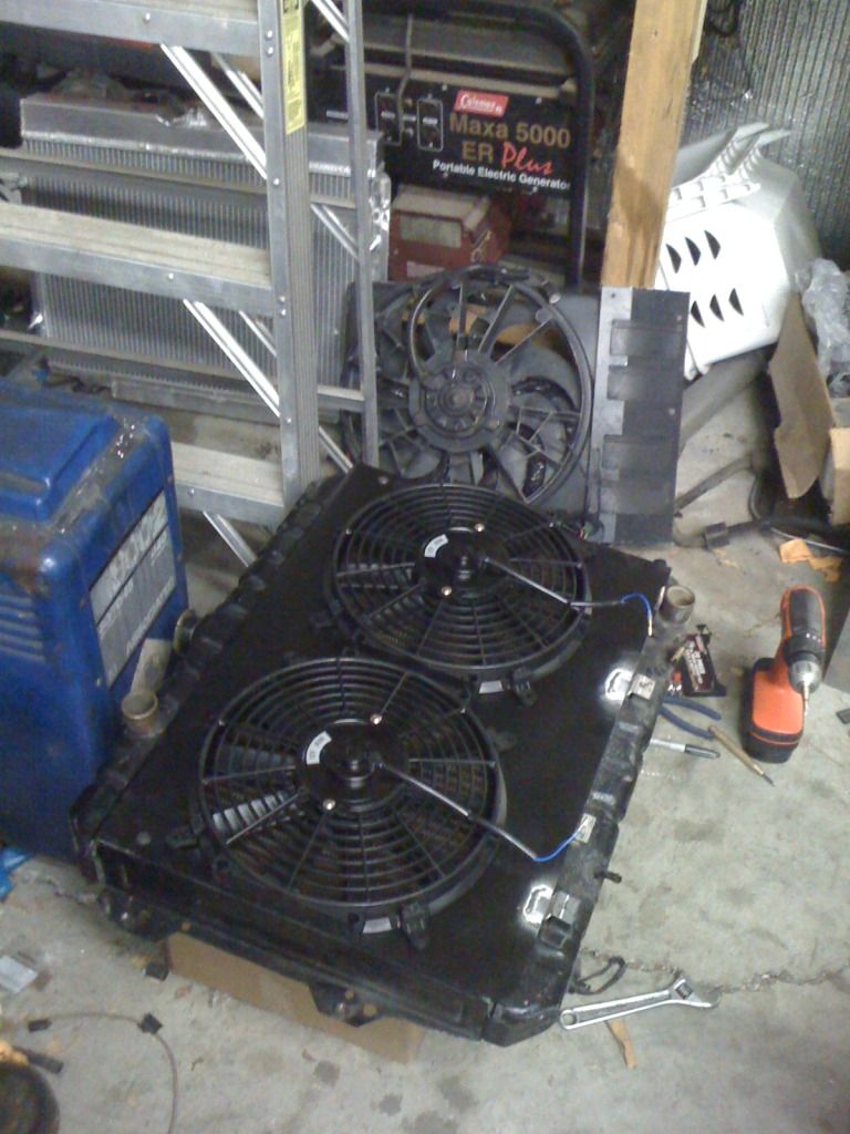

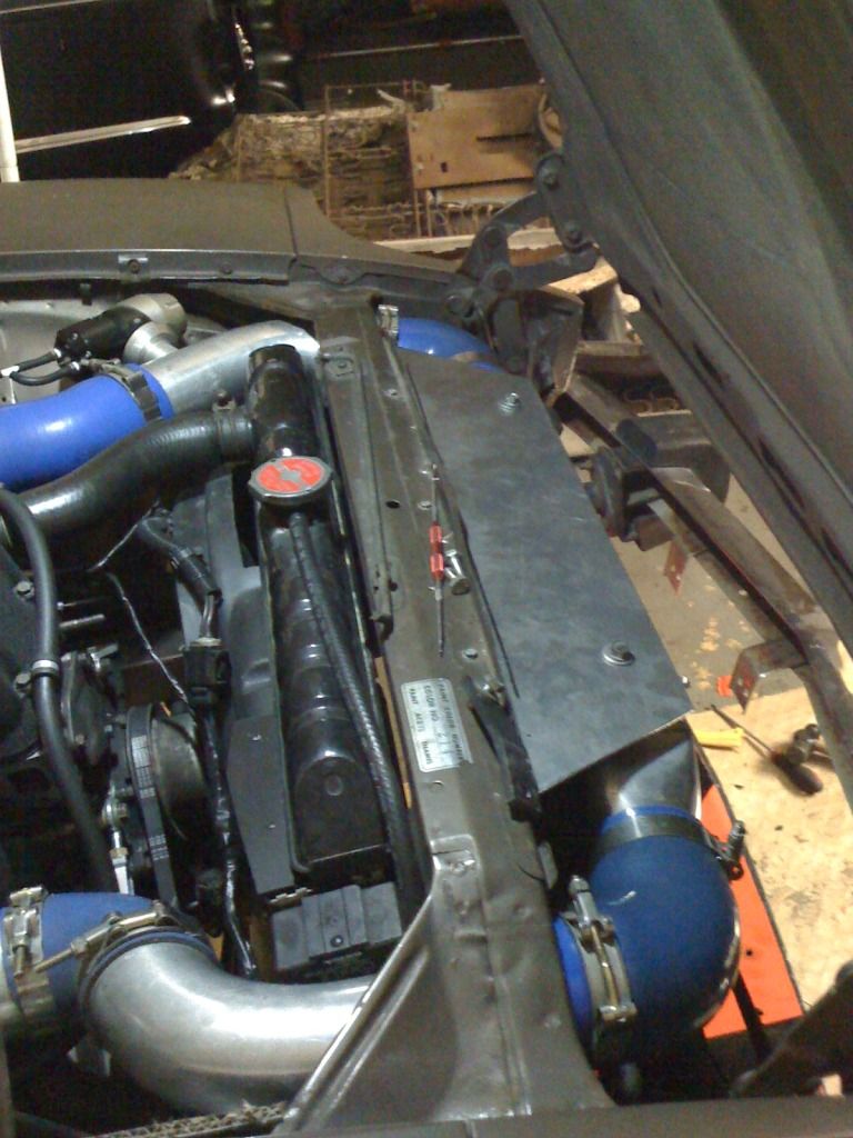

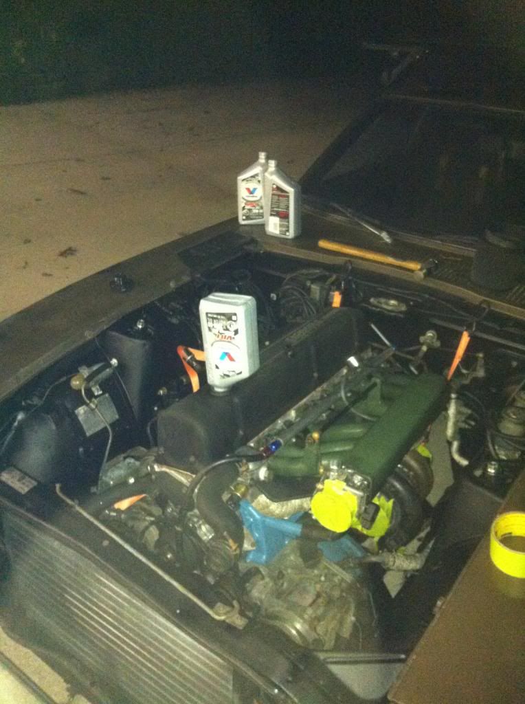

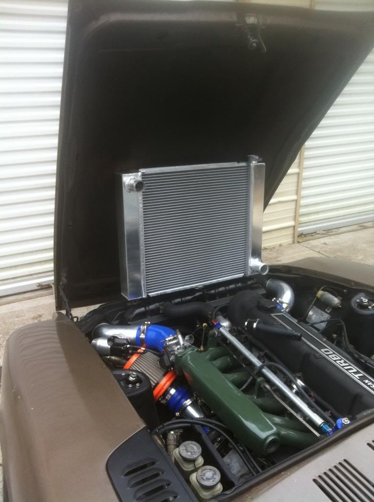

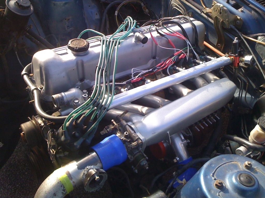

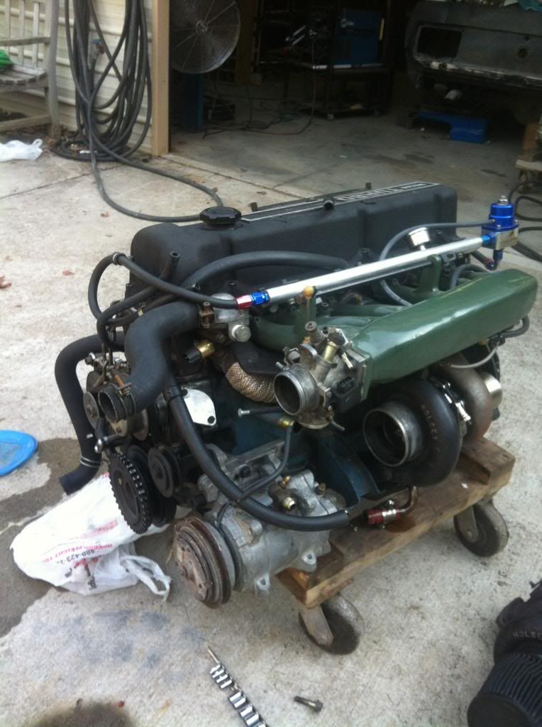

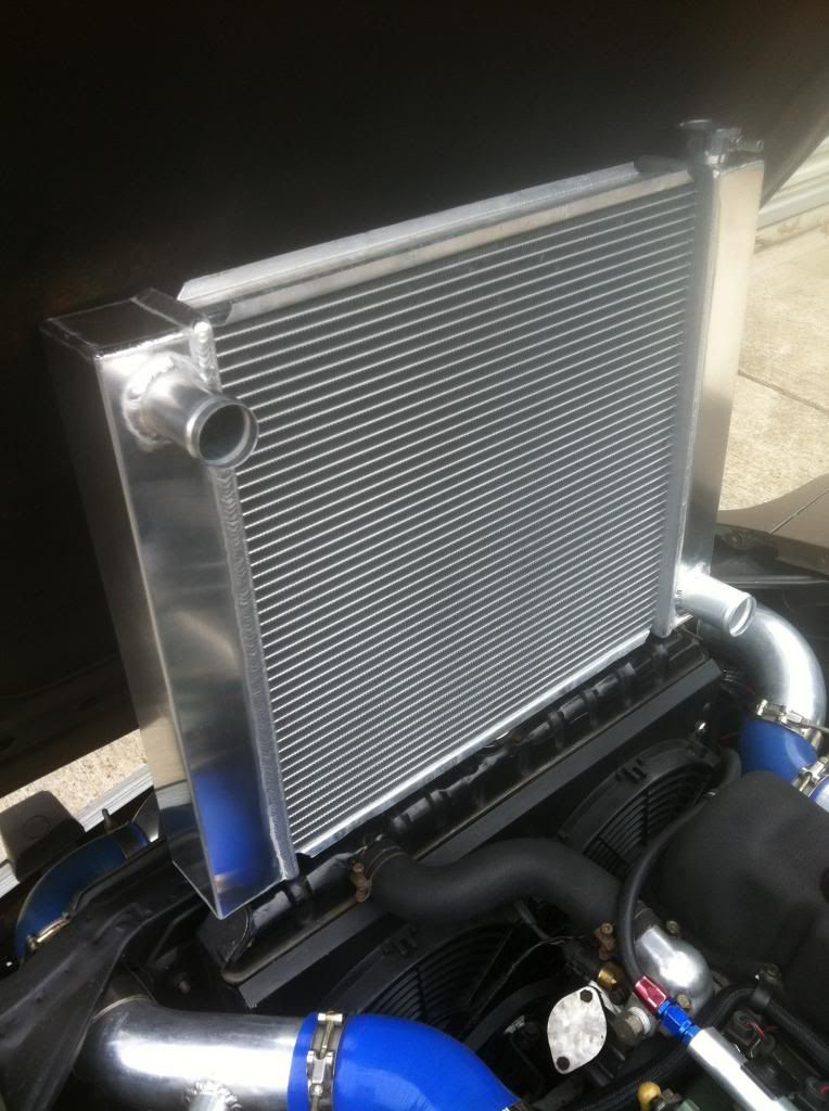

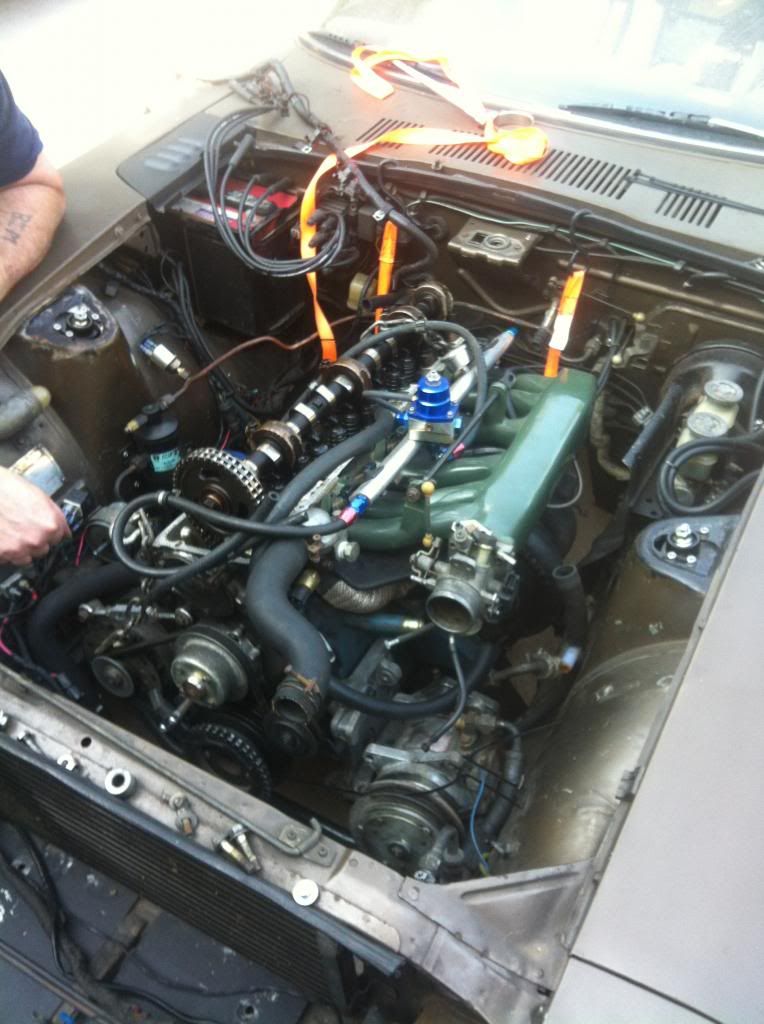

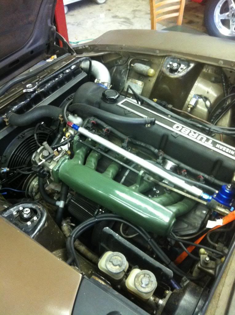

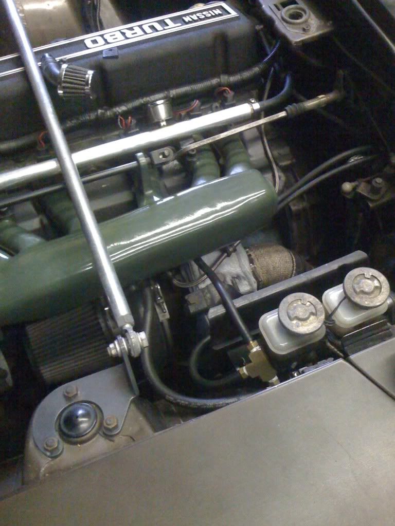

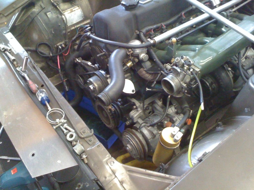

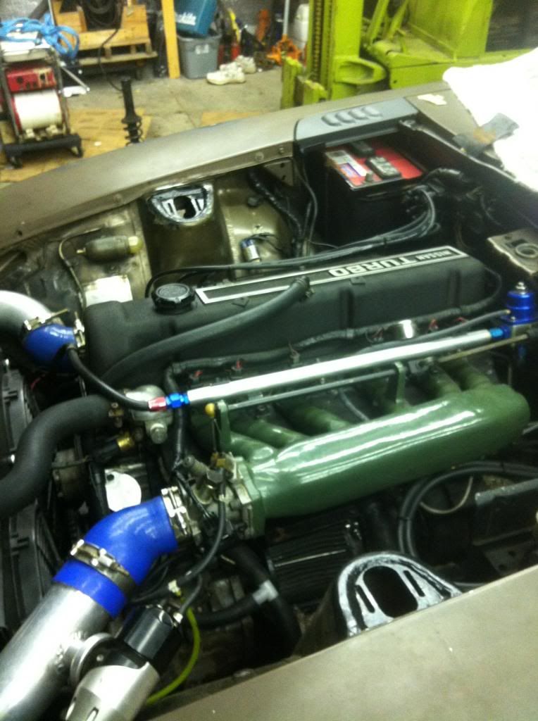

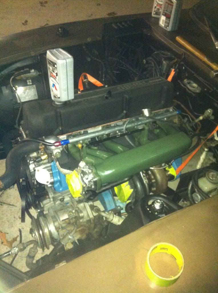

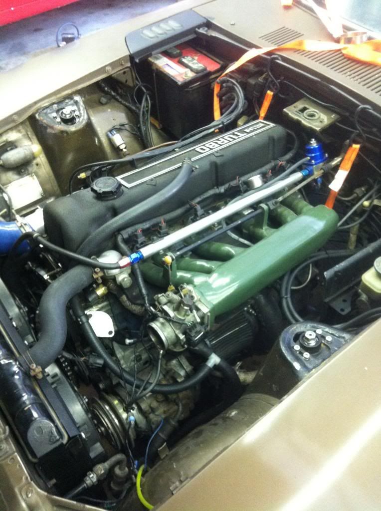

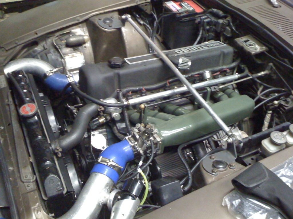

The last update I had mentioned replacing the stock radiator with an aluminum cross flow radiator. I had to make all kinds of modifications to the generic eBay radiator to get it to fit the car. I cut off both the inlet and outlet of the radiator and had to weld a 90 degree section of tubing on both of them to keep from hitting my intercooler piping and the alternator. I also had to fabricate some brackets to hold it in the car. I ditched the twin 12" eBay fans in favor for a Derale 16217 2 speed 17" fan with the new radiator.
You can kind-of see the radiator and fan in the engine bay picture below:

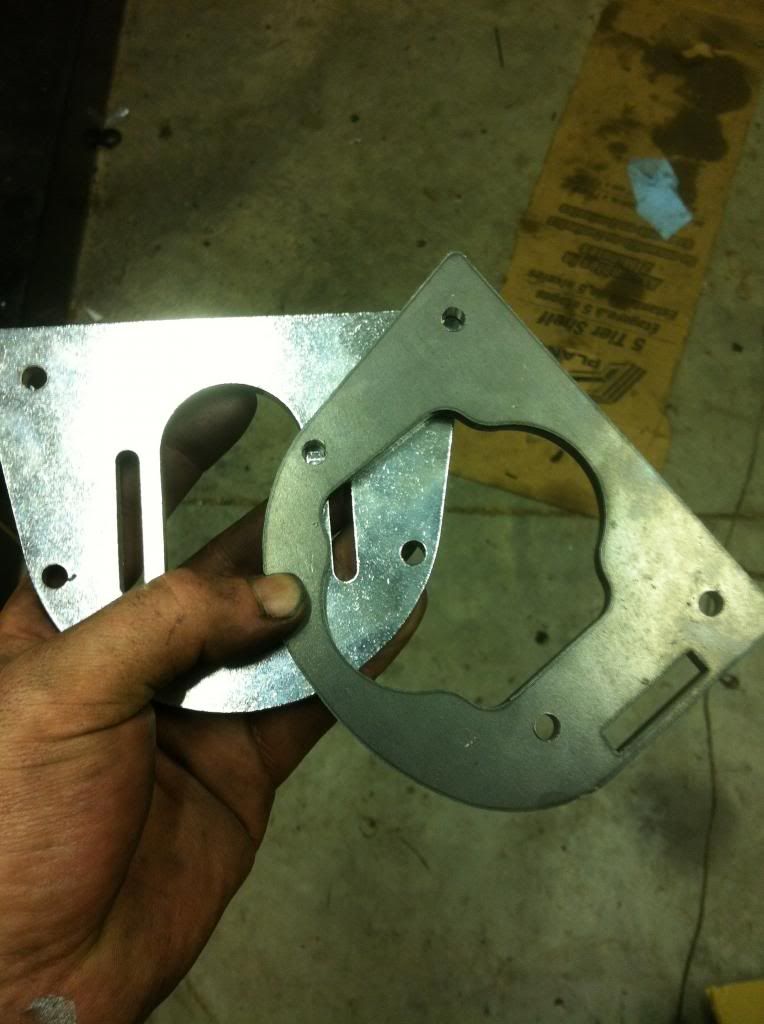

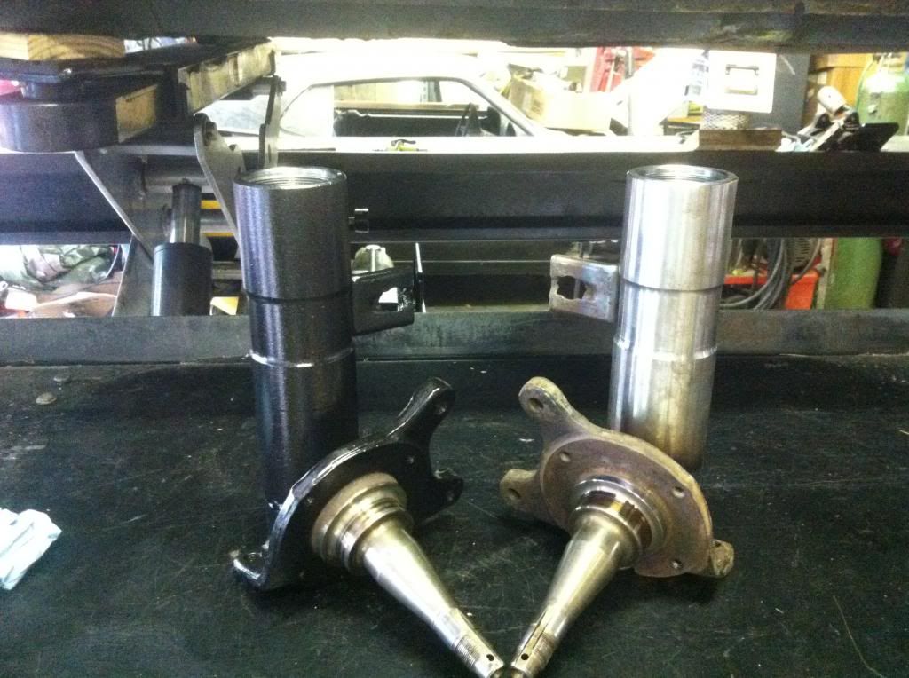

I then had to come up with some way to mount the calipers and rotors to the struts/spindles. I modeled both the front and rear struts and designed mounts for both the Z32 front calipers and the Z31 rear. This pretty much brings me up to date on the car. It is currently sitting in my car port awaiting for me to install the front and rear brakes. I had both the front and rear caliper mounts made, I purchased my rotors and calipers for the front and the rear as well as drilling the rotors to accept the respective 4-lug patterns.
I have tested fitted the front brakes using a spare strut and luckily everything fits and clears the wheels, just barely.

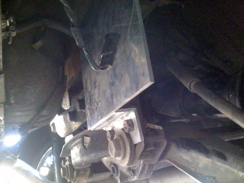

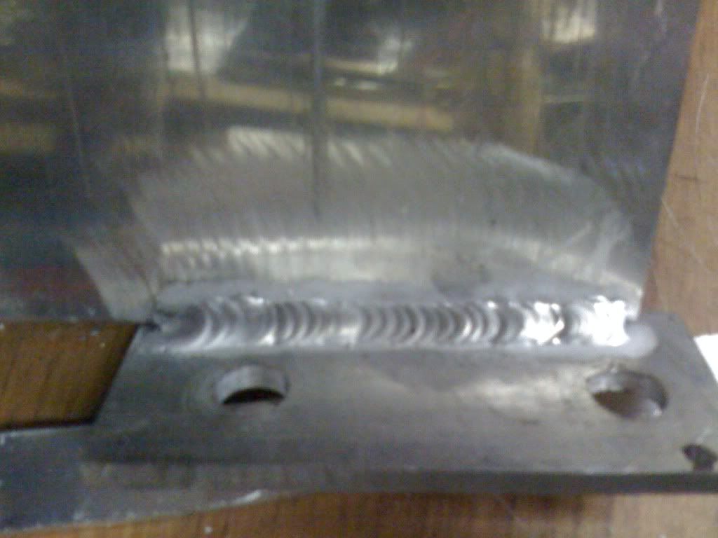

I thought I included a picture or two of the rear mounting point with the pivot.  The pivot is made of 1/4" CRS that was laser cut at the same place I did my CoOp. I attached the mounts to the same location that the factory tow hooks attached to on the front frame rails.
D009A933-4416-49CD-A252-56DF9F76D5D7_zps1isakva5.thumb.jpg.3aa28acb6932ee03a87784958aae8250.jpg
The front cables were made to "pre-load" the front of the splitter and slightly deflect the air dam to get a decent seal along the front edge. The picture above just has the front sat on boxes for mock up, hence the gaps.

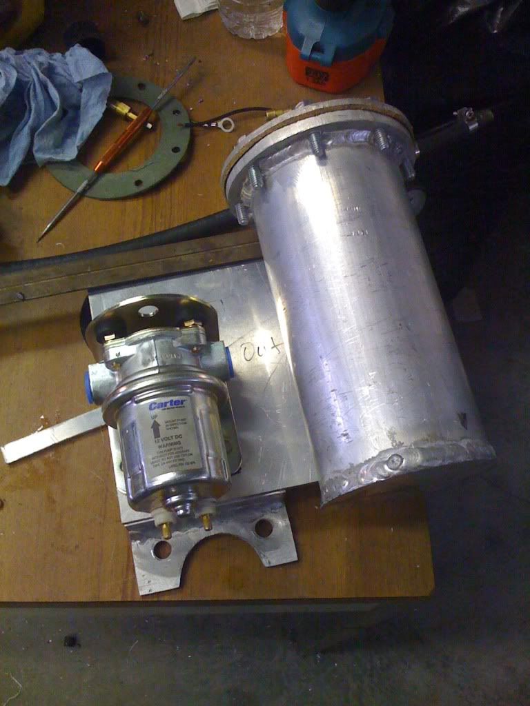

3) Re-installing the surge tank that I made a few years back

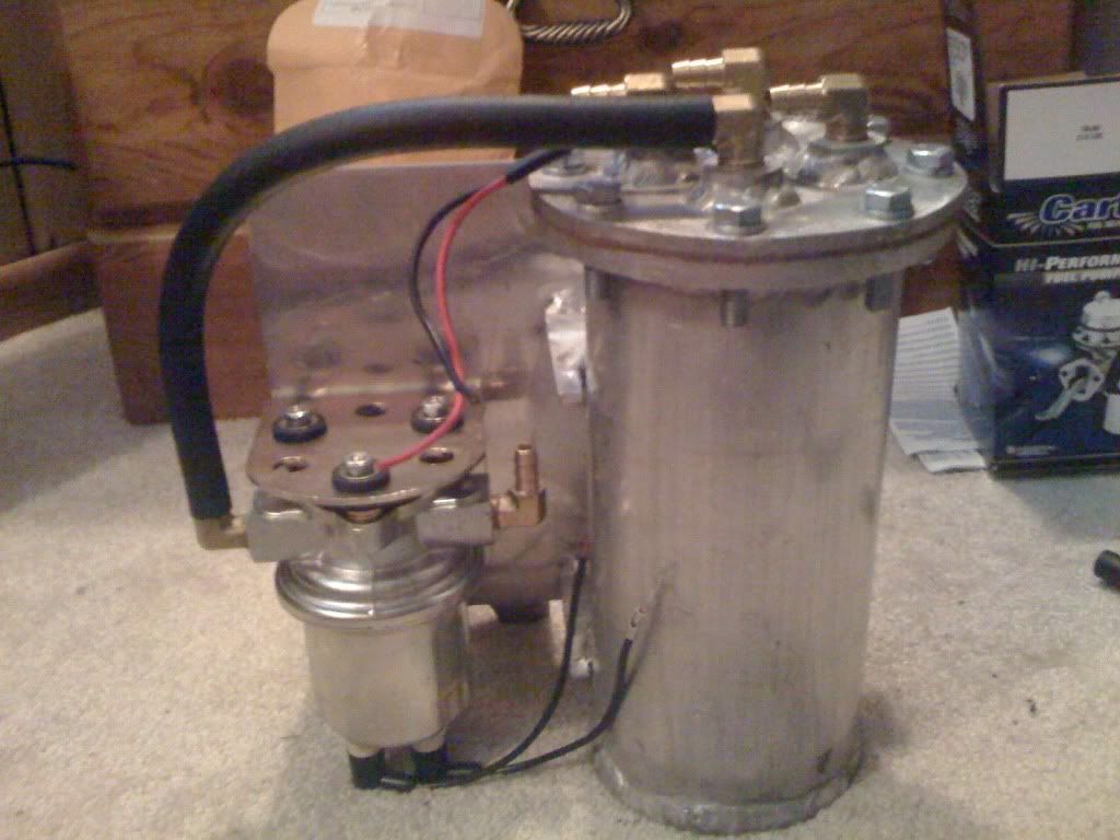

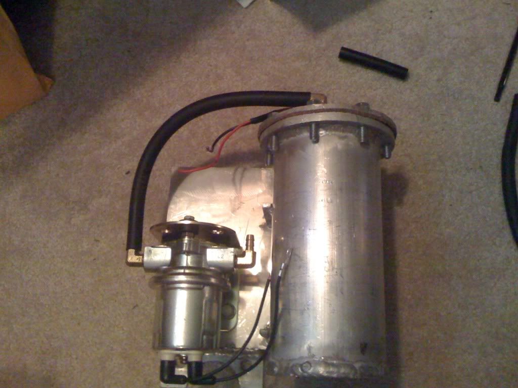

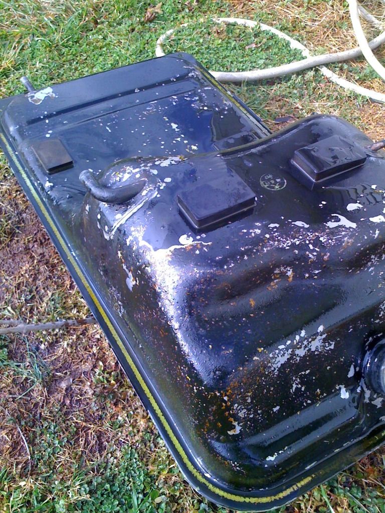

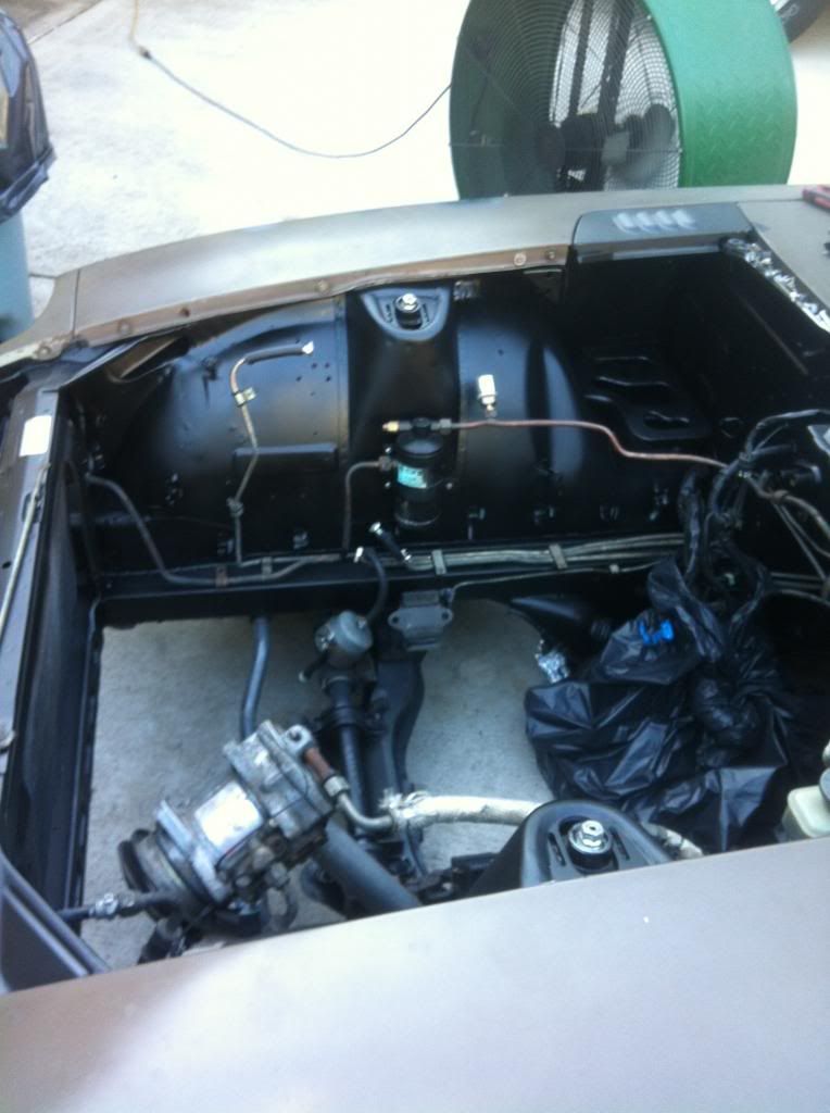

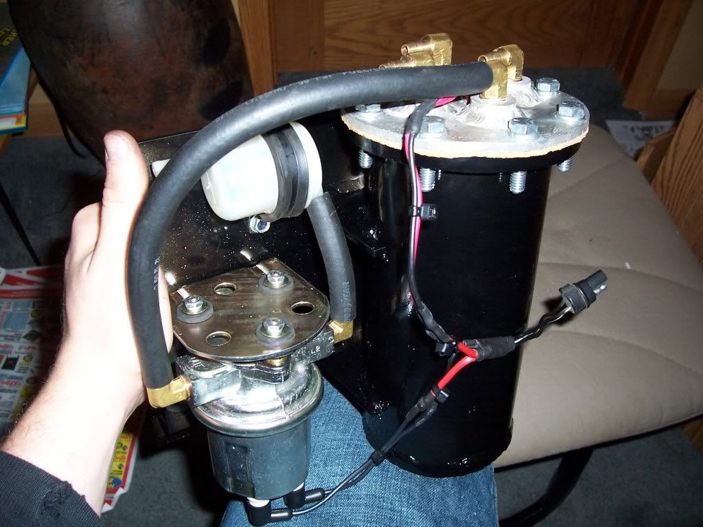

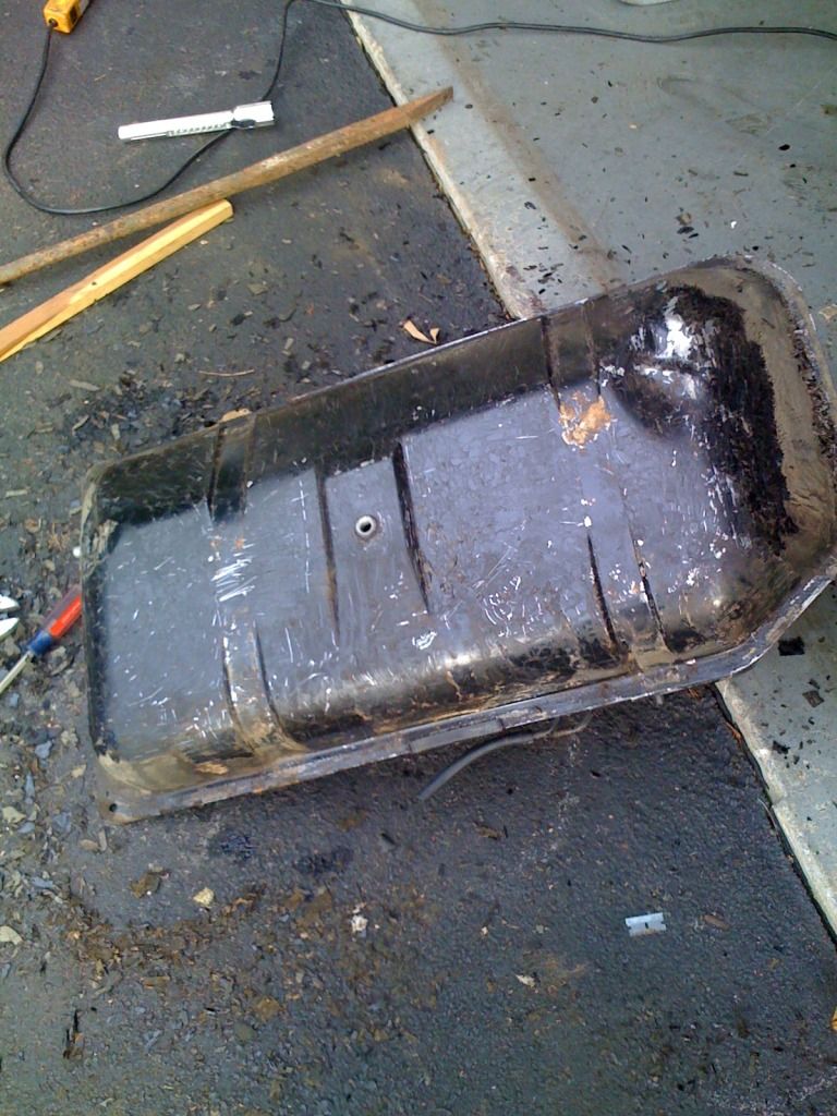

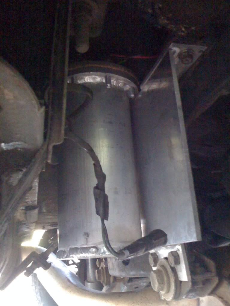

I installed the new to me fuel tank and surge tank this passed weekend. I ran into some issues with the surge tank that ended with a ton of spilled gas. I had originally sealed the hole that the wires for the pump inside the surge tank with JB weld. Apparently JB weld degrades with time and exposure to gasoline, I didn't find this out until the surge tank was filled by the lift pump and the fuel poured out of the top of it. I dropped the surge tank and pulled one hose off to drain a portion of the fuel out before using gas tank repair epoxy on the wire opening. I wasn't able to get to it that evening (due to a dinner date with the wife) so for an extra precaution, I placed vice grips on the tank supply line to keep the fuel from siphoning out of the tank and into the surge tank. Apparently I didn't clamp it tight enough, I returned from dinner to find a river of 93 octane gas running out of the car port and into the drive way. DOH. I re positioned the vice grips and it quit leaking, thankfully. I put some epoxy on the wire opening the next morning and all was well again.
I got the chance to take the car down the road briefly and found out that I need to clearance the front calipers a bit.They were making a terrible racket rubbing against the front wheels. I need to fab up ebrake brackets for the rear calipers to completely finish the conversion. I also need to re-bleed the brakes the peddle is very mushy.

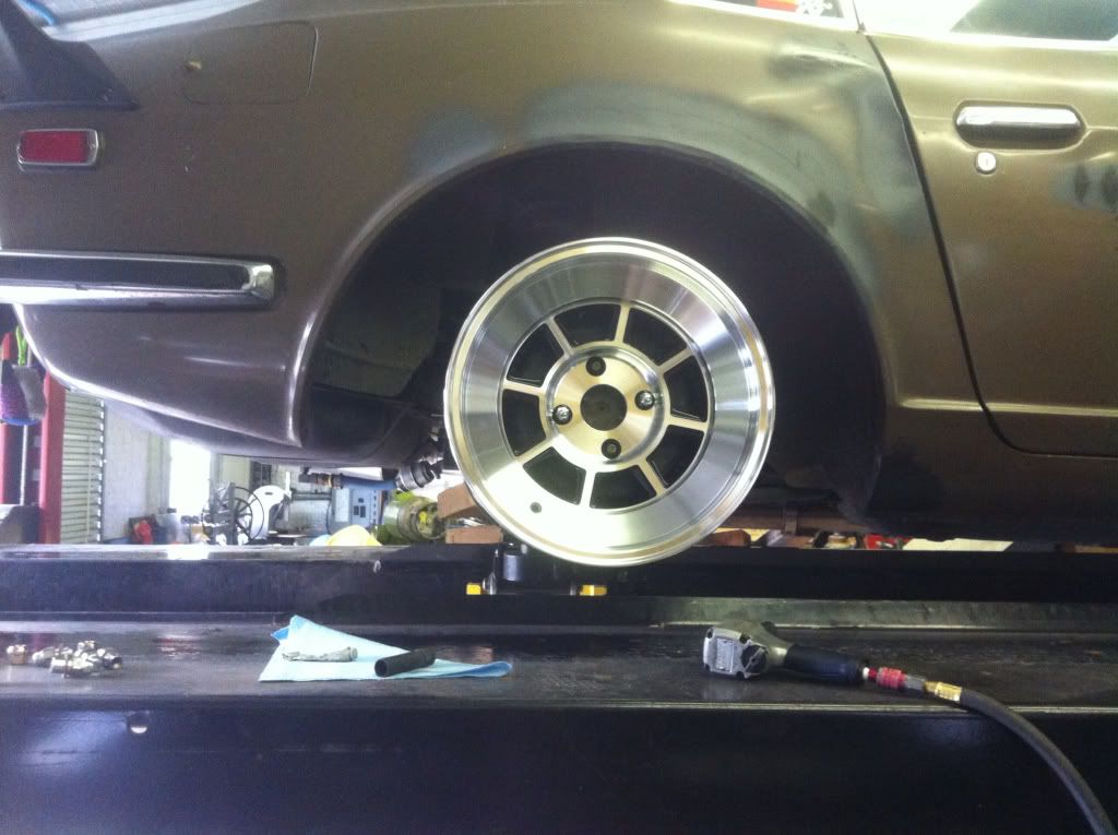

I don't trust tire shops raising/taking the wheels off of the car so I decided to take a trip to my dad's shop to put the car on the lift, remove the wheels, and take the tires to be mounted. The only issue was I had no way to get the car and the tires to the shop without a huge logistics nightmare. So, I made use of that awesome roof rack I purchased several years back. I loaded all 4 tires across the roof rack and strapped them down tightly so there was no chance of a tire escaping during the 15min drive to dad's. I thought it looked freaking awesome but I got a ton of odd looks and stares driving down the road. Got to dad's and the got tires mounted and the wheels back on the car just a week before Zdayz.

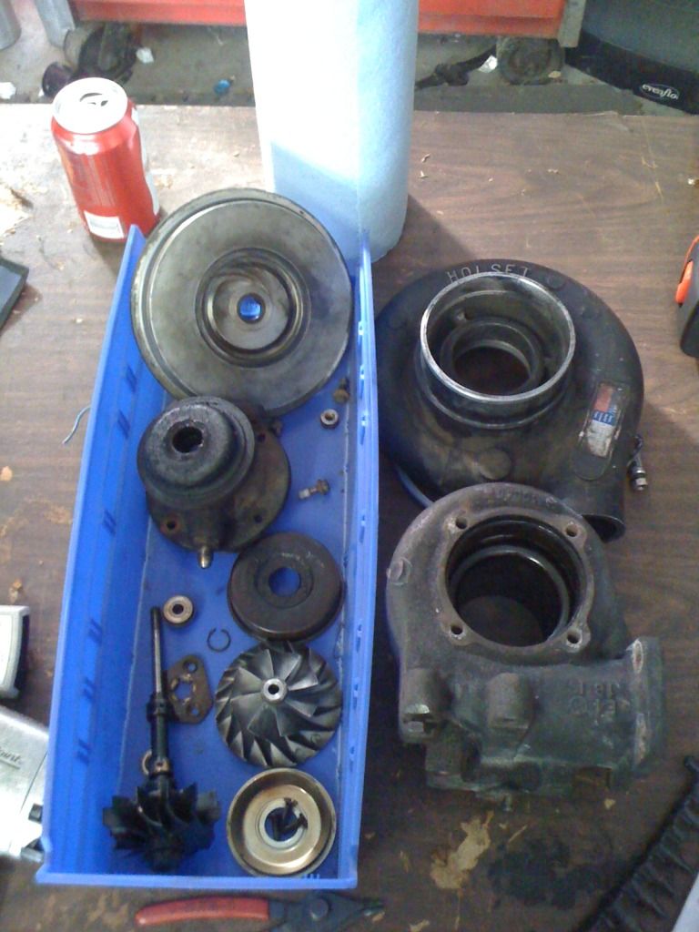

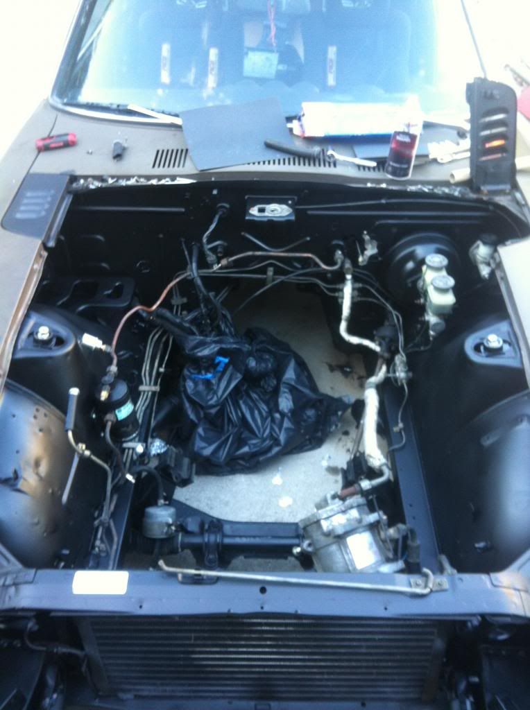

I completed the marked out items before going to Zdayz, which left numbers 4 and 5 on my list. I decided to start tearing the engine bay apart after I got back from Zdayz with the deadline of taking the car to the Cars and Coffee event that is put on three times a year here in Knoxville. I started by tearing the intake and exhaust manifolds off along with the connected components.
You can see how tattered and worn the old heat wrap was on the exhaust manifold and how rusty the exhaust housing has gotten. The valve cover paint had also been wrecked by the freaking rats defecating and urinating on it. So, I pulled the intake manifold first and the turbo, down pipe, and exhaust manifold followed.
I started with the down pipe and turbo first. Everything got a thorough inspection for anything out of the ordinary like wear or cracking. This was followed up by a deep cleaning and fresh 1200 degree high temp flat black grill paint. Once everything was painted, it got a liberal wrapping in DEI Titanium "header" wrap. The turbo exhaust housing also was treated to a matching "lava" turbo blanket.
This picture also shows how I added the external wastegate to the factory exhaust manifold.

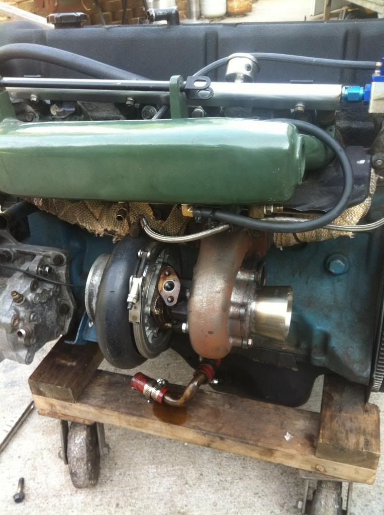

The intake manifold got a thorough cleaning as well. The heat shield was repainted in the same flat black grill paint and the underside of the heat shield and intake manifold received a fiberglass mat/ silver reflective heat barrier to try and repel the heat from the exhaust manifold. I also added DEI heat tape to the fuel injector bodies as well as adding reflective heat blankets that wrapped around the injectors. I actually did alot of research into the fuel vapor lock situation that plagues these cars and found that the 4.0L Jeep L6 has the same problems. I found numerous posts on the Jeep forums referring people to wrap their injectors in heat tape and urging people to purchase the "injector blankets" to solve the heat soak issue. I figured for the price I would be more than willing to give it a try and see if it solves my hot start problems.
I also got tired of destroying wastegate diaphragm on my eBay wastegate and went ahead and installed the Tial piece I've had on the shelf for the past few years.
Last but not least I repainted my valve cover in wrinkle black and put everything back together.
