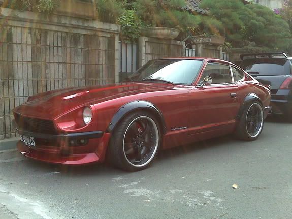

signal34 Posted March 1, 2009 Share Posted March 1, 2009 This is the only front air dam that I have seen that flows into the ZG flares and it's a custom build. I would also love to find one that could blend into the front flares. Quote Link to comment Share on other sites More sharing options...
260zturbo Posted March 1, 2009 Share Posted March 1, 2009 wow thats a very hott ^ Quote Link to comment Share on other sites More sharing options...
280z4me2 Posted March 2, 2009 Author Share Posted March 2, 2009 What body kit is that? Quote Link to comment Share on other sites More sharing options...
MJLamberson Posted March 2, 2009 Share Posted March 2, 2009 custom Quote Link to comment Share on other sites More sharing options...

LS240 Posted March 6, 2009 Share Posted March 6, 2009 You could maybe try to get a Reaction Research Subtle Z front bumper to work. They have that little side molding piece like the custom bumper above, which would give you a good start to work with but probably still require some modification to fit snug to a ZG flare. Quote Link to comment Share on other sites More sharing options...
