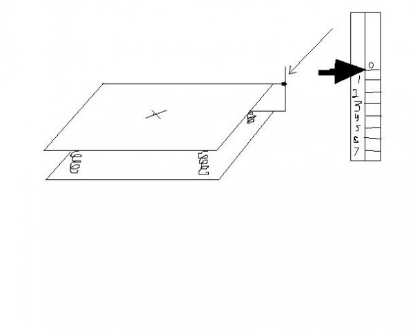

Challenger Posted March 4, 2009 Share Posted March 4, 2009 What do you mean no one cares? Just make your own. Find a spring or springs that advertise a spring constant. Set up your platform and then measure the displacement. (m)(9.8)=(spring constant)(displacement) Add together the springs if you use more then one. x(k+k+k+k) 4 springs with same "strength". You can make something as simple as this drawing. Maybe make a "runner" (rod inside a tube?) in the middle to prevent the scale from tilting from side to side. Quote Link to comment Share on other sites More sharing options...

Challenger Posted March 4, 2009 Share Posted March 4, 2009 Well you couldnt use my design for a car, but engine blocks/transmissions are doable. Quote Link to comment Share on other sites More sharing options...
