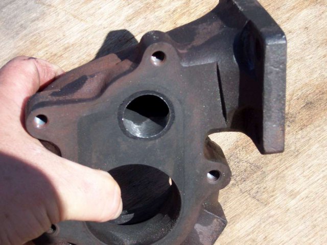

Noddle Posted March 17, 2009 Share Posted March 17, 2009 Hi, I'm have problems with over boosting, so I put my 7psi actuator on today because my other one was a 10psi with a external spring to help reduce the psi, hoping to stop it over boosting (12psi), but it didn't make any difference. So in my testing I left the waste gate open (unconnected from the flapper arm), PSI started to build a 4k, at 5k it hit 10psi, I lifted my foot when it hit 12psi, so to me this means the waste gate is not letting enough exhaust out through the wategate., So I believe I need to open the hole (in the wastegate), but what I need to know is how much meat the little flapper needs to seal, and for it no to burn through. Note: wategate is in the turbo if I didn't make it clear. Nigel Quote Link to comment Share on other sites More sharing options...

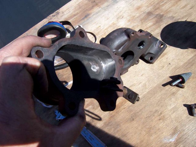

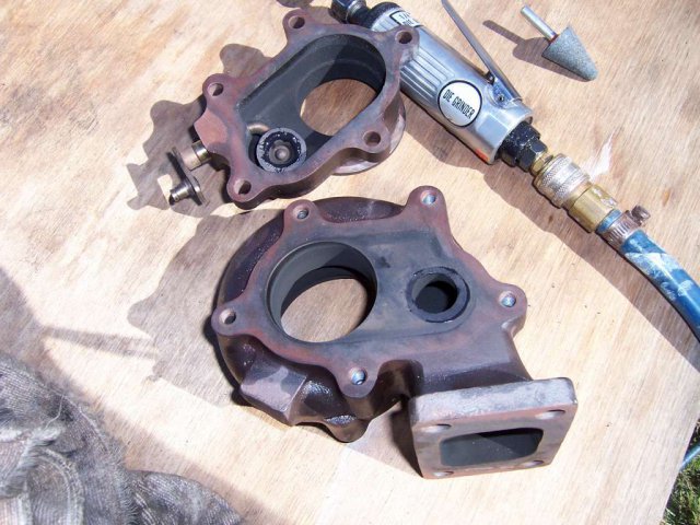

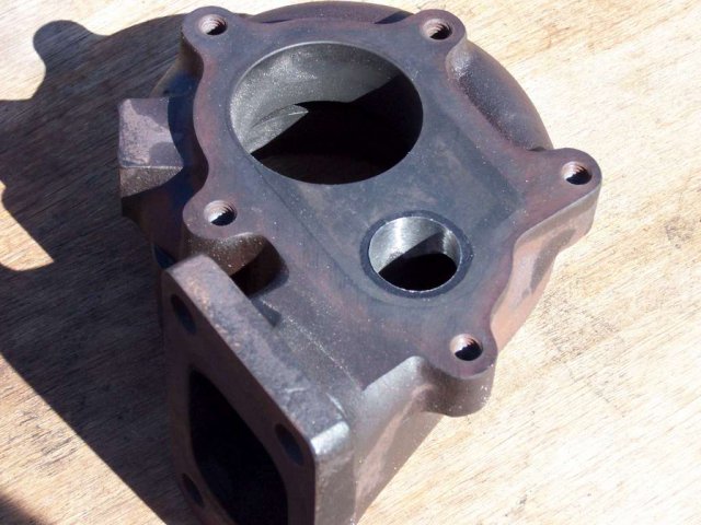

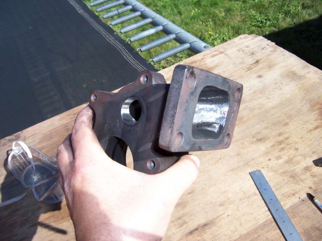

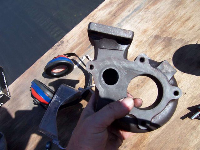

Noddle Posted March 21, 2009 Author Share Posted March 21, 2009 Hi, I did some work on my wastegate this afternoon, but it looks like there just not enough material to remove to fix the issue.. 7psi up to 5K, 12 psi by 5.5-6K Nigel Quote Link to comment Share on other sites More sharing options...

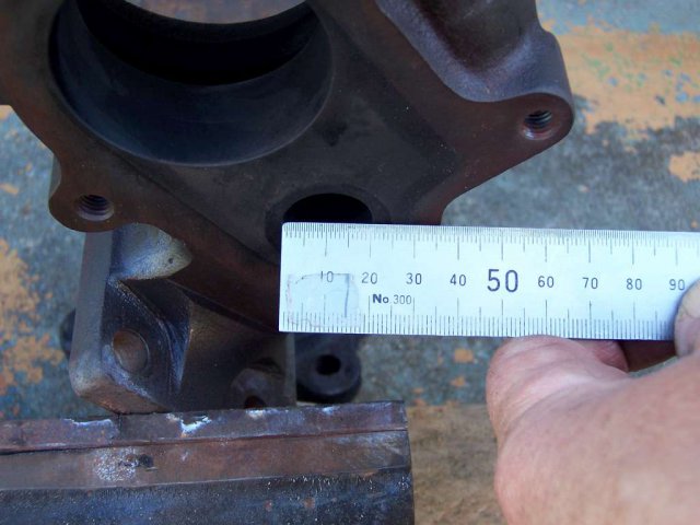

rossman Posted April 5, 2009 Share Posted April 5, 2009 Curious, what size is your wastegate port before and after? Also keep in mind that the wastegate housing also affects amount of flow that is bypassing the turbine. You could make the hole 2" but if the housing is too restrictive it won't do much good. If you want to keep the internal wastegate you might consider a larger more tapered exhaust collector. I have an ATP "Ultimate" Internal Wastegate. It's not running yet but hopefully it and the slightly over 1" wastegate port will flow enough to prevent boost creep. Quote Link to comment Share on other sites More sharing options...

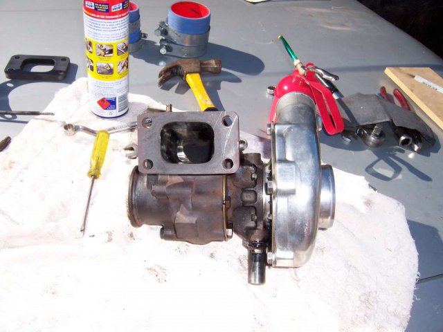

Noddle Posted April 6, 2009 Author Share Posted April 6, 2009 Curious, what size is your wastegate port before and after? Also keep in mind that the wastegate housing also affects amount of flow that is bypassing the turbine. You could make the hole 2" but if the housing is too restrictive it won't do much good. If you want to keep the internal wastegate you might consider a larger more tapered exhaust collector. I have an ATP "Ultimate" Internal Wastegate. It's not running yet but hopefully it and the slightly over 1" wastegate port will flow enough to prevent boost creep. Hi, The original hole was 20mm, I open it up to about 24mm as for the housings, the first picture ( above ) shows the type of housing it is, it's about 1 inch deep At the moment, I'm fitting my intercooler, I will run the 10psi actuator, and see how it goes. Nigel Quote Link to comment Share on other sites More sharing options...
