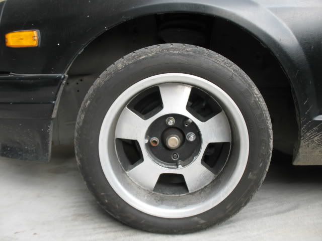

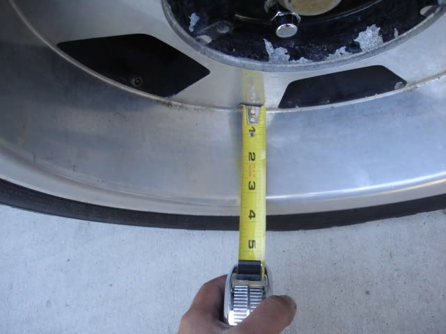

jmak Posted March 23, 2009 Share Posted March 23, 2009 lol we're running on 15x8 -30mm offset with 205/50/15 tires. haha hella deep dish. planning on lowering but we're looking around for good coilover setup. heres pix. Quote Link to comment Share on other sites More sharing options...
auxilary Posted March 24, 2009 Share Posted March 24, 2009 that's not hte right way of measuring depth though, because you're measuring from the spoke. put a flat board on back side of hte rim, and measure the distance between the board and the surface that's going flat against the hub, and that's your backspacing Quote Link to comment Share on other sites More sharing options...
jmak Posted March 24, 2009 Share Posted March 24, 2009 that's not hte right way of measuring depth though, because you're measuring from the spoke. put a flat board on back side of hte rim, and measure the distance between the board and the surface that's going flat against the hub, and that's your backspacing oh i know. im just showing how deep the lip is. the wheels specs are exactly what were ordered as. 15x8 with a -30 offset. when we lower the car, we're looking into new rims cus we know we will have poke and rub so about the same as evergreen planning to get some 16x8 with +10 offset Quote Link to comment Share on other sites More sharing options...
