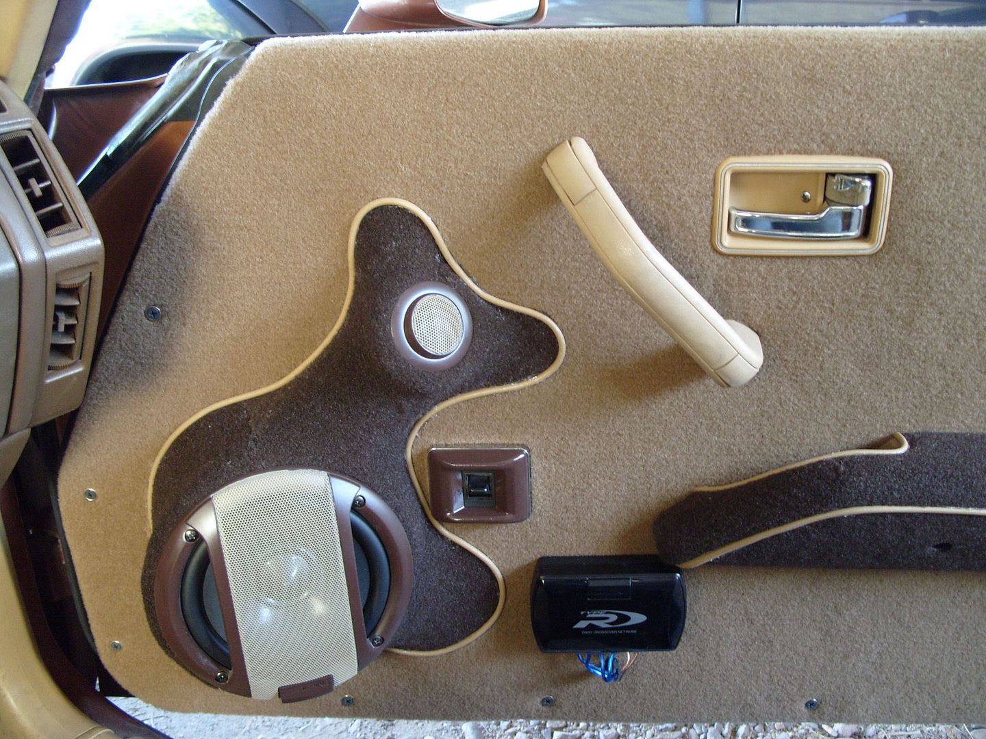

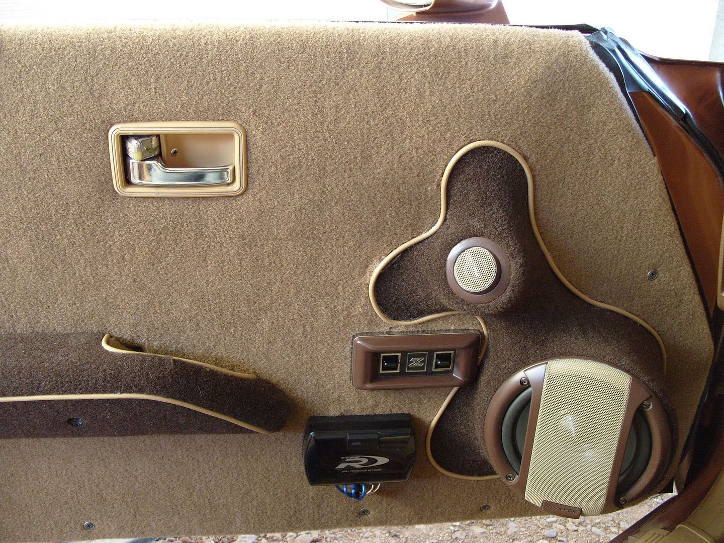

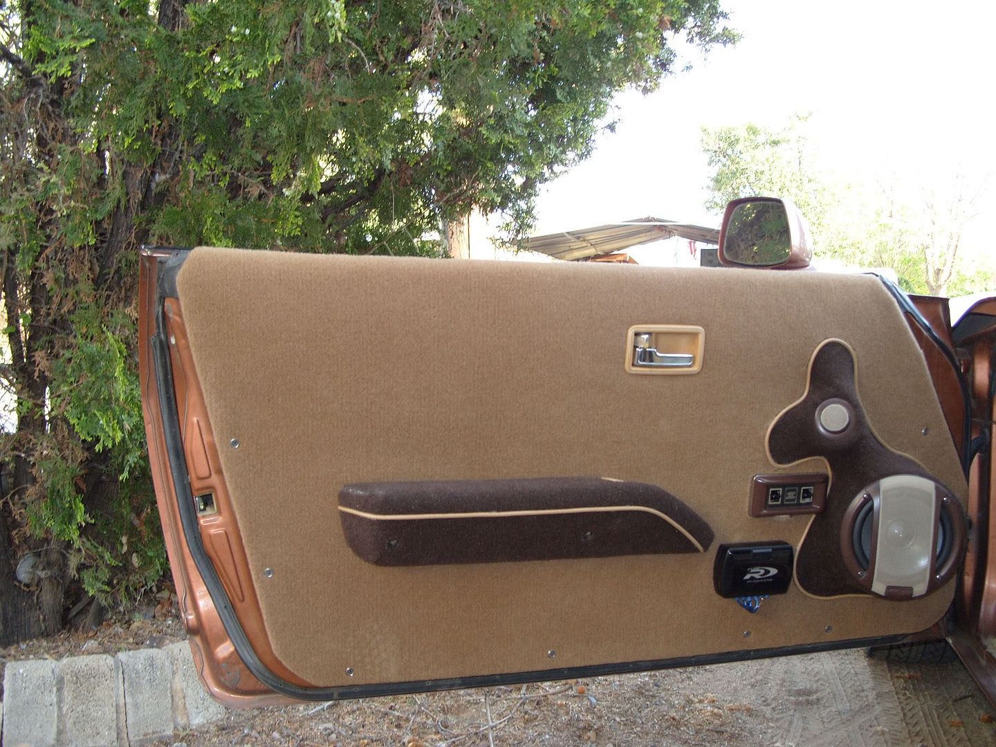

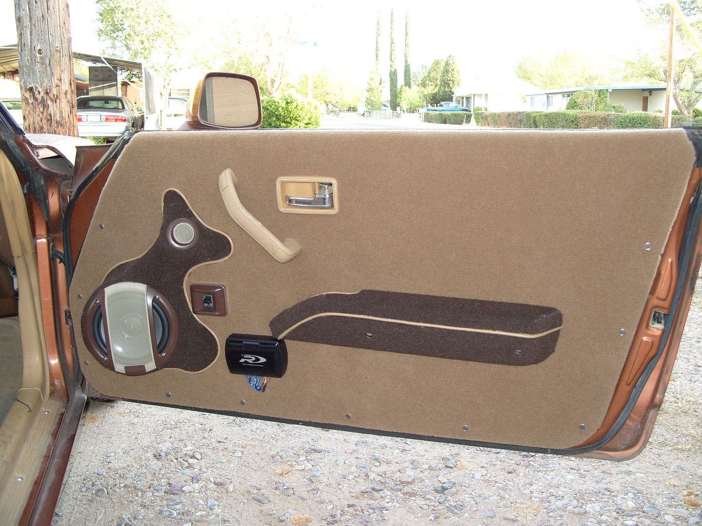

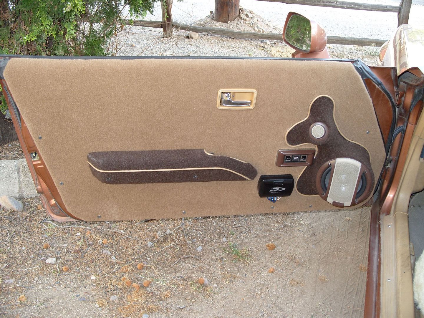

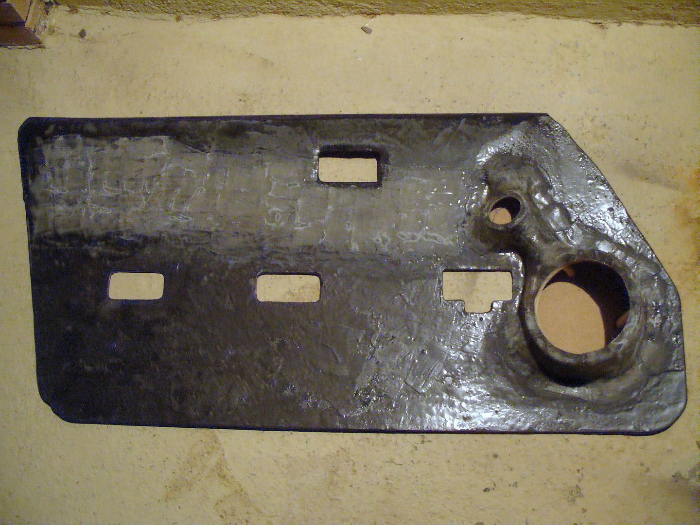

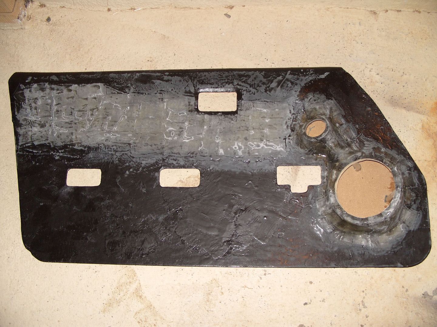

tommyboy Posted April 14, 2009 Author Share Posted April 14, 2009 Hey guys, I FINALLY finished my door panels. Werll, I told ya I'd take some pics when I got done, so here they are. These were taken after I made the holes for my speakers and reinforced the door where the fiber board is riveted onto the metal hanger. And these are the finished products. I carpeted them after I fiberglassed because I felt that it went better with the rest of the interior of my car rather than using bondo and painting them smooth. ENJOY!!! Quote Link to comment Share on other sites More sharing options...

tommyboy Posted April 15, 2009 Author Share Posted April 15, 2009 Thankx guys. As an update to my previous questions about the inner door "fuzzies", I got the answer I needed when I mounted the panels onto the doors. With the panels carpeted, you can't put the inner door chrome trim on because it interferes with the windoiws rolling up and down. However, the GOOD thing about not installing them on a carpeted panel is that the carpet itself acts as a inner door "fuzzy" trim, lining up with the window perfectly, and also giving the panel a more "streamlined" look. Again, THANKX A LOT for all of the help and input guys!!!!!!! Quote Link to comment Share on other sites More sharing options...
