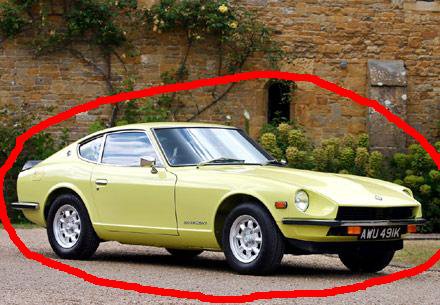

LowCarbZ Posted April 4, 2009 Share Posted April 4, 2009 I've circled anything you should check in red: In all seriousness though, below the battery tray, around the "frame" (for lack of a better word) rails, where the front sway bar mounts into the rails, typical floors/trunk. Check the inner fender sides under the hood and in the wheelwell. Sometimes they rust as the two skins of metal are close together below the strut mounting locations. The front strut rod support mounting locations as well. Other than that just the usual spots you'd look on any car. But be realistic, it's a 35 year old car. As with any old vehicle the potential for it needing metal work is high. And if he's not ok with you lifting carpets and taking things apart, find a different seller. It's your money, and cars are a shitty investment. Quote Link to comment Share on other sites More sharing options...
