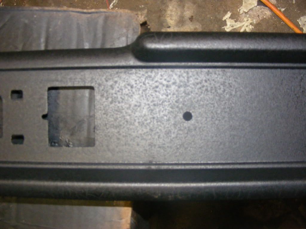

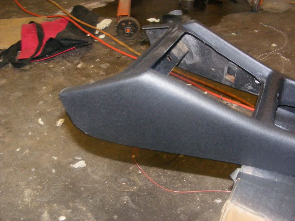

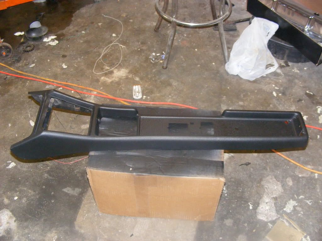

240z8 Posted March 4, 2010 Author Share Posted March 4, 2010 I did a little more with the new car. I sanded the center console lightly and did a couple coats of Rustoleum Bedliner on it and overall it came out good. When you apply it in extremely small coats it comes out great, but if you put it on like normal spray paint, it will bunch up and become like bedliner I guess. I only had one section that didn't come out the way I wanted it to but it doesn't look bad at all. Here are some pics. Here's the section that didn't come out perfect: And here's the texture everywhere else. It is pretty smooth and it looks good. I also threw the car on jack stands to pull the wheels. Since the tires are good, I might get them swapped to the 5 slot mags that I polished and cleaned up so I can clean up the iron cross wheels. I took a power washer to the entire car just to clean it, then I sanded down the driver's side to steel, and primered the side. I'll probably do the rest of the car during the next week or two. I found very minimal body damage. There are some very shallow dings in the fender, on top and on the sides, the wheel arches are pushed in a bit, and there is a little bondo underneath the side marker in the front. There is also a little damage right above the body line on the front of the door where there are 3 holes from body repair and there is a crease in the door like the door was opened into something skinny or got caught on the fender while it was opened or something. I found 4-6 holes from body repair right above the drip rails in the middle of the door opening on the roof. However, with the roof, the body repair person must have been really good because the roof is smooth and there isn't bondo on it because there is surface rust everywhere around the holes. Here's a picture of the car now like 3-4 minutes after I primered the door: Also, there is some coating on the iron cross wheels that sorta gives it a matte or satin finish, but is coming off in most places leaving a polished surface behind; the power washer wouldn't take off the coating. Does anyone here know what the coating is? Is it normal with the wheels? And what does it take to get it off? These wheels have barely any road rash from what I remember and I think they would look good polished, or at least prettied up. Thanks, Justin Quote Link to comment Share on other sites More sharing options...

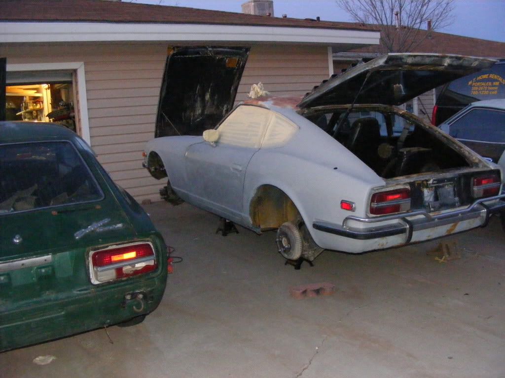

240z8 Posted March 30, 2010 Author Share Posted March 30, 2010 (edited) Mini- Update time! I cleaned the inside of the car a bit more; I cleaned the seats, trim, and carpet. I found out that on each floor I'll need a 6.5"x24" patch for the rust. There the only cancerous rust is right on the drain plugs and isn't bad at all, but in between the plugs where there is a dip in the metal there is some rust on both sides that is a little bad but hasn't even gone half way through the metal, but it can hurt to replace it. Also, I finished painting the car with rattle-can primer on everything except the roof and panel under the taillights. As for my last mini-update, I took my diving test at 7:00 this morning and got a 92 on it. I just need to improve on how smooth I turn the wheel and where I sit in the lane, apparently I drive too close to the center line. I can get my provisional driver's license on April 8. That's all for now. Edited March 30, 2010 by 240z8 Quote Link to comment Share on other sites More sharing options...
