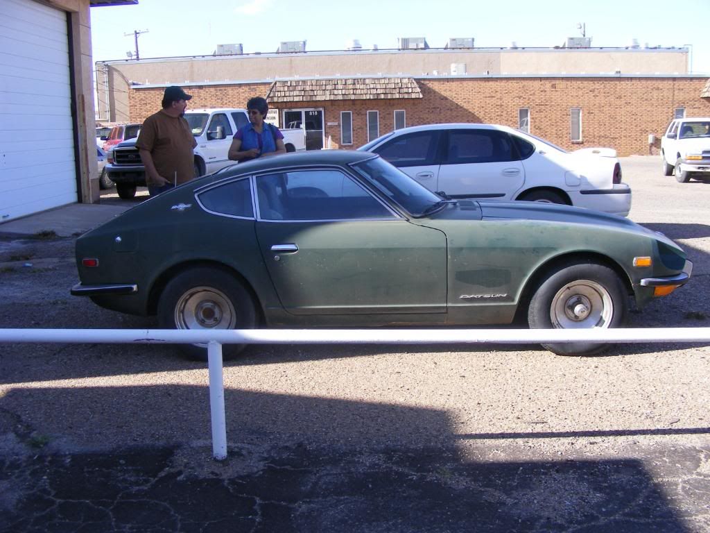

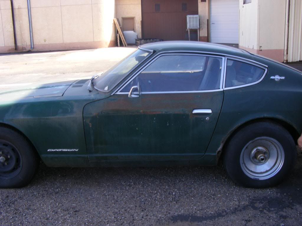

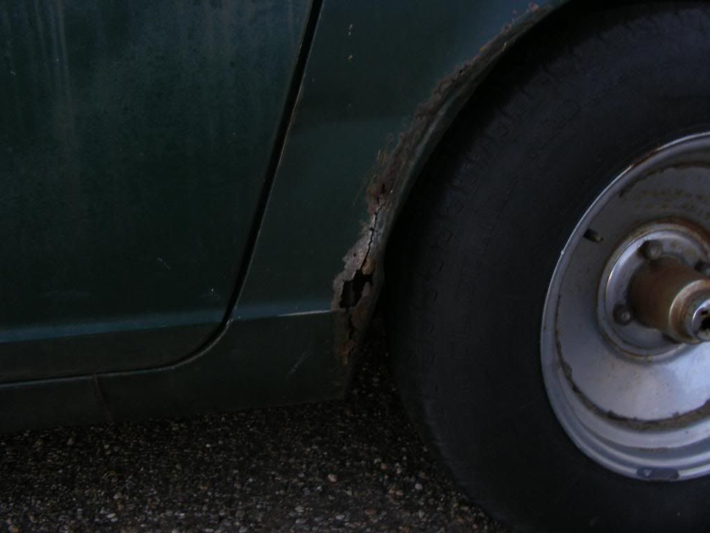

This Z has a much better body that the other 2 Zs at my house. There are some itty-bitty little holes in the floors. The driver side door has a huge dent in it and the front end of the driver side quarter panel has some rust and needs to be replaced. The car was made in July of '70. The vin is 6849.
Here are some pics of the car. =]
The quarter panel:
Here is a side shot, you cant see the dent very well, but if you follow the surface rust, that is the top of the dent, and the darker looking spot is the dent.:

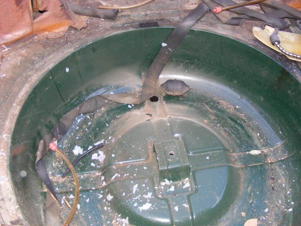

Here is a pic of the battery tray, the only visible rust is where the battery was sitting:

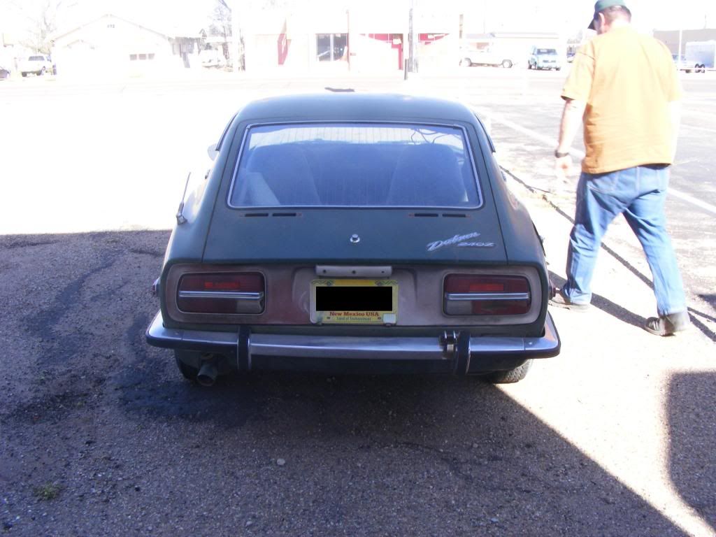

Here is a pic of the rear of the car:

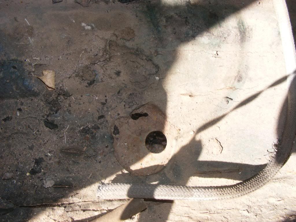

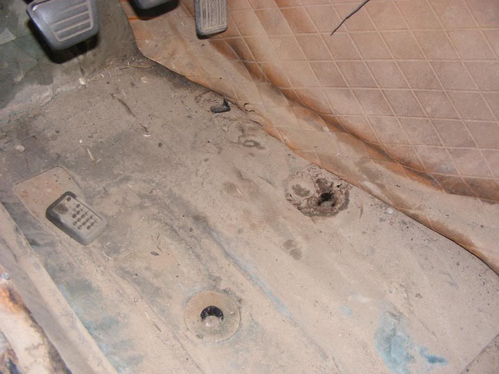

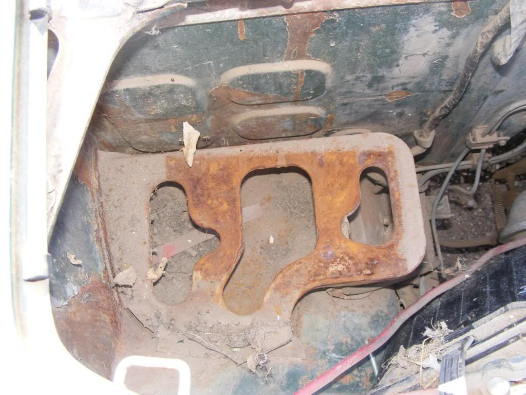

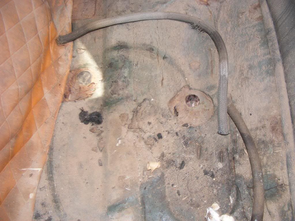

The rust in the driver floor. Only a small rust patch around one of the plugs.
The passenger rust spots:
There is some flaky looking rust by the front plug:

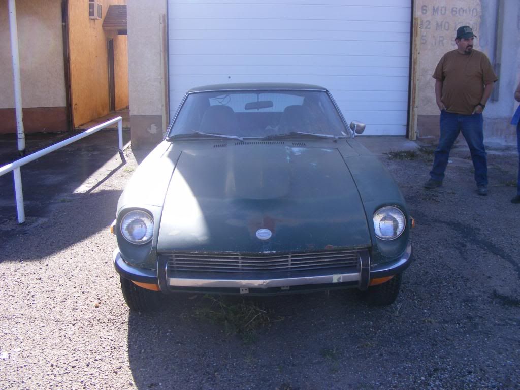

Front shot:

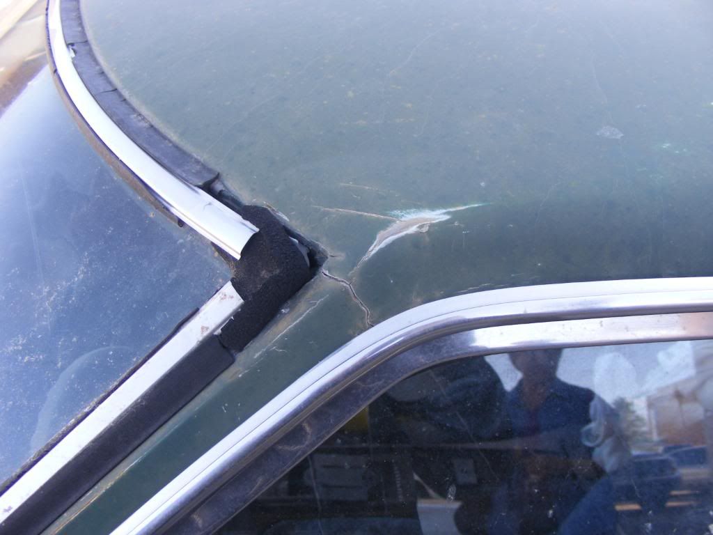

Also, the car has these funny looking splits in the corners of the roof:
There is surface rust on most edges, but the car looks good otherwise.

I'm curious about the vin number. oh wait its 6849. Still it has the early hatch vents and the 240z badge on the quarter panel. definitely a series I. Everything looks original as well. I'd scoop that up in a heart beat i dont care if the whole roof was made of bondo.
Hey Justin, That's a great find! How much do they want for it? I would love to find a series 1 like that. It doesn't look like it needs too much (figuratively speaking) work to get it going. Those Rust holes do not bode very well, in that you know there's gotta be some more hidden rust underneath most likely, and also, how are the frame rails? The Rear wheel arches can be replaced with Tabco parts, and that crack by the roof could be rust in the A pillar. It really looks good for it's almost 40 years of age, so if the price is right, then buy it. Either that or let me know and I'll come get it :wink: Too bad you didn't find it before you bought the other two, but that's learning... the other ones you can work on, this one you can restore to drivable, then you'll have something to run to the autoparts store in. Just remember, you're running down a long road having multiple Z's to fix up It's hard enough conscientrating on one Z, much less 2. I know a guy in Espanola and some others here in ABQ that might have parts for you cheap, like that door, and center console.. I totally want a series 1 vented hatch.
The Brown interior is really cool, but it might be hard to match vinyl. you might call MSA, black dragon, or Datsun restore and see if they have that "spice" kind of color for 240z's. Again, nice find, hope the price is cheap...

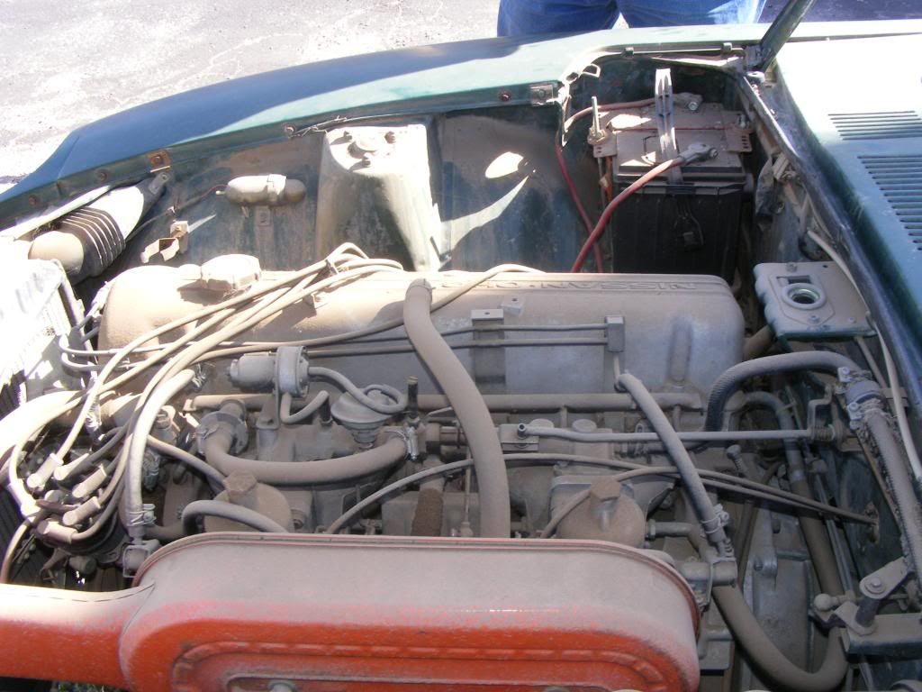

Here is a pic of the engine:
I don't know much about the engine, I didn't actually talk to the man selling it. I think my dad said something about it being from a '72 and it didn't run. I think my dad will probably know more about it right now than I do, since he talked the the guy.
The car is $400. I looked under the car and the framerails looked fine, they weren't rusted through or warped. The car is in a much better condition than I had hoped, I was expecting huge holes in the floors like the other 2, but it only had the small amount. =]
wow, cool, very nice! If you don't keep the engine in there, then try to keep it together as possible. it's good it's still got the air cleaner, and the SU carbs are good :)

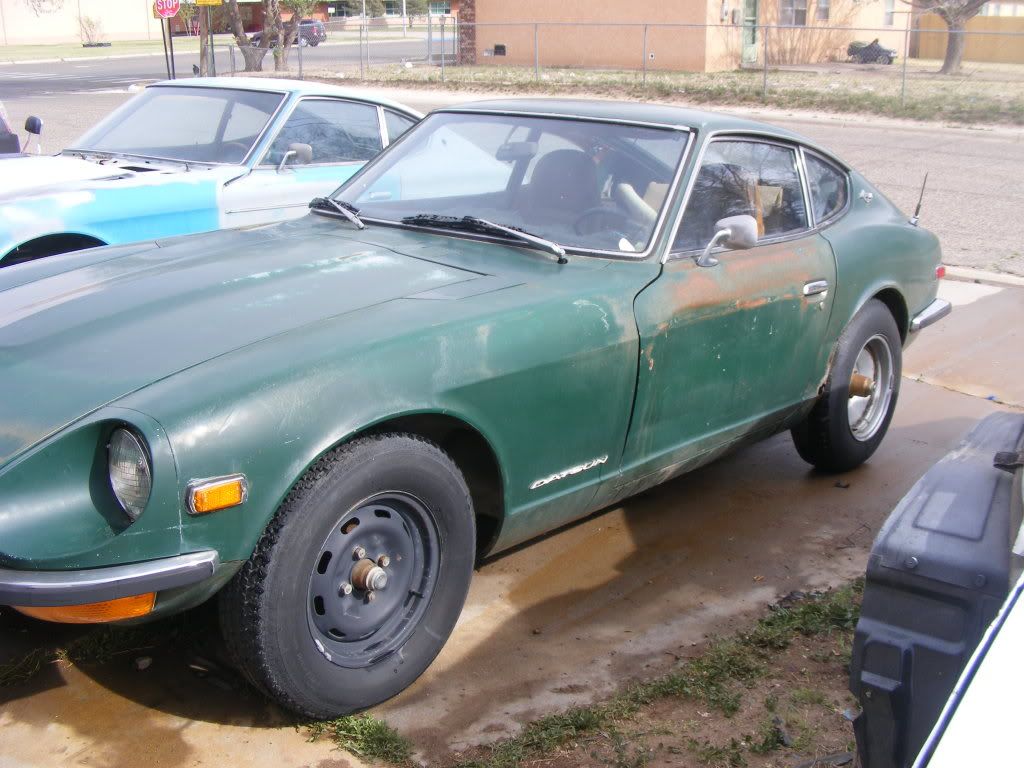

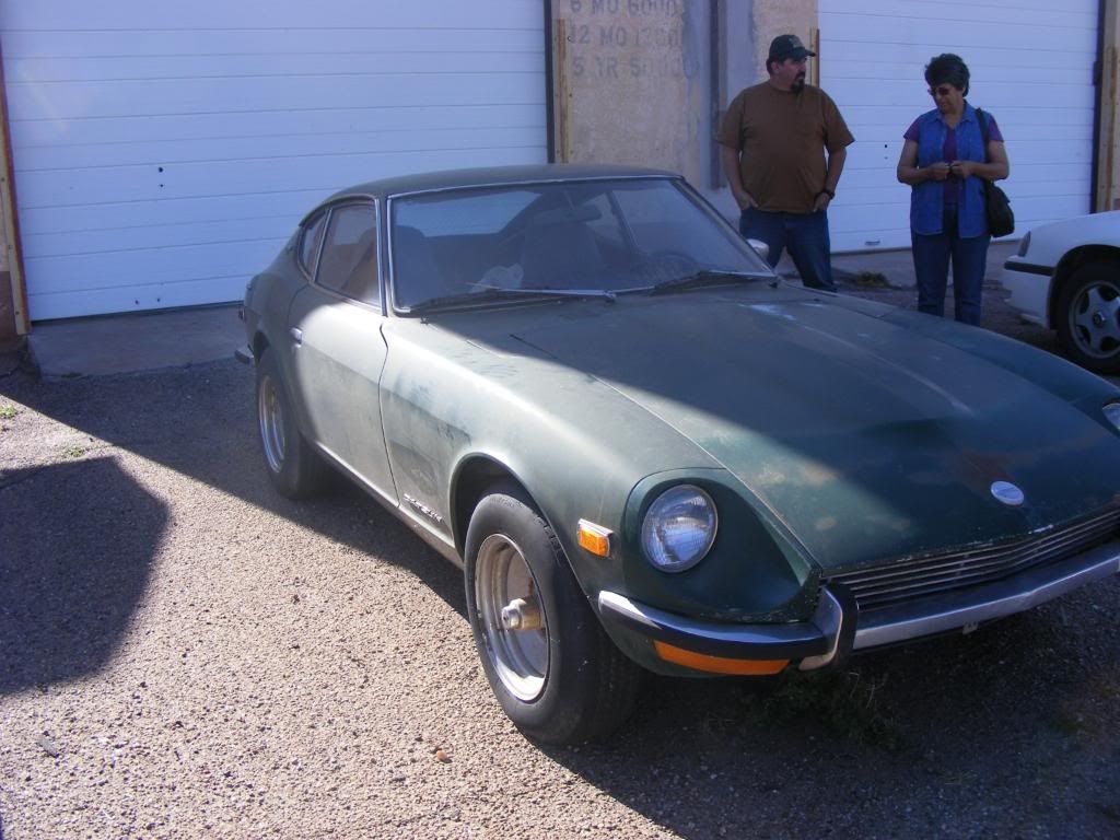

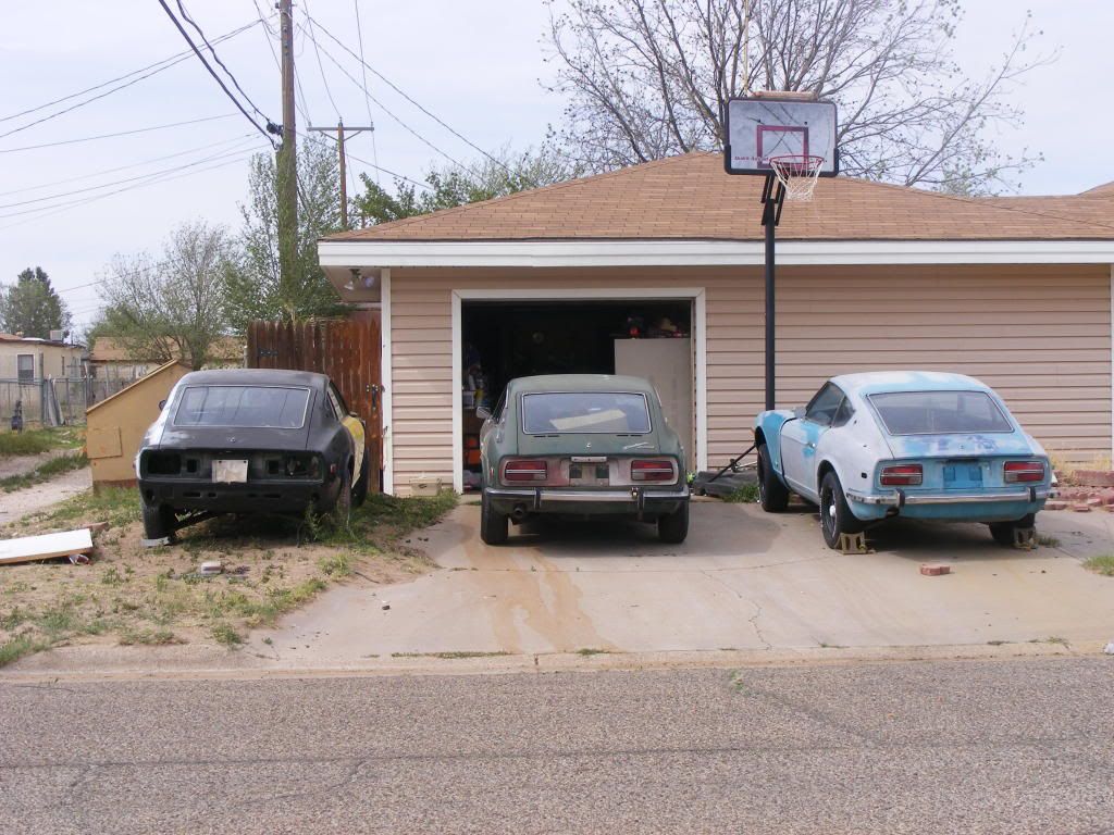

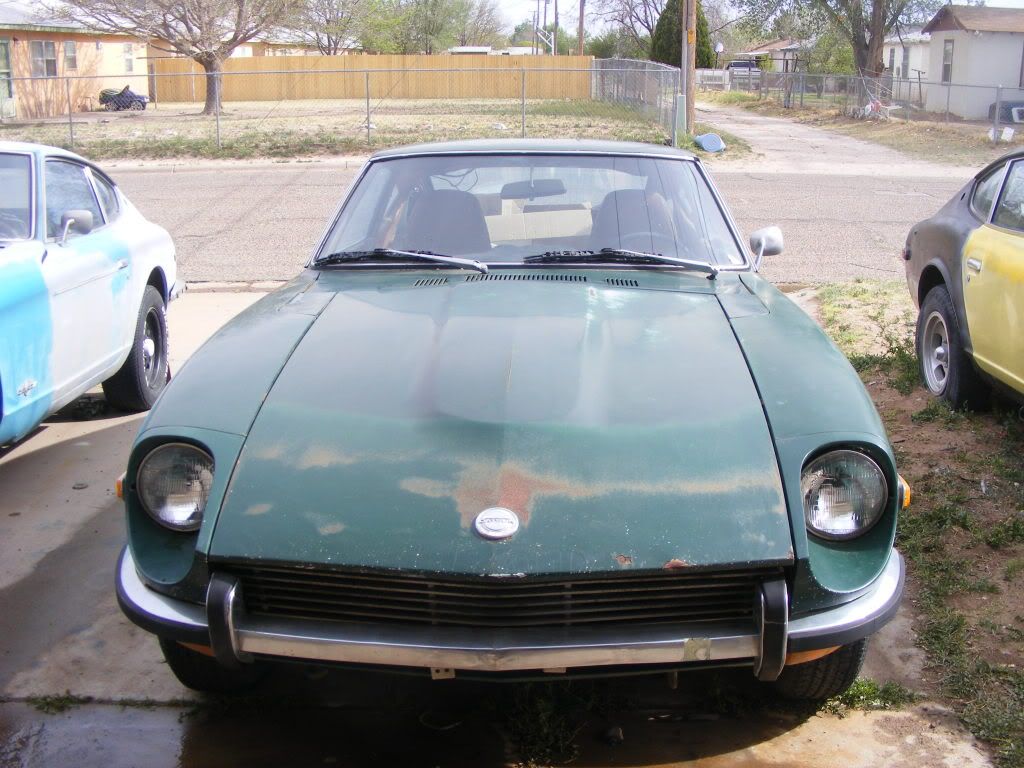

OK, we finally got the car to the house. I did a fast wash on most of the car and found out that I need to tighten the hatch water catching thing so it will stop leaking into the wheel well, I need a new windshield weatherstrip, but I'll probably need an entire kit for the weatherstrips.
Here are some pics of the car when we got it to the house:
All 3 Z's:
Front shot after a quick wash:
3/4 shot:
Battery tray after washing and drying. Its rusty but not rusted through, I bet a good sandblasting will clear that right up:
