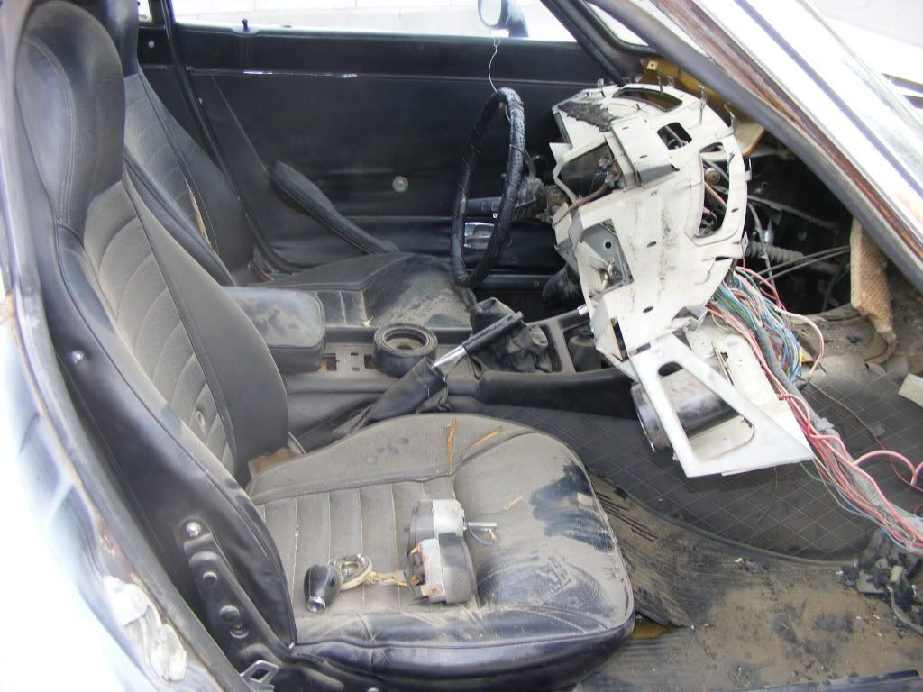

I was already thinking about trying to fix the jacked up wiring, but I have no idea on how to get the wires back in the connectors. I was looking at the wiring diagram here http://www.atlanticz.ca/zclub/techtips/wiringdiagrams/240z/1971_240z.gif
and noticed that on the car, there is a red wire and a blue wire going into an inline fuse going to the blower motor, and the blue wire is cut way further back on the car. There was another blue wire, I don't remember if it had a stripe though, and it was cut. The other blue wires I see on the diagram are going to the ignition switch, the accessory relay, the cooler, the wiper motor, and the combination switch. I have a question about that too, what is the accessory relay, the cooler, and the combination switch?
Oh, and another thing, when I had been trying to fix the wiring before, I could get the blower to work and blow air out all of the vents, so I don't know if wires are bypassed or anything.

Combination switch = headlight/wipers/washer/turn signal/high beam switch. Sometimes it means both sides, sometimes its just the headlight side (at least, thats how the term gets thrown about; they may be a bit more anal retentive about how the terms are applied in the FSM, I never really bothered to check.)
Have you pulled the dashboard yet? If it is REALLY jacked up, the task of repairing it is much easier if you can actually see what you are working with plainly and NOT feet up, bent in half, holding a flashlight in your teeth. It might seem like more trouble than it is worth, but I have never heard anyone say "Gee, I didn't really *need* to pull the dash out to do that, it would have been easier if I hadn't!!"
The dash is mostly out, but the cage thing that goes behind the radio got caught on the radio and I just gave up on the dash because I didn't want to mess up anything more than it already is. I was already pissed from smacking my head a lot, finding the wiring like that, and before I had spent a good half hour using a shop vac to suck out the busted up sound deadening and I was kinda tired (mentally, not physically), so I was just like screw it and put up my tools and went in the house.

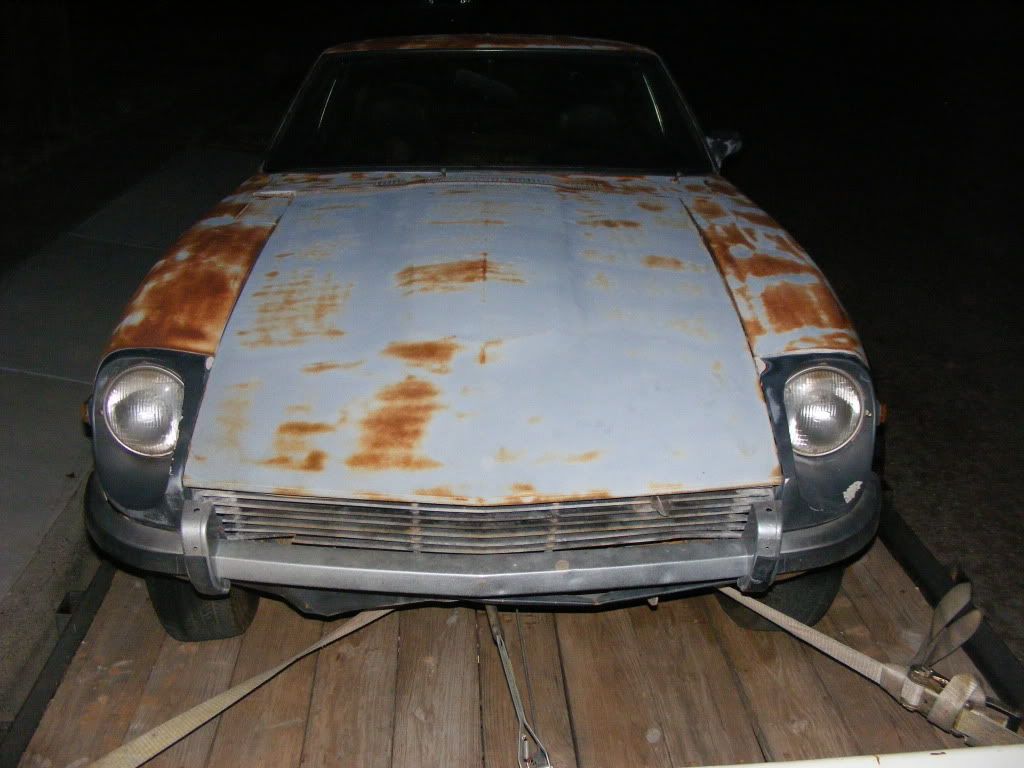

Front shot:

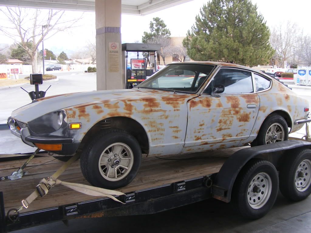

3/4 Shot:

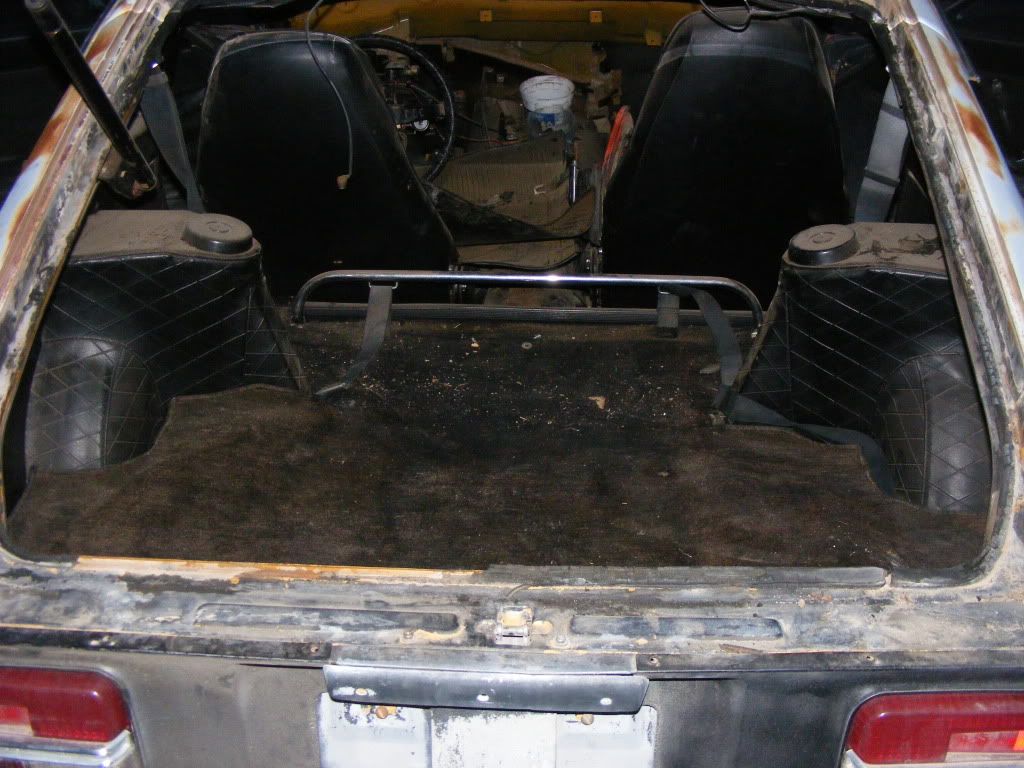

Interior:

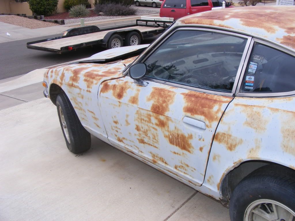

Driver side:

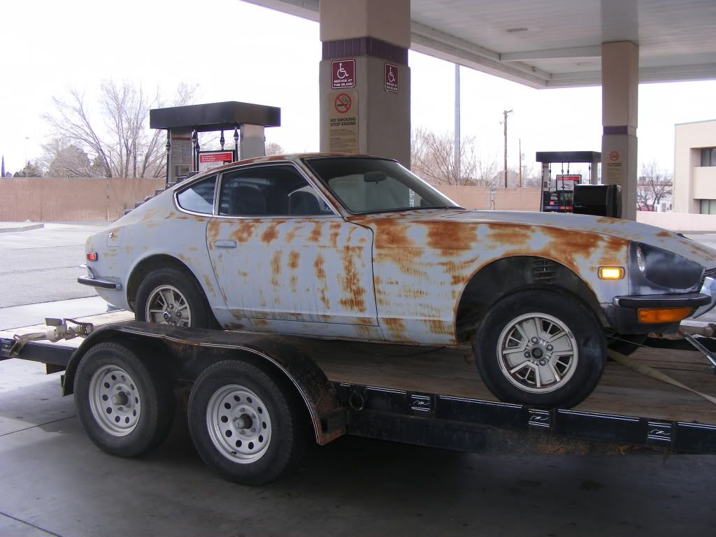

On the trailer:

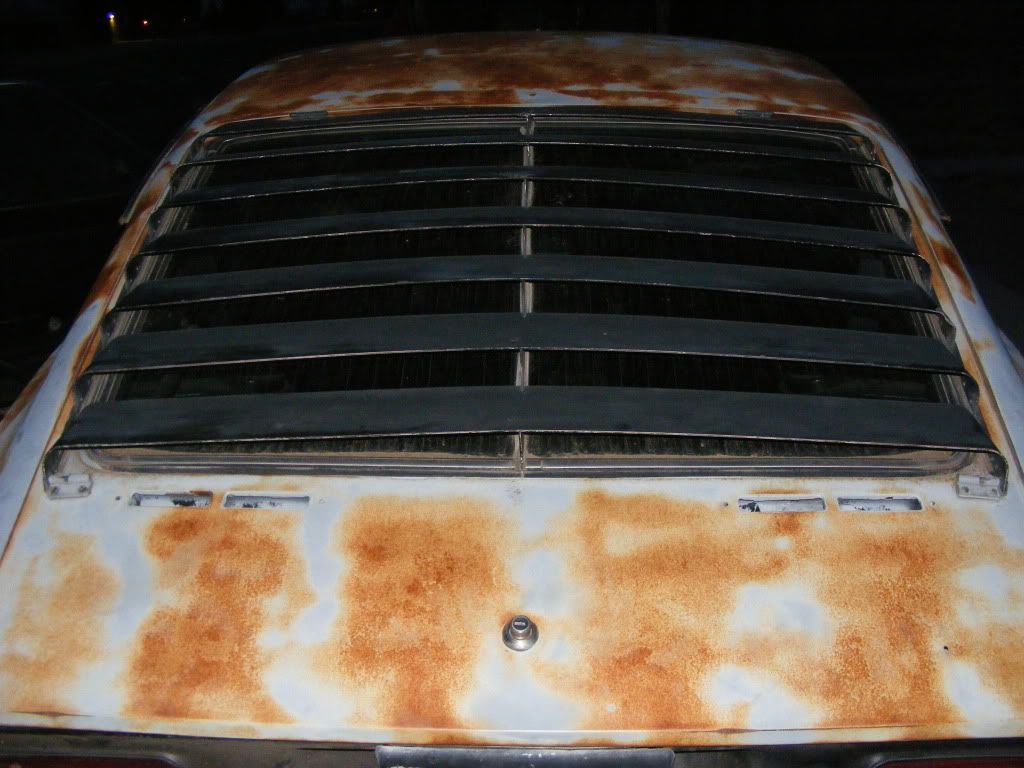

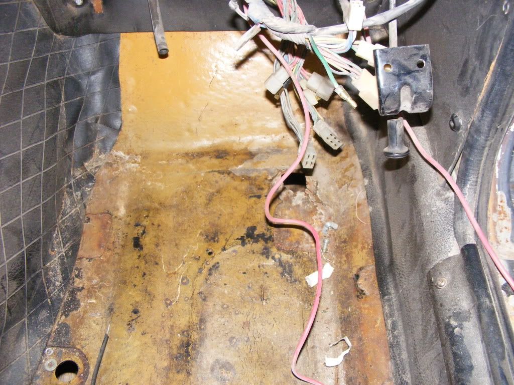

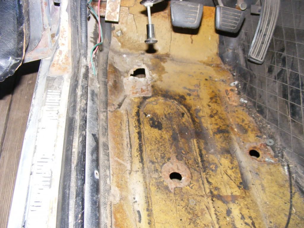

Rust :lol: :
The rust looks pretty bad from those pictures, but that is because the dirt and orange paint on the floors. From underneath the car, those were the only spots I could see, and it didn't look like they spread.
Cleaned out a bit:

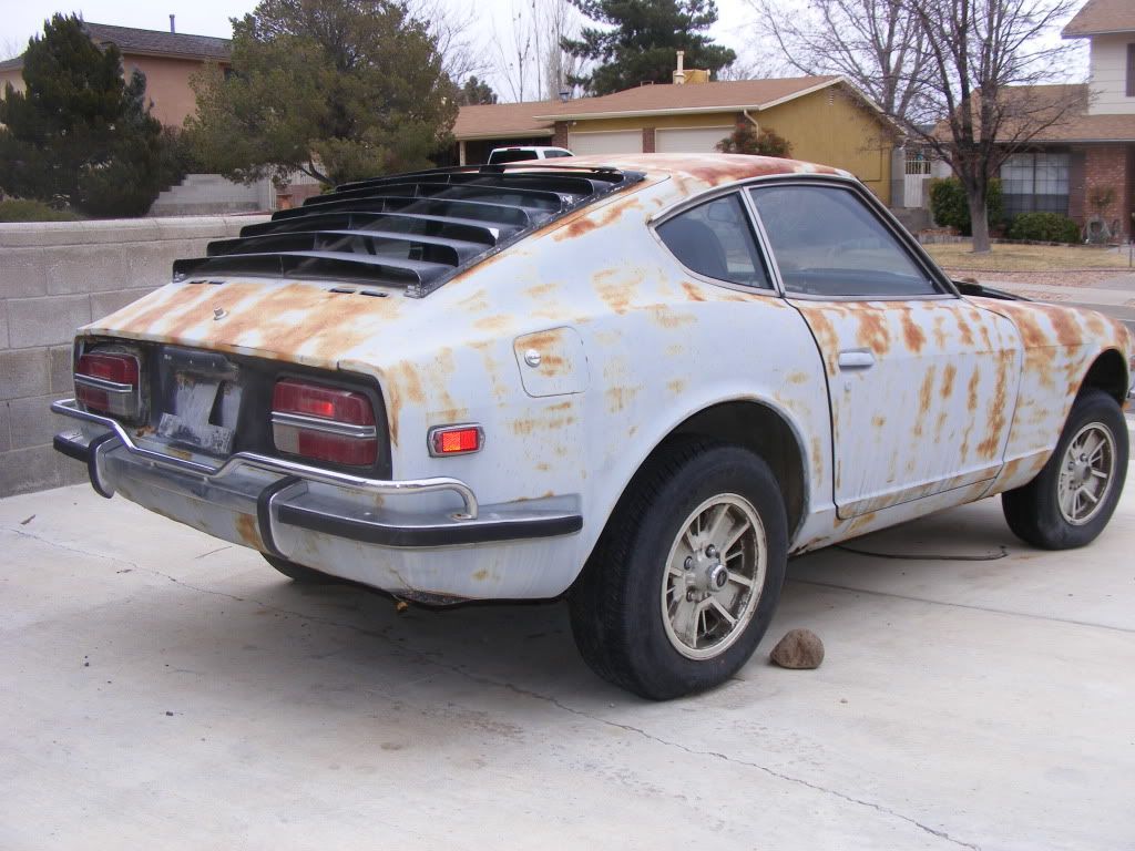

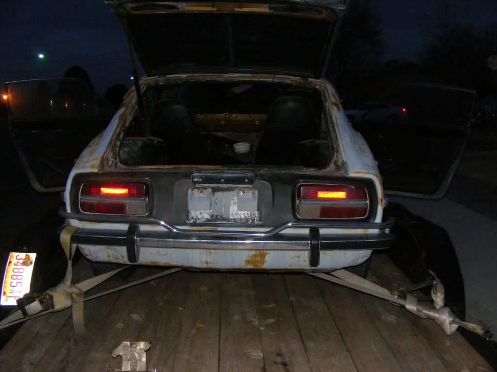

Rear shot:
I'm pleased with the rear end, its mostly straight, it has a cool bumper bar (it needs 3 more bolts, only one bolt is holding the bar on. That's why it looks bent.), the taillights are clean and un-cracked, the hydraulic strut holds up the hatch, all the tubing for the vents in the hatch are still there, and it has working louvers.
It was made in 1/71 and it's VIN is 20,388. I think it's definitely worth the $200 I payed. It has a good interior for the most part, a straight body with no major body damage, awesome looking iron-cross wheels, and decent tires.
