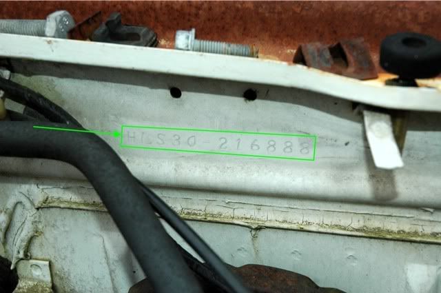

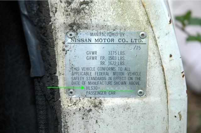

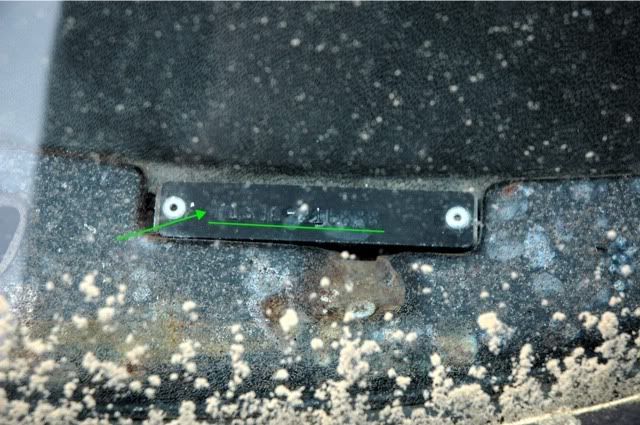

Administrators BRAAP Posted April 22, 2009 Administrators Share Posted April 22, 2009 The VIN (Vehicle Identification Number) is found in a few locations, but only one of those is the actual definitive Vehicle Identification Number! On the S-30 these are found stamped in the firewall, etched/printed on a plate in the engine bay, on a plate in the drivers door jamb near the striker and stamped/etched into a tag riveted on the dash as seen down through the windshield drivers side. The firewall stamping IS the VIN of the car! That is the one that MUST match the VIN as listed on the title/registration of the car to be legal. If not, you probably should get that straightened out with DMV and verified as clean through your local, county and state police etc. The title/registration of ANY car belongs to the firewall, not some plate on the door or engine bay or dash. Now how much of that firewall technically constitutes the car by definition, I don't know. The dash tag, engine bay plate and plate at the door striker are merely redundant and for quick reference only, not the official VIN numbers. Dashes are often legitimately swapped out for various reasons, hence not definitive. Door striker plates and engine bay plates are just as easily swapped with a drill bit and pop rivet. So long as the VIN as stamped on the firewall matches that on the plates, the rest of the info on those plates belong to that car. If those do not match the VIN as stamped into the car body on the firewall, that will generally raise red flags to the authority that notices the discrepancy and further investigation into all the VIN numbers displayed on various tags, title, on/in the car may take place. My thought here is better off volunteering that discrepancy to the appropriate authorities now than possibly in the back seat of a Ford Crown Vic with your hands behind your back. Not saying that would happen if the chassis is indeed stolen resold to you unknowingly, but it could. Another admin on this forum was pulled over in his LT1 powered 240-Z some years back as the description of his Z matched that of a recently stolen Z in the area. He replaced his dash, which had a different VIN than what was stamped on the firewall printed on the registration. This did not help his situation in the moment! He was in cuffs as they ran both VINs which obviously turned up clean belonging to him. At any rate, the firewall VIN IS your cars VIN and must match your title and registration VIN. On newer cars such as my Z032, the VIN is also etched into the glass of both T-tops, supposedly to deter thieves from stealing and selling T-tops, NOT for vehicle identification. Here are 4 of the VIN locations on a '75 280 THE VIN! Engine bay plate; Door striker plate; Dash plate; Hope that helps, Paul Quote Link to comment Share on other sites More sharing options...
Carl Beck Posted April 23, 2009 Share Posted April 23, 2009 Another admin on this forum was pulled over in his LT1 powered 240-Z some years back as the description of his Z matched that of a recently stolen Z in the area. He replaced his dash, which had a different VIN than what was stamped on the firewall printed on the registration. This did not help his situation in the moment! He was in cuffs as they ran both VINs which obviously turned up clean belonging to him. Yes that would get one arrested here in Florida as well. Most States, if not all, have specific laws that forbid the removal or alteration of the VIN Tag visible though the windshield. It is there to aid law enforcement... If you get stopped for any reason, and that VIN tag is missing, the Officer can impound the car on the spot, and arrest you. Here in Florida, there is a specific process outlined by statute, that requires an Official from the DMV, or a State Highway Patrol Officer, or a County Sheriff to be physically present when the VIN tag visible though the windshield on a vehicle - is removed or altered for any reason. They have a specific form that documents the proper removal/alteration from the car. Then when the VIN tag is reinstalled one of the specified Officials must be present - and again the required forms be filled out and signed. Cars built from salvage are assigned a new VIN by the State... here in Florida the "rebuild" VIN's begin with FLA and are usually followed by the original chassis number. FWIW, Carl B. Quote Link to comment Share on other sites More sharing options...
