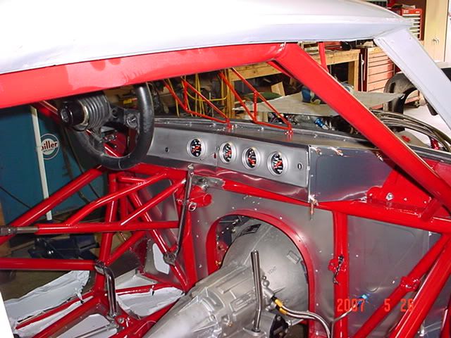

Here's some Cleko's in use on the right side of this dash.

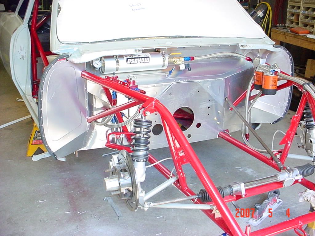

It's not inner fenders, but here's a bunch of sheetmetal work for a firewall.
