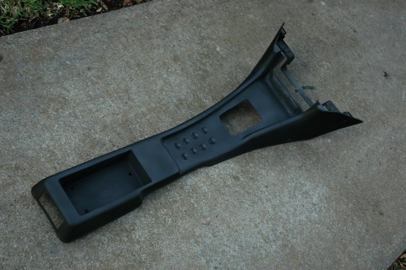

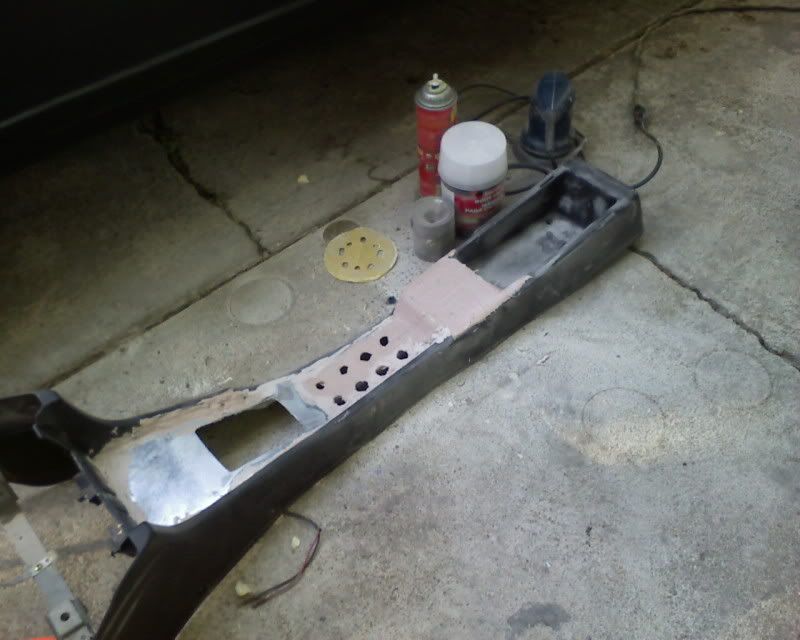

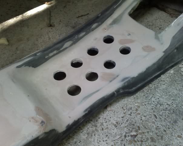

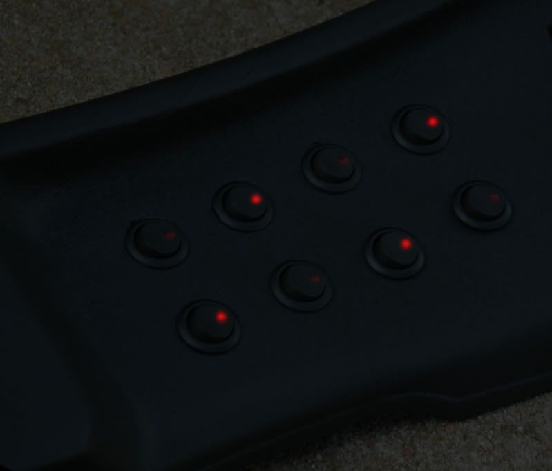

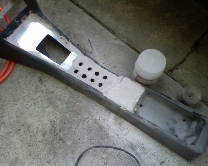

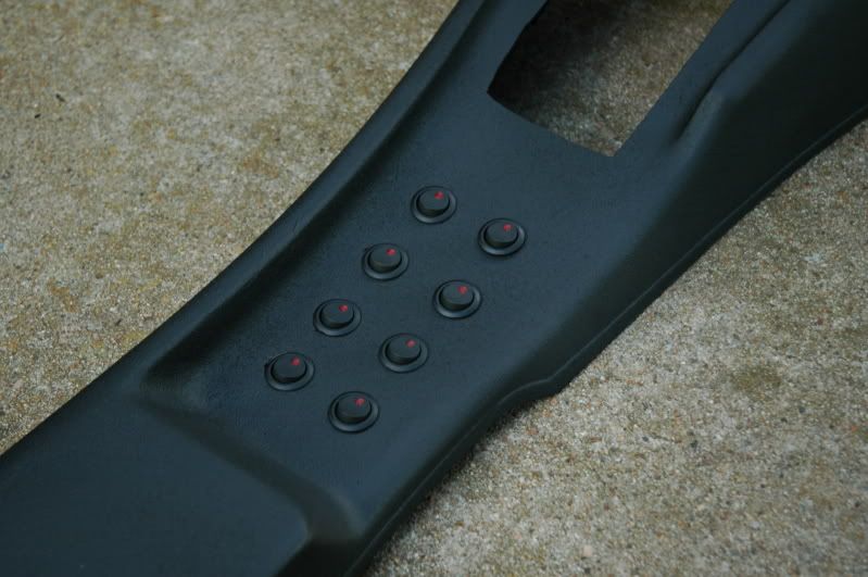

HoustonZ Posted May 25, 2009 Share Posted May 25, 2009 My dash needed a switch array, as well as some other stuff cleaned up. I bolted in the sheet metal and am working on blending all the curves together. The switches will control all the functions in the car. Headlights, turn signals, wipers, main power, fuel pump, ac, wastegate control. I used rustoleum hammered paint as texture. It came out great!! Quote Link to comment Share on other sites More sharing options...
Arif Posted May 25, 2009 Share Posted May 25, 2009 CF, Great job. That looks totally stock! Is that bondo you used to form it up? Quote Link to comment Share on other sites More sharing options...

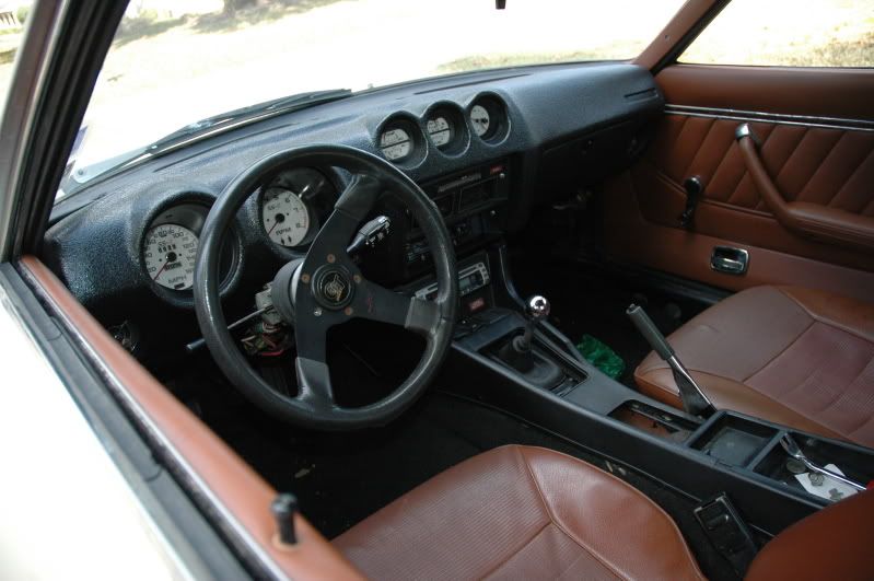

HoustonZ Posted May 25, 2009 Author Share Posted May 25, 2009 Thanks! Yep. I used some 18 gauge sheet metal cut to shape, then bolted it down at 6 locations. Then I used regular bondo applied liberally to blend all the transitions together. Came out even better then I expected. I used the exact same process to restore the dash in the above picture, except in the end I had it professionally sprayed with bedliner. Quote Link to comment Share on other sites More sharing options...
lazycat5 Posted May 25, 2009 Share Posted May 25, 2009 Nice job. You just filled the cracks on the dash with bondo and sprayed with bedliner, can it be just that easily done. Quote Link to comment Share on other sites More sharing options...

hogie Posted May 25, 2009 Share Posted May 25, 2009 nice, where did you get the switches? Quote Link to comment Share on other sites More sharing options...
The love of JDM Posted May 25, 2009 Share Posted May 25, 2009 Nifty idea! Looks real nice. Quote Link to comment Share on other sites More sharing options...
260zturbo Posted May 26, 2009 Share Posted May 26, 2009 man thats killer, where did you get the switches? Quote Link to comment Share on other sites More sharing options...
HoustonZ Posted May 26, 2009 Author Share Posted May 26, 2009 Thanks for the compliments! Here are the ones I used. http://cgi.ebay.com/ebaymotors/12X-ROUND-12V-RED-DOT-LED-ROCKER-SWITCH-TOGGLE-CAR-SPST_W0QQcmdZViewItemQQ_trkparmsZ72Q3a2096Q7c66Q3a2Q7c65Q3a12Q7c39Q3a1Q7c240Q3a1318Q7c301Q3a0Q7c293Q3a1Q7c294Q3a50QQ_trksidZp3286Q2ec0Q2em14QQhashZitem3a4e3c80d9QQitemZ250420691161QQptZMotorsQ5fCarQ5fTruckQ5fPartsQ5fAccessories Quote Link to comment Share on other sites More sharing options...

icapture Posted July 9, 2009 Share Posted July 9, 2009 damn man, looks super good. So tell us, what do the 8 switches control? Quote Link to comment Share on other sites More sharing options...
HoustonZ Posted July 9, 2009 Author Share Posted July 9, 2009 No pics of it installed yet. Still need to finish up the wiring. Blinkers (left and right), headlights, main power, fuel pump, ac, blower, wipers, aux. I'm also installing a magnetically operated hidden kill switch that will arm a push button starter. Quote Link to comment Share on other sites More sharing options...
