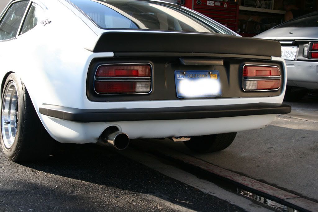

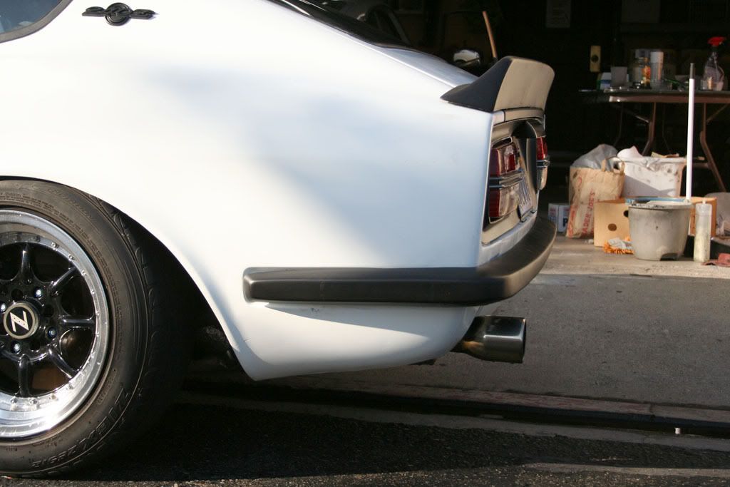

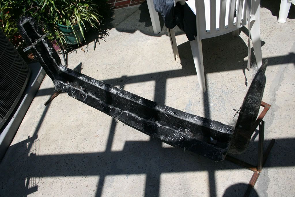

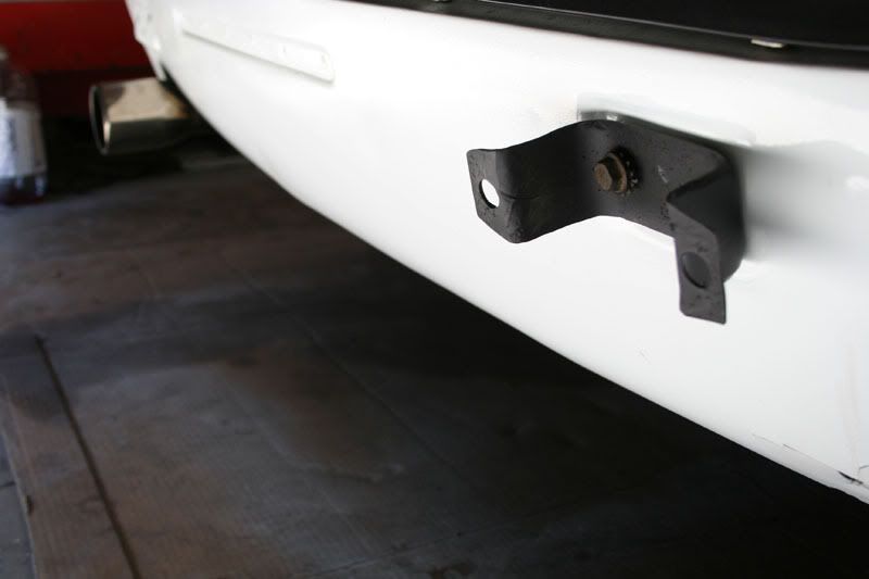

Yorgee Posted August 12, 2009 Share Posted August 12, 2009 Been working with fiberglass for almost a year now and it's crazy how many ideas actually pop into your head when you learn something like glassing. Although most of the ideas are probably way too advanced for a beginner to tackle, I thought I'd try something a little more plausible. So I decided to make some bumpers... I had already welded up my front and rear bumpers; Got rid of all the seams and holes, so most of the labor was already done. All that was left was to make molds. Just recently completed my front bumper mold but haven't been able to lay the glass for it yet. Here's a pic of the rear bumper inside the mold. Since the glass is somewhat thicker, and due to shrinkage, the space inside the bumper where it's mounted is a little narrower, so the U shape brackets used to mounted the bumper had to be modified. But instead of cutting up the brackets, I just decided to make some. The combined weight of the bumper with the two brackets is around 4 lbs, which is definitely a great weight reduction; rather than having to take the bumpers off completely. Finally got around to painting a finished bumper and got it mounted today. Everything lines up nicely =). Quote Link to comment Share on other sites More sharing options...
