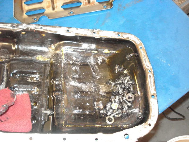

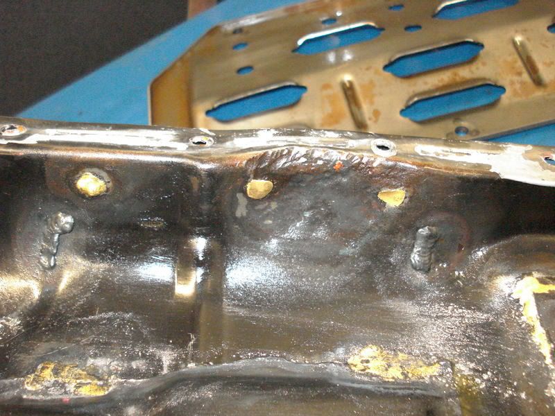

pat1 Posted November 14, 2009 Share Posted November 14, 2009 So with a big oil pan and more oil will that prevent that problem I heard about with RBs once they get to a certain horsepower. I heard that RB25 usually throw a rod around 500 and Rb26 around 600 with stock internals. Or is that a some type of tuning issue and not associated with the amount of oil flowing around the engine. I don't know about the fact that more oil will pervent the engine blowing up at high hp but I think with more oil in the pan will pervent the oil starvation problem. Here are some pics of the progress I did tonight Quote Link to comment Share on other sites More sharing options...
RKLamb123 Posted November 14, 2009 Share Posted November 14, 2009 Wow that is a very nice job. I can tell you now you will be getting a lot of business after this. That is one hot and professionally done looking pan. I am glad I found you that day instead of hacking up the pan I had. Very nice. Man I wish I could weld. Quote Link to comment Share on other sites More sharing options...

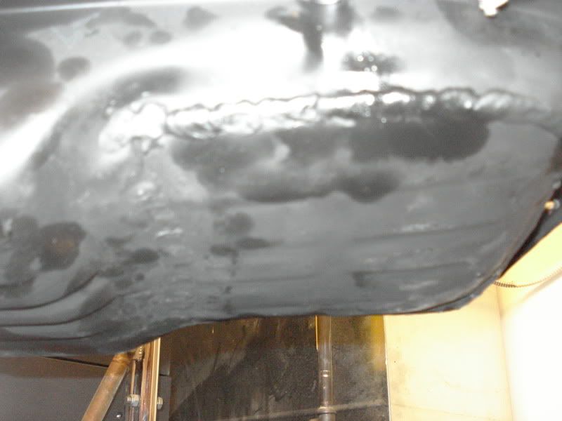

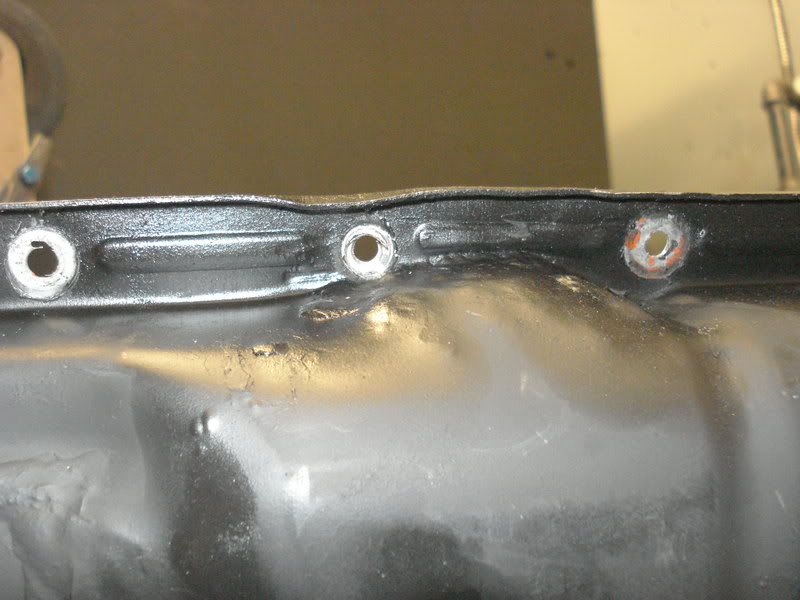

pat1 Posted November 16, 2009 Share Posted November 16, 2009 I'm 98.7% done here are some pics Quote Link to comment Share on other sites More sharing options...
RKLamb123 Posted November 16, 2009 Share Posted November 16, 2009 Well I guess I dont have too paint it now. Lol Quote Link to comment Share on other sites More sharing options...
pat1 Posted November 16, 2009 Share Posted November 16, 2009 Well I guess I dont have too paint it now. Lol I didn't want it to start rusting. This pan was kicking my but last night. I don't know what it was, but it's almost done I just need to put the drain plug and the windage tray and it's done Quote Link to comment Share on other sites More sharing options...

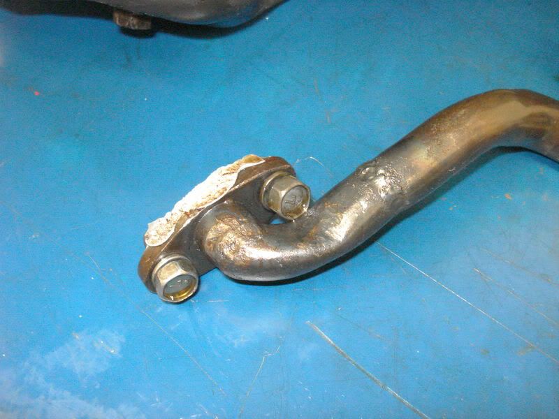

stony Posted November 22, 2009 Share Posted November 22, 2009 Here is my rb20 pan for an rb26 had to beat out the area around the block pickup modified pickup... basically used some of the rb20, rb25 and rb26 pickup to make this one. One of the advantages of being in japan when doing this is there are scrap motors all over the place that you can get stuff like this really cheap. Front part of the pan had to be moved around a bit. This one hole i had to use a allen head bolt a standard 10mm bolt would not fit. Quote Link to comment Share on other sites More sharing options...
