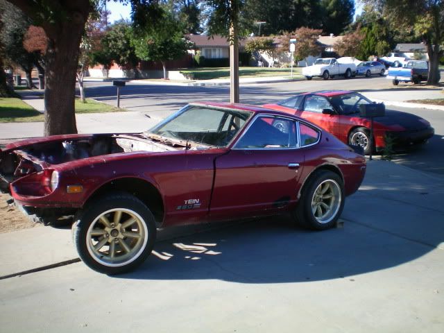

280zjoel Posted November 30, 2009 Author Share Posted November 30, 2009 Not mch going on, just getting the engine bay prepped for paint and all the rust cleaned up. Ill post some pics in a few days with the progress, I have to balance trying to work on my Z and customers project car( R32 Skyline:mrgreen:) Quote Link to comment Share on other sites More sharing options...
280zjoel Posted December 1, 2009 Author Share Posted December 1, 2009 ok, well I got someone helping me do some work on the Z, here is a couple of shots of the engine bay: Most of it is cleaned off but there is still more work to do. I did end up buying a Por-15 paint kit, with the chassis coat, so i guess its satin black for the engine bay. I dunno why, but i kinda like this pic for some reason, so i though id post it lol Quote Link to comment Share on other sites More sharing options...

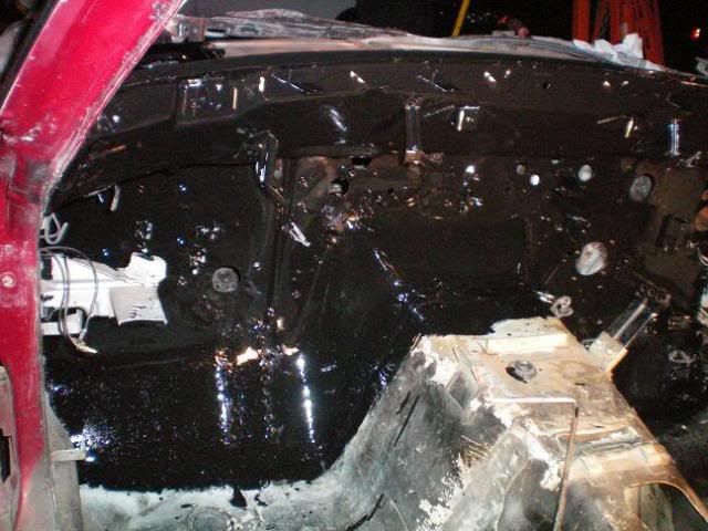

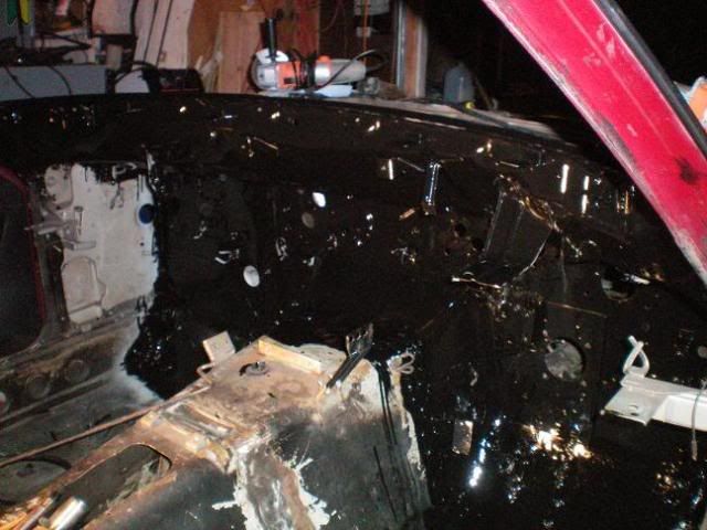

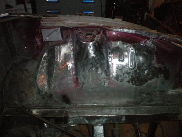

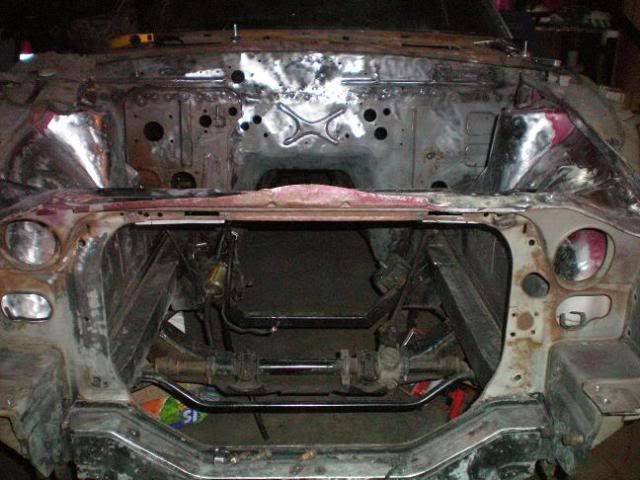

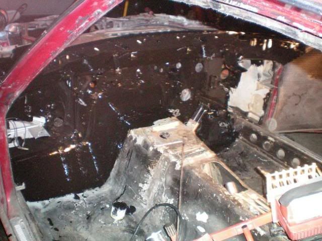

280zjoel Posted December 9, 2009 Author Share Posted December 9, 2009 ok, got an update. Not much but here goes, The engine bay is stripped to bare metal, and the inside of the firewall was too. Today I got to brush on some Por15 in the inside. GRRRRR dripping Por15 SUCKS!!!!!!!! LOL i had some Por15 left over from before(gloss black) and I was able to cover everything except for a 6'' x 12'' section under the cowl panel. So i ended up using some of the new por15 I bought, which i found out came in a semi Gloss coat. Oh well, I am going to spray it over with a topcoat anyways. At least now I am that much closer to getting the interior in. Quote Link to comment Share on other sites More sharing options...

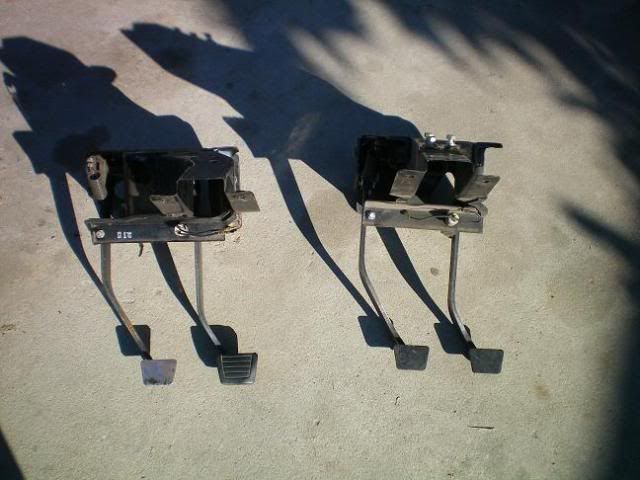

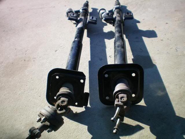

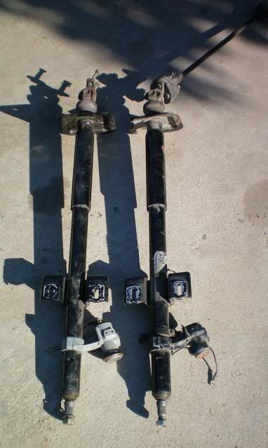

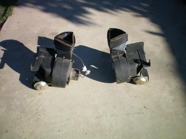

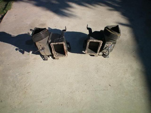

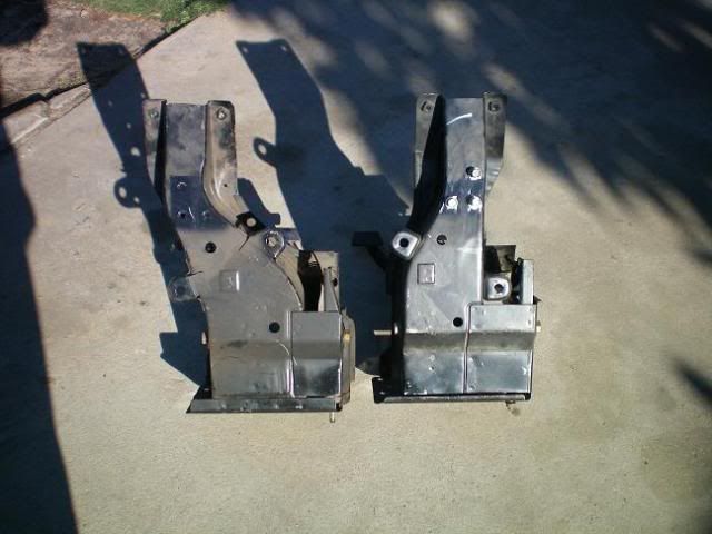

280zjoel Posted December 9, 2009 Author Share Posted December 9, 2009 Earlier I mentioned that I would post some pics of the LHD and RHD parts to show the difference or similarities. Anyhow I took some pics today of some parts. I did not get pics of everything yet. I will post more in the future. Here goes: Pedal Box: Lol RHD on the right side and LHD on the left. As you can see they seem to look the same but the difference is at the top of the pedal box. Here is the top of the pedal boxes. the RHD box curves to the right where as the LHD Box curves to the left, and has a harder bend then the RHD box. Steering Column: They are pretty much the same except for the part that bolts onto the firewall. LOL i forgot to switch the steering shafts around for the pic, so the one on the Right is the LHD and the one on the Left is the RHD steering shaft. Note that the flanges that bolt onto the firewall are different. The bolt pattern on the RHD shaft is 3'' across from center of one bolt to the another, on the LHD its 3 1/2'' across. Im not sure what these are called, but Imna call them the vent boxes:? anyhow you can see that they are complete opposites of each other. And here is the other side of them crazy parts. On a side note I did manage to buy some more Urethane sealer to seal up all the edges so that I can start to put the interior back together. Quote Link to comment Share on other sites More sharing options...

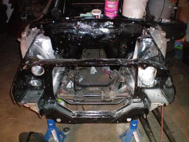

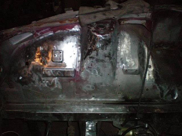

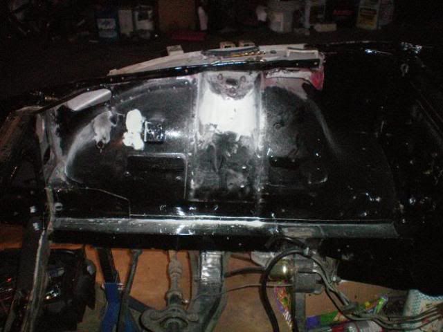

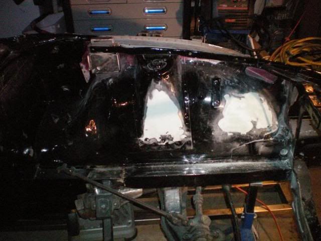

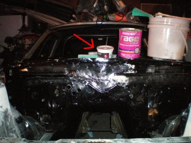

280zjoel Posted December 15, 2009 Author Share Posted December 15, 2009 Hey people's!!!! Sorry for the lack of updates, I have been getting a good amount of work done on the Z, but its just really time consuming. I got the whole engine bay stripped to bare metal and used Por15 on it. Then the bodywork got on its way. Since im related to the Bondo King (my brother loves BONDO!!!!) I am having him do the work on it to smothen it out. Im not going for a super show car look, just a clean non bumpy engine bay. Then I will spray it with Por15 Chassis coat. Its painted finally!!!!!!!! BTW thats just body filler dust on the sides Lol the glare from the flash and the body filler make it appear alot worst then it really Is, but some good filler will fix that. Hehehe Like my new cup holder? Quote Link to comment Share on other sites More sharing options...
