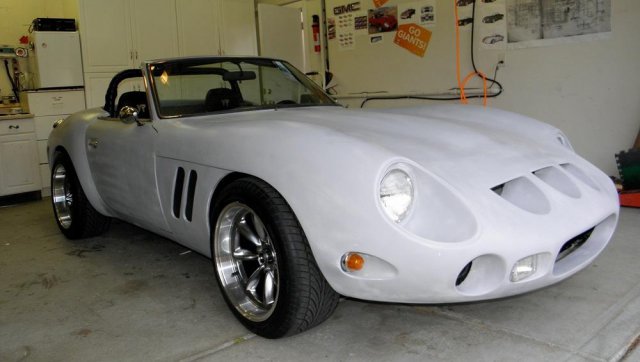

Fauxre Posted November 7, 2012 Author Share Posted November 7, 2012 Haven't made a final decision on the exterior, but I'm leaning (at the moment) toward something like this Cobra. As for the interior, I've ordered seat covers in black with tan inserts like this... Gonna try a local guy to make custom door panel covers to match. I'm also considering having the center console and vent surround hydro-dipped to look like burl wood, like these helmets. Quote Link to comment Share on other sites More sharing options...

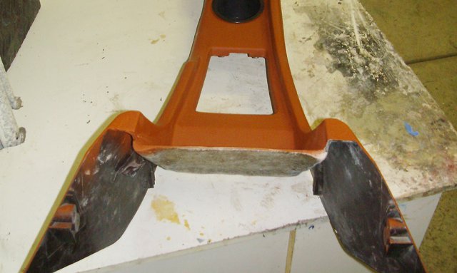

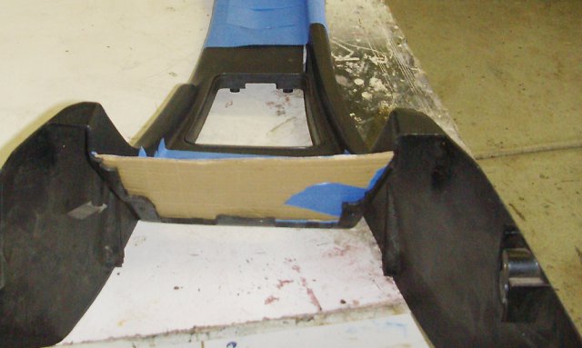

gravityflyer Posted November 16, 2012 Share Posted November 16, 2012 Don't need an ashtray... but who can go anywhere without cup holders? The interior is coming back together nicely. Well done! I'm about to prep my own console for a double-din install. I've never 'glassed' before but have been assiduously studying the technique. Thus, I have a few questions about your console process: - Photo 2: Did you use blue painters tape to create a basic template to create the form? - Photo 3: What type of material are you placing over the tape? - Photo 6: It appears that you're going over the glass with some bondo? Is this to remove any imperfections that may have formed from the glass? - What type of paint are you using? I'd like to use something that provides a slight texture to the finished console. Any suggestions? - In later updates to your build I noticed that you installed the aluminum frame for the stereo. Can this simply be screwed into the fiberglass? Sorry for all the questions! Thanks and keep up the good work! Quote Link to comment Share on other sites More sharing options...

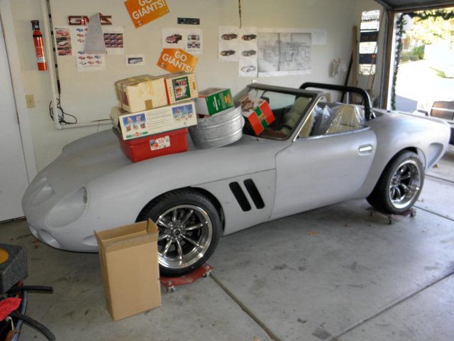

VacaVR Posted November 26, 2012 Share Posted November 26, 2012 (edited) No real progress. But while I'm waiting for the skins to arrive I decided to tidy-up some things in the interior. I bolted the seats in with the new foams (and one seat belt) just to get a visual, rerouted the wiring harness on the passenger side to hide underneath the reinforcement rails and started making cardboard patterns for the kick panels. Edited November 30, 2012 by VacaVR Quote Link to comment Share on other sites More sharing options...

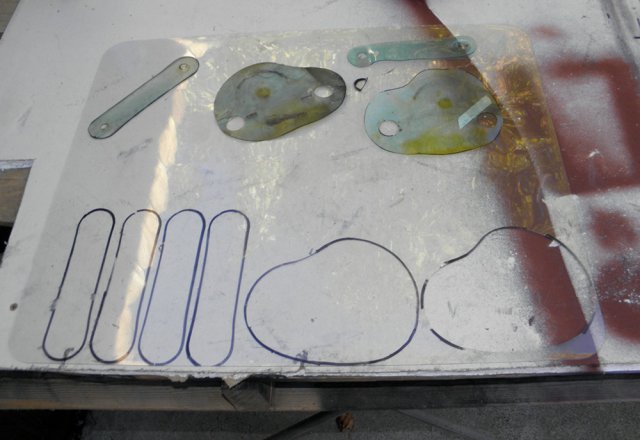

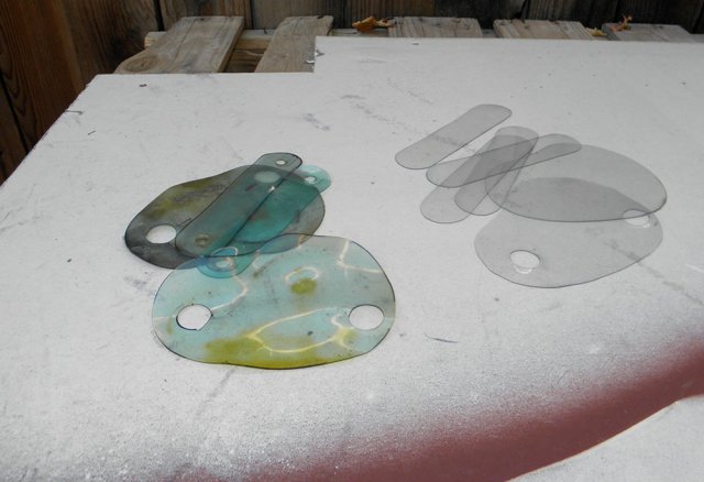

VacaVR Posted November 30, 2012 Share Posted November 30, 2012 Between the metal seat parts and the upholstery are these plastic wear protecters. Mine are pretty discolored and stained, so I cut new ones. I fretted for quite a while not knowing where to get a sheet of clear plastic material. "How to Restore Your Datsun Z-Car" calls this sheet acetate. I wasn't sure exactly what acetate was, so I did a little web surfing. Turns out it just means plastic. After checking the local hardware and fabric stores, without success, I resigned myself to taking the 35 mile drive to the closest Tap Plastics store. But, while procrastinating I had an epiphany. The clear protecter on my desk at work is almost exactly the same thickness and has the same flexibility. $10 at the Staples two miles away. They cut out easily with scissors. Quote Link to comment Share on other sites More sharing options...

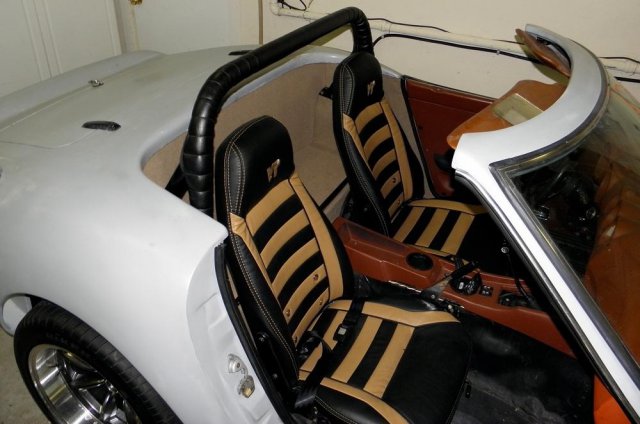

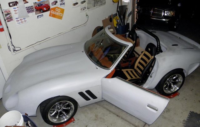

Fauxre Posted December 12, 2012 Author Share Posted December 12, 2012 Allright!!!! Got my old screen name working again. Still waiting for the butt warmers, but the test fit looks good. I may need to add a thin layer of foam in order to get a smooth transition from the new seat padding to the metal seat backs. Quote Link to comment Share on other sites More sharing options...

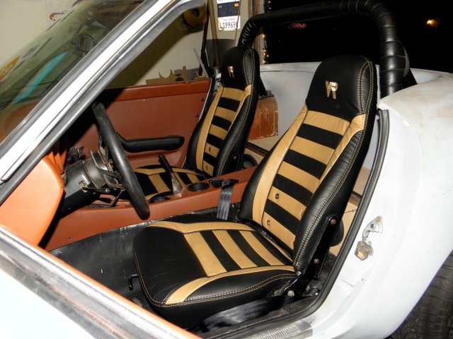

Fauxre Posted December 16, 2012 Author Share Posted December 16, 2012 Well, it's not perfect, but I'm happy with my first attempt at covering the seats. It took me most of the day to install the butt warmers and seat covers. It's a cold rainy day in Norcal, so my cheap heat gun came in real handy when it came time to stretch the synthetic leather. I wasn't able to get all the wrinkles out, but I'm pleased with the overall appearance. Quote Link to comment Share on other sites More sharing options...
Fauxre Posted December 18, 2012 Author Share Posted December 18, 2012 Seats are installed. With the new foam and upholstery, the driving position is higher. The steering wheel and shift lever are now uncomfortably positioned. But at least now I can work from the actual sitting position in order to get the ergonomics correct. Quote Link to comment Share on other sites More sharing options...

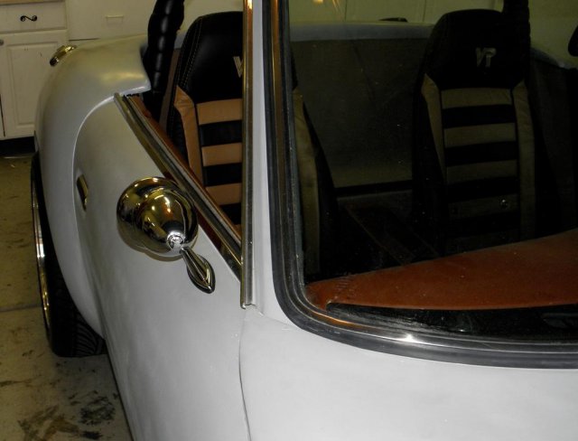

Fauxre Posted April 5, 2013 Author Share Posted April 5, 2013 More baby steps. Made some panels from thin hardboard to cover the reinforcing steel running from the door sills to shock towers. Covered them and the rest of the compartment, behind the seats, with some cheap beige carpet. My seam work is bad, and the color is wrong, but I can live with it temporarily. It sure cleans up the interior. I also added a couple of bullet style side mirrors for that '60s look. Combined with the windshield wipers, they make the VR look less like a "kit"... and more like a factory car. Quote Link to comment Share on other sites More sharing options...
