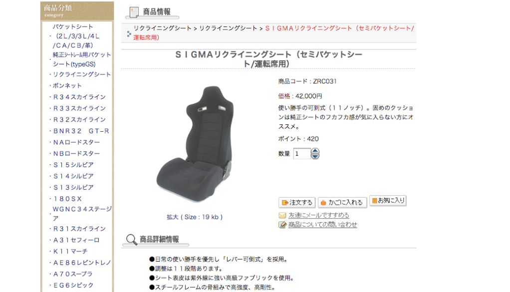

icapture Posted December 18, 2009 Share Posted December 18, 2009 I do think these are gonna be what I rest my butt in. Ive seen them fit in a Z before, and I just love the wings, I love how the lower part of the seat looks like a molded race seat (kind of like the carbon fiber seats found in some race cars) I love the narrow head rest, I just love it all. And at 500-600 bucks a seat they aren't too bad. I just have to find some reviews on how they stand the test of time. DROOOL: Quote Link to comment Share on other sites More sharing options...
jumpman2334 Posted December 30, 2009 Share Posted December 30, 2009 who are they made by? they look real sweet. im just not a fan of it being a reclineable seat... and i got two of these bad boys for xmas! im going to try and get some steel flatstock tomorrow to fab up some seat brackets. Quote Link to comment Share on other sites More sharing options...
Aaj2k5 Posted January 27, 2010 Share Posted January 27, 2010 These look alot like East Bear seats- they are based off the design of R34 seats.. Super comfy, durable (as long as they're legit East Bear's), good seat for the $$$ lol. Quote Link to comment Share on other sites More sharing options...

Nizm0Zed Posted February 6, 2010 Share Posted February 6, 2010 those first seats look like Drift Blade's http://www.shopdrift.com/Products/D1-3001/BladeSeat-Black.aspx AFAIK that is in US dollars per seat, might wanna confirm though. We sell them at work (approx $600AU each), and the quality is pretty damn good. As someone said, they are a 'copy' of the R34 GT-R seats, and very comfortable too. Quote Link to comment Share on other sites More sharing options...
