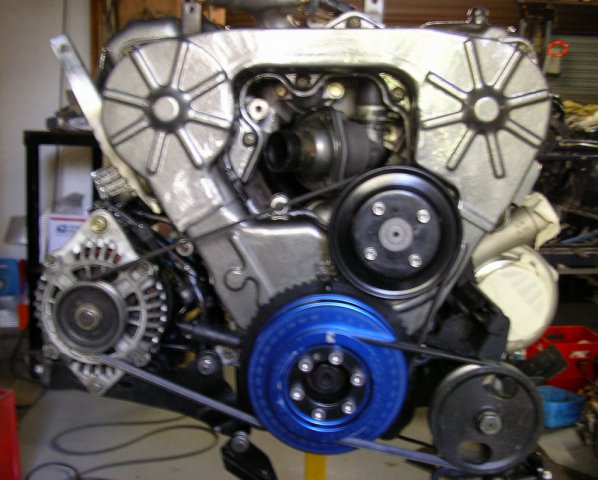

260DET Posted February 8, 2010 Share Posted February 8, 2010 The motor is out of a JDM El Grand which is a sort of AWD luxury van and have started to pull it to pieces, its supposed to have done 103000 KM. Typically, the coolant was very stale, on the good side the oil was not too bad. This is going to be a slow project, the present VG30DET engine in the Z is going well at long last so there is no rush. Have some Scat rods and a ARP main stud kit on the way from the USA, its best to spread the purchases over a period of time, doesn't hurt the pocket so much that way. The power aim is for something like 450 horses at the wheels with heaps of mid range torque and big acceleration from 3500 RPM up, Z is mainly used for time attack type events. Anyway, here is a pic, hope its not too big. Quote Link to comment Share on other sites More sharing options...

260DET Posted February 11, 2010 Author Share Posted February 11, 2010 Scat rods and ARP main studs arrived today, thankyou Race Engineering Inc, Florida, for the prompt service and keen price although I was charged $77.50 for shipping when it says $50.85 on the USPS box. Engine has been pulled down except for the cylinder heads and looks in good condition for my purposes. Very gunky inside and some marks on the cylinder walls, nothing broken though so no problems. Quote Link to comment Share on other sites More sharing options...

260DET Posted February 13, 2010 Author Share Posted February 13, 2010 A couple more pics, with the cylinder head one note the outline the head gasket has made on the head face. Its clear that the bore size is larger than the combustion chamber was originally designed for. Quote Link to comment Share on other sites More sharing options...

260DET Posted February 1, 2011 Author Share Posted February 1, 2011 (edited) Heads are done, pics show the oversize Ferrea valves, Schneider double valve springs and the titanium retainers. Its a milestone, the reassembly has begun Z32 crank has been checked out and prepped, its all OK and will take standard bearings. Next week all the relevant bits go to get balanced and the block bored. Edited February 3, 2011 by 260DET Quote Link to comment Share on other sites More sharing options...
