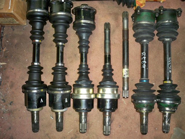

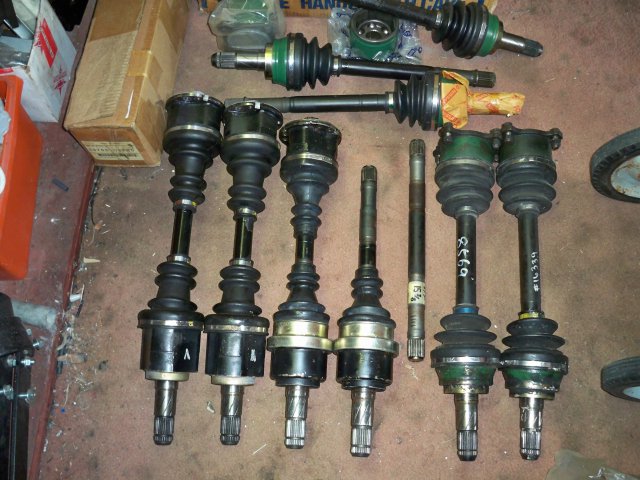

Would a single center bar only, from a 280zxt @ 15 3/8" help you out? I'm sure it's the "short" axle bar.
The center bar would be fantastic!!! Thanks!
After gathering up my little stack of axles, I can see how there is so much confussion and miss matching going on with these shafts. There are three different size pairs that I have alone.
The 15 3/8 bar I have (the bare one in pics) is not even the shortest.... I have two sets of the 2x3 bolt pattern shafts, and one set of 4 bolt shafts from a R31 skyline.

Thank you, thank you, thank you.
It looks like the bottom row, 4th from the left, half assembled axle is the one I need. The right side axle I have is like the first one one the bottom row. You can see that there is at least a 1" difference in the center section lengths.
Remember... The right side axle is the one with the longer differential stub.
