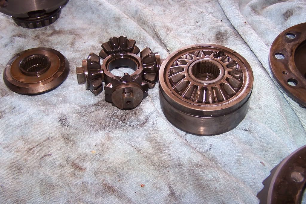

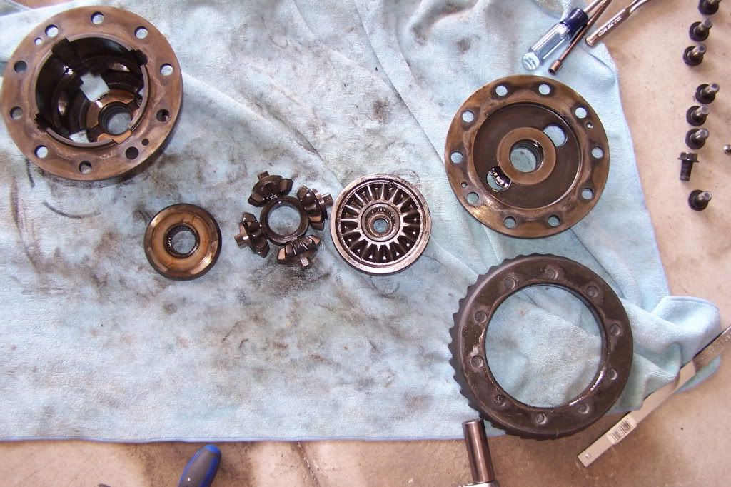

jacob80 Posted April 12, 2010 Share Posted April 12, 2010 Where are my clutches and spacers? I'm trying to install them right now but I cannot seem to figure this out. Help! Quote Link to comment Share on other sites More sharing options...
hoov100 Posted April 12, 2010 Share Posted April 12, 2010 (edited) Call me stupid, but that looks like a regular 'ole 4 pinion open diff. Edited April 13, 2010 by hoov100 Quote Link to comment Share on other sites More sharing options...

Sparks280zt Posted April 12, 2010 Share Posted April 12, 2010 I bought it from dsommer right here on the forum. The casing says R200 and it even came with the finned cover. Let not assume its the cover that came with the LSD. Oh man this really grinds my gears...UGH. What year r200? Quote Link to comment Share on other sites More sharing options...
johnc Posted April 12, 2010 Share Posted April 12, 2010 Here are the parts generally needed for Nissan clutch pack LSD. If what you have is a CLSD, it appears you're missing two pressure rings, the friction discs, the friction plates, and the spring discs. Quote Link to comment Share on other sites More sharing options...

jacob80 Posted April 12, 2010 Author Share Posted April 12, 2010 Here are the parts generally needed for Nissan clutch pack LSD. If what you have is a CLSD, it appears you're missing two pressure rings, the friction discs, the friction plates, and the spring discs. So to sum it up, this isn't an LSD?.... Quote Link to comment Share on other sites More sharing options...
johnc Posted April 12, 2010 Share Posted April 12, 2010 FYI... my post above related to the Nissan Competition CLSDs. Quote Link to comment Share on other sites More sharing options...
hoov100 Posted April 12, 2010 Share Posted April 12, 2010 (edited) After looking through a couple pics, it appears to be a VLSD. From xenonz31 http://www.xenonz31.com/vlsdInstall.html Edited April 12, 2010 by hoov100 Quote Link to comment Share on other sites More sharing options...
JMortensen Posted April 12, 2010 Share Posted April 12, 2010 I believe that is a VLSD. We used to have pictures of them taken apart in the gallery, seem to have lost them in the switch to the new software. Thick part on the side gear is the viscous coupling if I'm not mistaken. I haven't been into one myself, but try to pay attention and I'm fairly sure that's what you've got there. So long as you have the CV's to fit it (they're different), you should be good to go. Quote Link to comment Share on other sites More sharing options...

johnc Posted April 12, 2010 Share Posted April 12, 2010 And looking at your pics some more I'm thinking you have the Viscous LSD. EDIT: Hoov & Jon beat me to it. Quote Link to comment Share on other sites More sharing options...

niceguy678us Posted April 12, 2010 Share Posted April 12, 2010 I can tell you with 100% certainty that what you have is the Vlsd. I have a brand new in the box VLSD assembly , this is how I know. If you have the right shafts, everything will be fine with the MM adaptors. Just follow the directions about flipping the pieces on the discussion here on hybridZ or on Ross's MM sight. P.S.-----Check all your bearings in the diff while you have everything apart. Quote Link to comment Share on other sites More sharing options...
JMortensen Posted April 12, 2010 Share Posted April 12, 2010 in a few weeks i will be selling a CLSD that has already been rebuilt with the new clutches, in case you want the clutch style, from what i read the style you got there is weaker then the clutch style. Weaker in terms of lockup, but stronger in terms of how much power you can put through it. At least, anecdotally. Quote Link to comment Share on other sites More sharing options...
