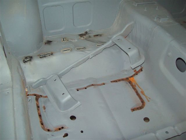

Guest fafafooey Posted April 12, 2010 Share Posted April 12, 2010 What order should I weld the new floors in my 240? I have the Zedd Finding's floors/supports. Do the floors go in and then the support or the opposite? BTW, I wish these had a piece for the front of the floors. Mine are all rusted out in that area as well. I'm going to have to fab up a 10in piece to weld on top of it. Quote Link to comment Share on other sites More sharing options...
z2go Posted April 12, 2010 Share Posted April 12, 2010 What order should I weld the new floors in my 240? I have the Zedd Finding's floors/supports. Do the floors go in and then the support or the opposite? BTW, I wish these had a piece for the front of the floors. Mine are all rusted out in that area as well. I'm going to have to fab up a 10in piece to weld on top of it. You have to have the floors in first in order to have something to weld the supports to. It's a pain, because they won't fit perfectly, and you will have to do some hammering and have to be careful not to warp them when welding. You have the choice of cutting out the seat rails, and going in from the top, or leaving the seat rails and coming up from the bottom, too. I recommend doing a search on the subject both here and Zcar.com, there are a few threads dedicated to the subject. Quote Link to comment Share on other sites More sharing options...

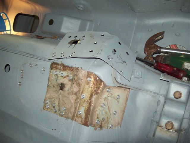

Boy from Oz Posted April 13, 2010 Share Posted April 13, 2010 (edited) I left the seat front mounts in place for rigidity but removed the rears. I hindsight I probably should have left them as well. You do have to remove the bracing/strengthening plate located under the inner rear seat mount. I also had to slightly modify the seat front support to match the profile of the new floors. (edit) I can't recall exactly but I think the spot welds securing the rear of the floor also secure the seat rear mount, so perhaps there is no option other than to remove that mount. Edited April 13, 2010 by Boy from Oz Quote Link to comment Share on other sites More sharing options...
z2go Posted April 18, 2010 Share Posted April 18, 2010 Oz, you are right about removing the rear bracket IF you need to repair all the way back. I didn't think about that... my car only had rust from right before the rear seat mounts up to the front, so I was able to keep both in. Quote Link to comment Share on other sites More sharing options...

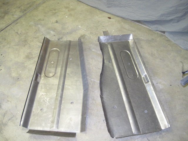

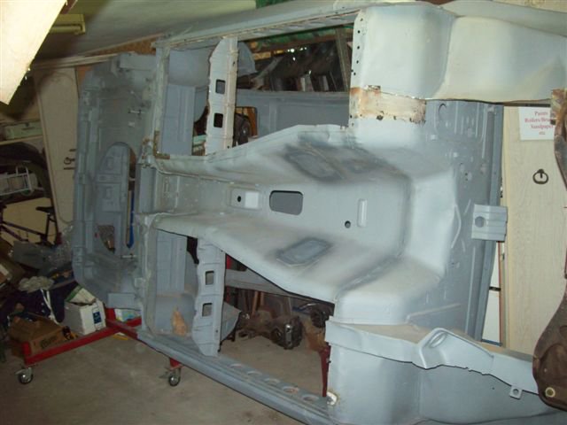

jacob80 Posted April 20, 2010 Share Posted April 20, 2010 I just had the floors in my car replaced by a body shop in Omaha, Nebraska. I will tell you right now that the Zedd Findings floor pans do have a fitment issue regarding the side that comes up to the rocker. The angle of the original floors is not as extreme as the angle of the Zedd Findings floors. It works, it just won't be where the originals were. This is something that should be addressed when they are stamped, but they are not. Another thing is that the drain holes are not identical to the original floors, not that it matters much but I assumed these were replicas. Also, I ended up buying all new seat brackets from John at Bad Dog Parts. These pieces are of much heavier gauge, but he does not include the bracket that runs between the two rears, which doesn't necessarily present a problem as far as I'm concerned. I, too needed the extra meet up front under the pedals as my area up there was damaged, but for whatever reason, he didn't extend it all the way up there. This is the photo that shows how much higher this side comes up on the rocker panel vs. the stock location: Patch that had to be custom made: I have more photos if you need something specific. Quote Link to comment Share on other sites More sharing options...

Guest fafafooey Posted May 5, 2010 Share Posted May 5, 2010 Those picture just saved me a night of yelling "MF" at the top of my lungs. I just got done screwing around with it and when I lined the rocker edge up, the pan sat below the support. Good thing I came inside and checked it out. These definitely have fitment issues. Not only is the angle off on the rocker, the transmission tunnel is curved and the pan is angled and straight. They're the only thing out there so I guess we have to live with it. Back to hammering and yelling....I now see why beer and working on cars go together. Quote Link to comment Share on other sites More sharing options...

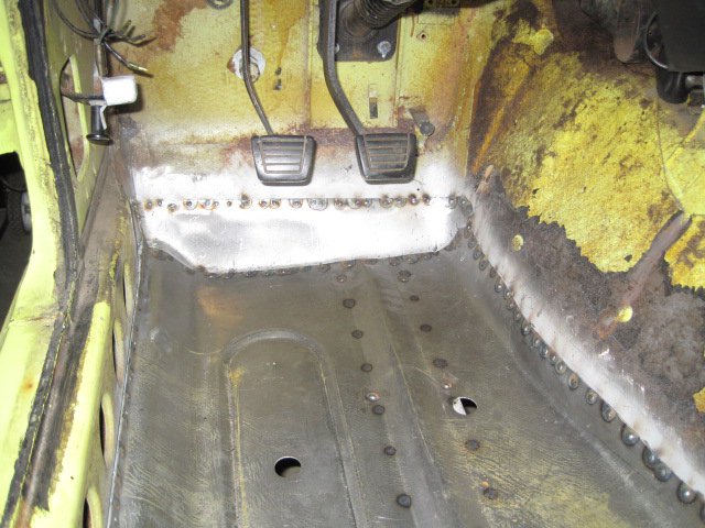

Guest fafafooey Posted May 5, 2010 Share Posted May 5, 2010 There's no problem a bigger hammer can't solve. I got the rocker panel side screwed down and it looks much better than before. Of course as I get motivated to get the rest of it screwed in a T storm moved in. Once this is done, the passenger's side looks much easier since it's only rusted out in the center. The drivers side was real nasty so I'll be making a bunch of extra patch panels. Thanks for the help! Also, any extra pictures wouldn't hurt....maybe some of the underside by the front of the brace? Quote Link to comment Share on other sites More sharing options...

Guest fafafooey Posted May 9, 2010 Share Posted May 9, 2010 I got half of it welded in before my gas ran out. Going really good so far. The biggest issue I had was some of the spot welds were over the "valley" in the rocker. I filled them as normal, but also ran a bead along the entire top of it to make sure it's not going anywhere. Once this is in, I'm going to have to fab up an extension for the support. I had to cut away about 2 inches more than normal due to rust. Other than that, everything looks to be pretty straight forward. I'll start taking pictures tomorrow. Quote Link to comment Share on other sites More sharing options...

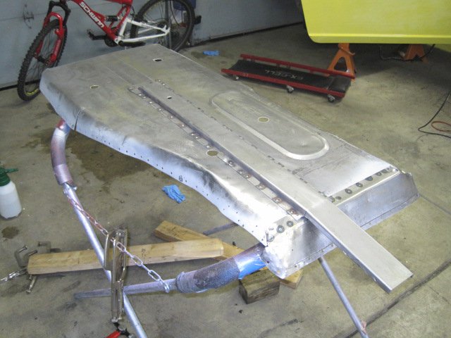

madkaw Posted May 10, 2010 Share Posted May 10, 2010 I started a thread just on this issue of Zeds Findings Floors. I even e-mailed Charlie. The floors are made to deep up front and thus don't line up with the frame rail. So your choices are tacking it higher on the rocker or leaving it alone and not having a perfect level floor. It's a shame because it would be nice to use the outer flange of the floor as your starting point, but it isn't made properly. It is doable, but a lot of work for not so cheap panels. My solution of a not perfect floor should be masked by the carpet and is hardly noticable from the outside. Quote Link to comment Share on other sites More sharing options...
