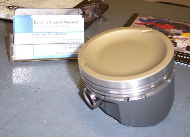

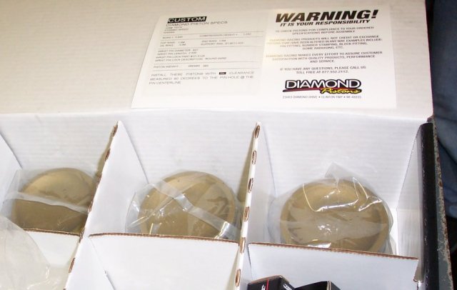

TimZ Posted May 11, 2010 Share Posted May 11, 2010 Sorry I just noticed this post - I'm quite happy with the Diamond pistons that I'm currently using... I had them ceramic coated and did the piston skirt coatings too. Quote Link to comment Share on other sites More sharing options...
2eighTZ4me Posted May 12, 2010 Author Share Posted May 12, 2010 Hey TimZ - where did you get those pistons? You say Diamond makes them? Any contact info? Also - where did you get the coating done? Looks jam up man! Thanks! Quote Link to comment Share on other sites More sharing options...

TimZ Posted May 13, 2010 Share Posted May 13, 2010 Sorry I just noticed this post - I'm quite happy with the Diamond pistons that I'm currently using... I had them ceramic coated and did the piston skirt coatings too. The pistons were custom made from Diamond: http://www.diamondracing.net/home.asp The coatings were done by Dart: http://www.dartheads.com/products/dart-coatings/dci-mos-teflon-skirt-coating.html http://www.dartheads.com/products/dart-coatings/dc2-high-temperature-reflective-heat-barrier-coating.html ...they did my combustion chambers, exhaust ports and valves too, btw. Quote Link to comment Share on other sites More sharing options...
