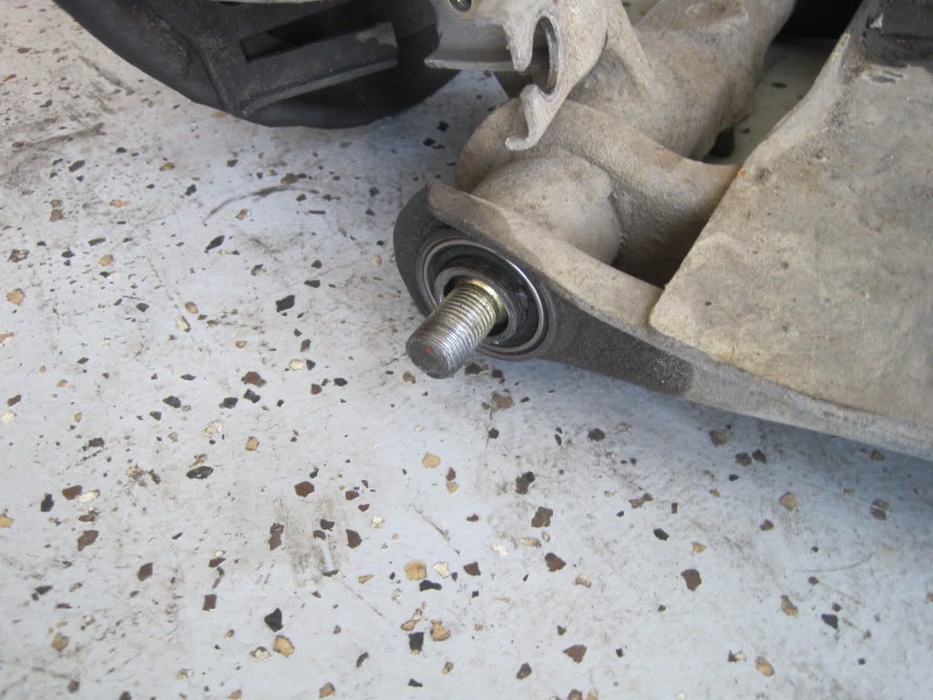

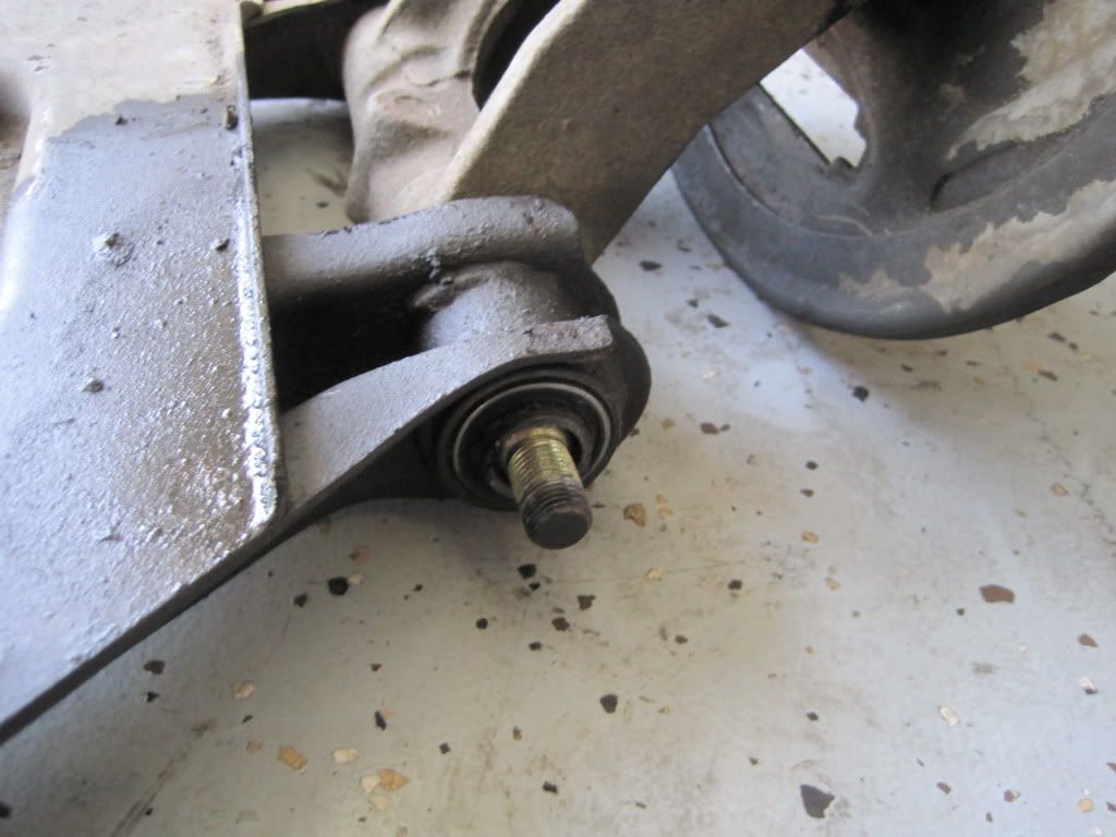

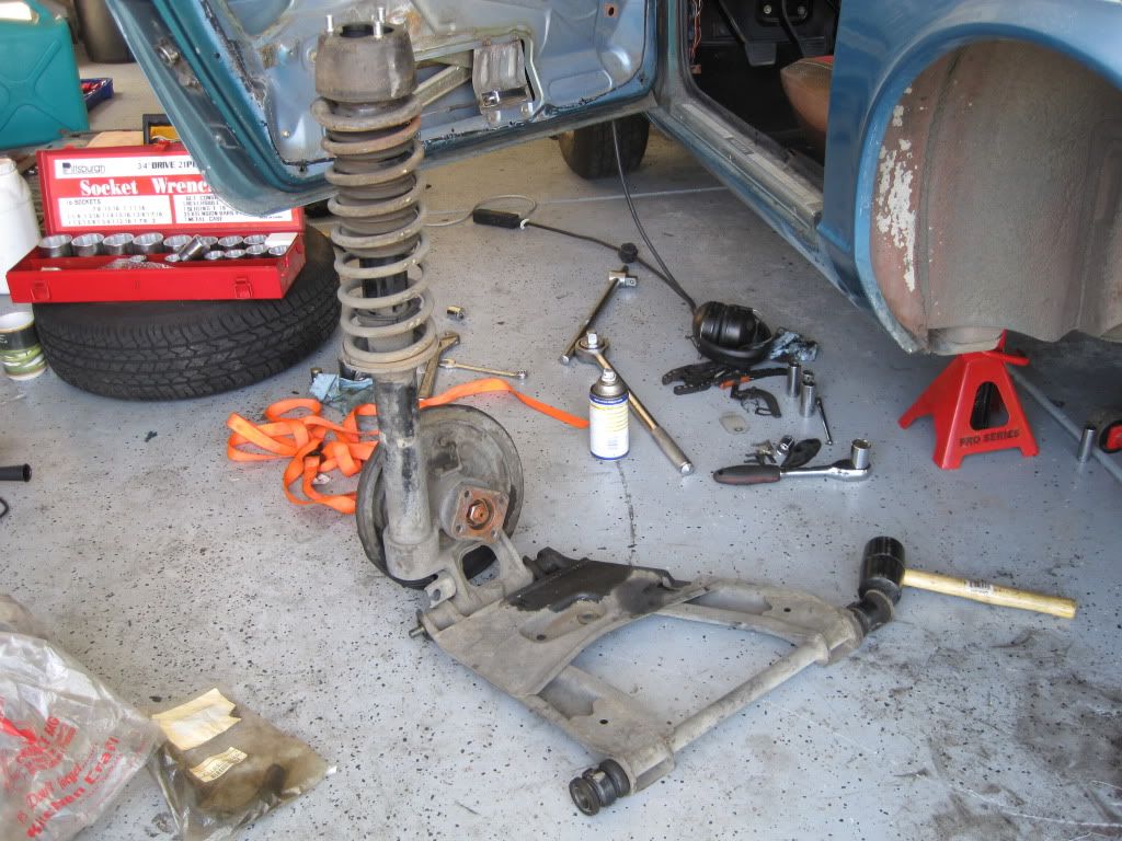

brianhen Posted October 20, 2010 Share Posted October 20, 2010 stupid computers!! There is a bolt in the centre of the control arm you can see it in the last picture. My factory service manual says thismhas to be removed first......hope it helps Quote Link to comment Share on other sites More sharing options...
