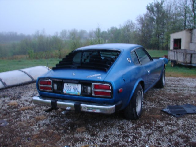

19762802+2 Posted May 19, 2010 Share Posted May 19, 2010 The PO of one of my 2+2's had the dealer option tow bar hooked up, I wish I had kept it and sold it to someone on here, I may have pictures of it but idk. Anyways he pulled stuff with the stock engine and Auto trans, I checked the fluid in it at one point and it was just fine. I'm not sure what he pulled but it held up well. The dealer option tow bar bolted in near the bumper brackets and also into the rear bumper I believe. I will search for some pictures. Quote Link to comment Share on other sites More sharing options...
kamikaZeS30 Posted May 19, 2010 Author Share Posted May 19, 2010 johnc yeah, I thought about the brakes right after I finished the post. I'm using the Toyota four-pistons in the front, with the larger ZX master-cylinder and I have the ZX rotors with Maxima calipers in the back. I'm looking at upgrading to the Wilwood kit in the future. Thanks for the info, it doesn't sound like it'd cost that much to do. It should work for something like a pop-up. I'm not looking for something like a 26' airstream. I'm just looking for a small camper to fit two adults for weekend trips and such. Dealer option hitch? That might be another way to go. I'm wondering which S30 bodies that would fit. I forgot to mention the car is a series one, '71 s30. It doesn't have some of the neat things like reinforced bumper mounts that the 74+ had. Quote Link to comment Share on other sites More sharing options...
19762802+2 Posted May 19, 2010 Share Posted May 19, 2010 (edited) [quote name='kamikaZeS30' date='19 May 2010 - 05:25 PM' timestamp='1274311541' post='869576' Dealer option hitch? That might be another way to go. I'm wondering which S30 bodies that would fit. I forgot to mention the car is a series one, '71 s30. It doesn't have some of the neat things like reinforced bumper mounts that the 74+ had. Yeah it was either a Dealer option or some aftermarket thing because it definitely didn't look home made. It was on my 280z, There are two bolt holes next to each rear bumper bracket and one two almost 90 degree bends bolted on to that. A long flat bar was bolted to those two 90 degree bends and then bolted to the bottom of the Rear bumper. This picture is the only one I ever took of the hitch on the rear bumper when I first bought the car. You can't really see it because it was all tucked underneath pretty nicely. Edited May 19, 2010 by 19752802+2 Quote Link to comment Share on other sites More sharing options...

19762802+2 Posted May 29, 2010 Share Posted May 29, 2010 You should take pictures of the factory or dealer option tow bar for everyone to see. I wish I had when I had one, I just didn't know they weren't very common. Quote Link to comment Share on other sites More sharing options...
kamikaZeS30 Posted May 29, 2010 Author Share Posted May 29, 2010 I'll see what I can do, I don't even have any good pictures of my car right for lack of a digital camera. The best way to explain it is that it's one long bar like a spine and then it's got two bars welded to it which are arranged perpendicularly. These bars appear to be used for mounting, the long, "spinal" bar looks like it is inclined so as to stick up, but clear the rear bumper. And it looks like I'm supposed to just screw in a two-inch ball at the end of that bar. It's a super simple design, I'm still perplexed as to WHERE it mounts, exactly, but I won't even have my 240 back for another month to find out, anyway. Quote Link to comment Share on other sites More sharing options...
19762802+2 Posted May 29, 2010 Share Posted May 29, 2010 On 5/29/2010 at 4:00 PM, kamikaZeS30 said: I'll see what I can do, I don't even have any good pictures of my car right for lack of a digital camera. The best way to explain it is that it's one long bar like a spine and then it's got two bars welded to it which are arranged perpendicularly. These bars appear to be used for mounting, the long, "spinal" bar looks like it is inclined so as to stick up, but clear the rear bumper. And it looks like I'm supposed to just screw in a two-inch ball at the end of that bar. It's a super simple design, I'm still perplexed as to WHERE it mounts, exactly, but I won't even have my 240 back for another month to find out, anyway. Oh I know what it looks like, on the 280z i'm not sure about the 240z, near the bumper brackets are two indentions in the rear panel that have two openings for bolts. These are attached directly to the "frame". In that picture its the two bolts directly under the tail panels. Quote Link to comment Share on other sites More sharing options...
kamikaZeS30 Posted May 29, 2010 Author Share Posted May 29, 2010 Ah, yeah, should be the same, I recognize those holes. Quote Link to comment Share on other sites More sharing options...
