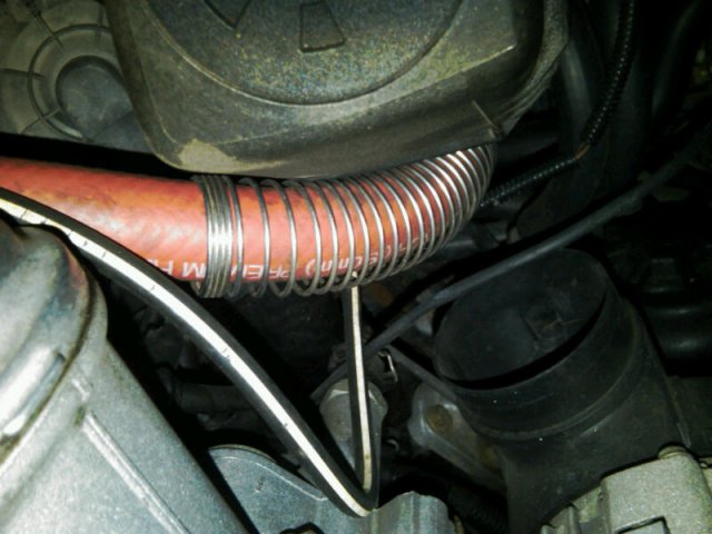

two40zjunky Posted June 16, 2010 Share Posted June 16, 2010 Dude go to Kragen Auto and ask the guy behind the counter for the hose coil that keeps hose from kinking. I was going nuts trying to make this weird angle work in the engine compartment of my E36 M3 until I found this little money saver. It cost like $5.00 Quote Link to comment Share on other sites More sharing options...

Pharaohabq Posted June 17, 2010 Share Posted June 17, 2010 Dude go to Kragen Auto and ask the guy behind the counter for the hose coil that keeps hose from kinking. I was going nuts trying to make this weird angle work in the engine compartment of my E36 M3 until I found this little money saver. It cost like $5.00 Yeah this was going to be my suggestion, but two40zJunky beat me to it. Phar Quote Link to comment Share on other sites More sharing options...
