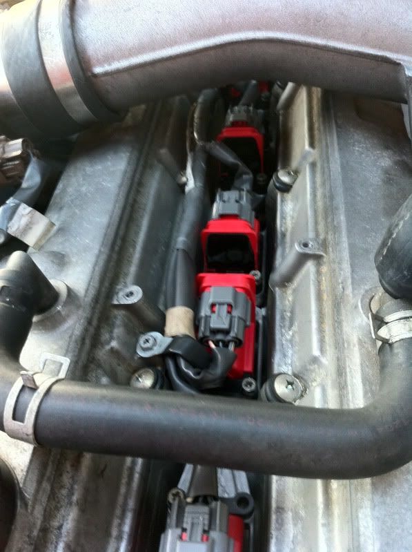

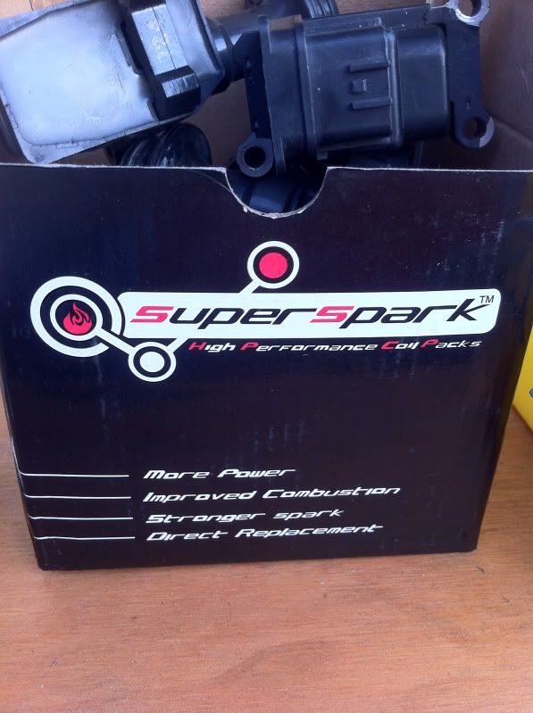

Well I installed some new Super Spark coil packs from RAW Brokerage. They have the RB running a hell of a lot better! The difference is very noticeable everywhere. Its idling better, running smoother, pulling stronger into boost, etc.

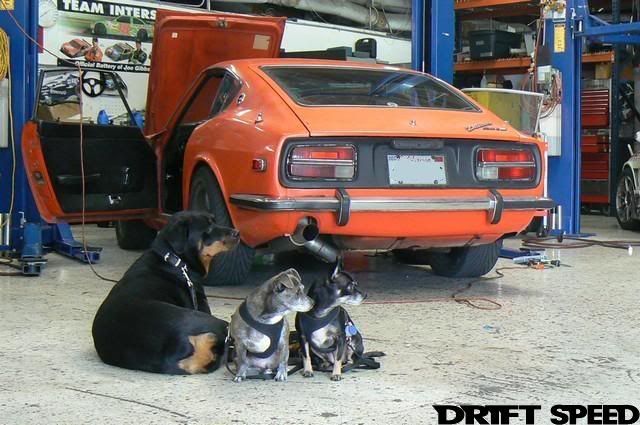

Dropped the Z off at Drift Speed yesterday, everything went well and I won't be picking it up till either Thursday or Friday next week.
Koji, the tuner, is a real cool guy that knows his stuff.
He's doing:
Cleaning up the wiring
Checking the sensors
Checking for boost leaks
Checking the o2 sensor and moving it's location to a more optimal location
Installing a wide band if need be
Adding and changing relays to more reliable genuine Nissan ones
Adding in a relay to allow the Power FC to save data
Deciding if my MAF location needs to be changed to a more optimal location
Wiring in my electric fan
Wiring in my Tachometer
Baseline dyno run
Dyno tune
Final dyno run.

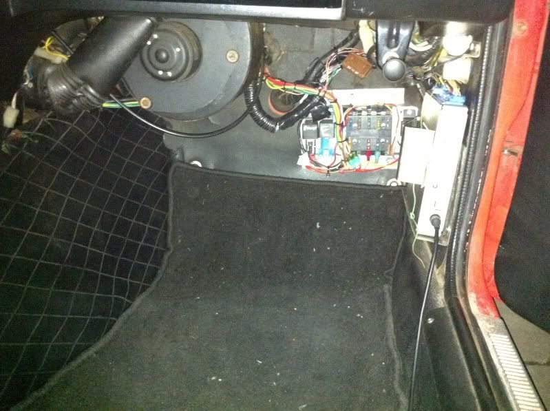

Cleaned up wiring:

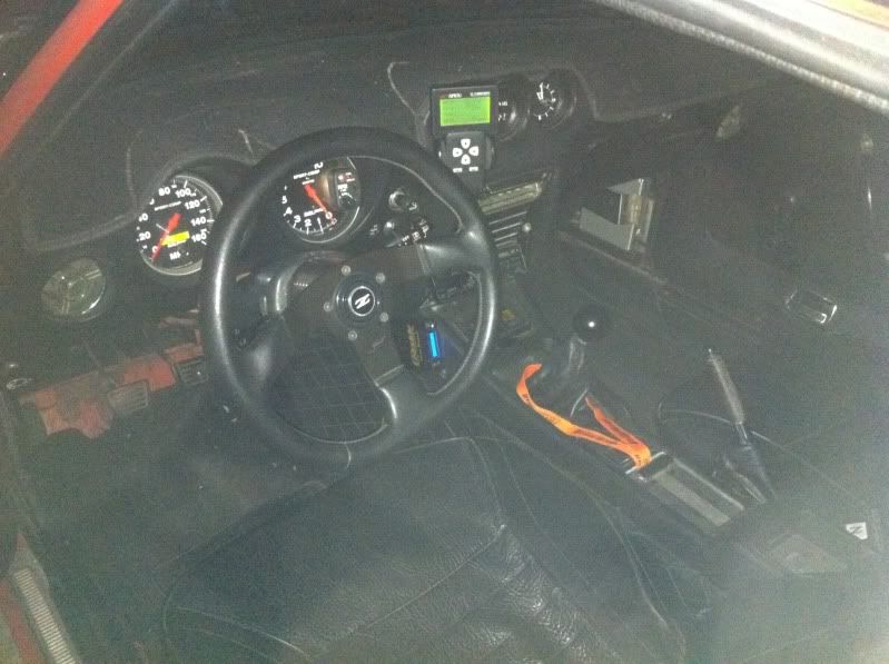

Not very good quality picture, but shows where everythings mounted. Power FC commander is mounted with an adjustable cell phone holder. The suction cup just so happens to be the same size as the water temp gauge and holds great and is in the most optimal viewing postion. I dont even need that particular gauge as the Commander displays the information (gauge also just so happens to not work anyway haha).
