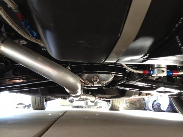

z2go Posted February 9, 2011 Author Share Posted February 9, 2011 Yet another update... after two days of working hard, and with the help of a knowledgeable friend, we built the exhaust almost to completion. It is fully custom, with just a few pre-bent angles, 2.5" to 3". I waited to order the muffler because I wasn't sure what I would be working with, but I picked it out, and it should be here soon. In case you are keeping track, I will not be using the SuperTrapp, partially because it was going to be a difficult fit, and partially because it's 2.5". I put two vibrant resonators right after the flex joint, then joined the pipes after the transmission. The Y is a creation that we came up with, it's a 2.5" pipe that is flared out to 3", where the two meet, and then 3" from there on. All welding was done with my crappy generic MIG welder. More pictures later today of the rest. Quote Link to comment Share on other sites More sharing options...

z2go Posted February 10, 2011 Author Share Posted February 10, 2011 A couple more pictures. I had the Y built, and then decided I didn't like how it joined, I wanted it to be a little more gentle, and a little bigger. So, I cut out that section outlined in pen, and cut a 3" pipe to fit over the area, to create a more gradual transition. Lastly, I put it in place. Now, all I need to do is weld it to the resonators, and fab the two 90's once the muffler gets here today. It fits perfectly between the differential and the suspension, and is tucked up nicely. From the side, you can only see the two resonators in the front. Quote Link to comment Share on other sites More sharing options...

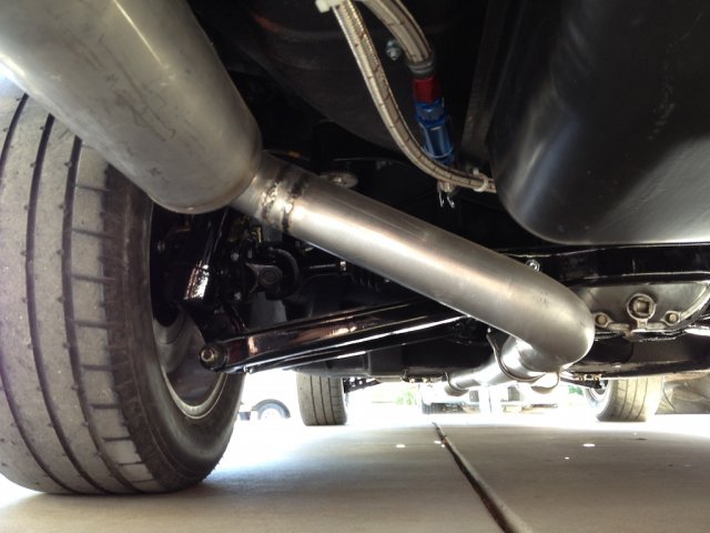

z2go Posted February 12, 2011 Author Share Posted February 12, 2011 More progress... after a few setbacks. The muffler I ordered with offset inlet and outlet did not work. Today was the last day I had to finish welding (using borrowed gas), so I tracked down a center inlet/offset outlet muffler of the same type, after an hour and a half of driving. I was able to finish the exhaust, and grind down some of the welds. I also was able to finish up the front Toyota 4x4 brake upgrade, since the Earl's braided brake lines came in today. Quote Link to comment Share on other sites More sharing options...

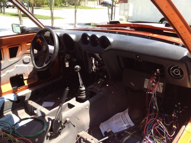

z2go Posted February 28, 2011 Author Share Posted February 28, 2011 On 2/20/2011 at 10:39 PM, 250z said: Ive been following this thread, neat little story at the beginning, everything looks great, looking forward to finished build Glad you enjoyed it! Here's another update... Finished the dash just now, textured it with this stuff made in Canada called Sure Tex instead of the SEM brand texture. It came out really nice, didn't have to do anything to it, and it created a really nice looking texture. painted it with SEM trim black, and now it is just waiting to dry and be reassembled. Quote Link to comment Share on other sites More sharing options...

rsicard Posted April 7, 2011 Share Posted April 7, 2011 On 4/7/2011 at 7:16 PM, rsicard said: Ztogo: You have done fantastic work on the 240Z. Everything is immaculate. You mentioned using something on the dash. Can you describe the process and materials used to restore the dash PLEASE. Keep up the good work and ESPECIALLY the good photos. Keep them coming. I also have a 240Z and wish to restore the dash. Also putting in a SBC engine and manual trans. Ztogo: Just noticed your writeup on the dash. Will use this extensively. THANKS! Quote Link to comment Share on other sites More sharing options...
rsicard Posted April 7, 2011 Share Posted April 7, 2011 On 4/7/2011 at 7:19 PM, rsicard said: Ztogo: Just noticed your writeup on the dash. Will use this extensively. THANKS! Ztogo: One important question. What was used for filler on the dash? Quote Link to comment Share on other sites More sharing options...
